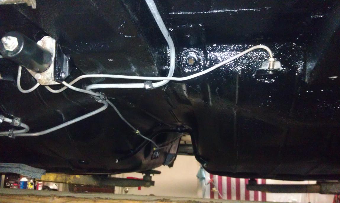

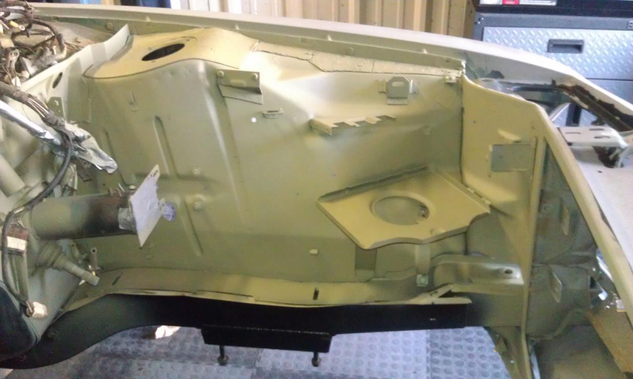

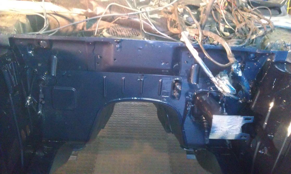

My goal was to strip the underside to the bare metal but there were places that were in perfect condition and the darn stuff is impossible to remove so I took off every bit that I could and it took many days. The parts I did manage to strip were washed and etch-primed, sealed with 3M spooge and then sprayed with the same texture coating you would use on the rocker panel covers. It got many coats and I feathered the edges of the original undercoating that I could not remove so it would match as close as possible. If you put the texture on heavy it matches the texture of the undercoating pretty close. When scraping I paid particular attention to the seams, and corners-that took forever- when everything was done I got about 4 cans of appliance paint and did the finish up.
