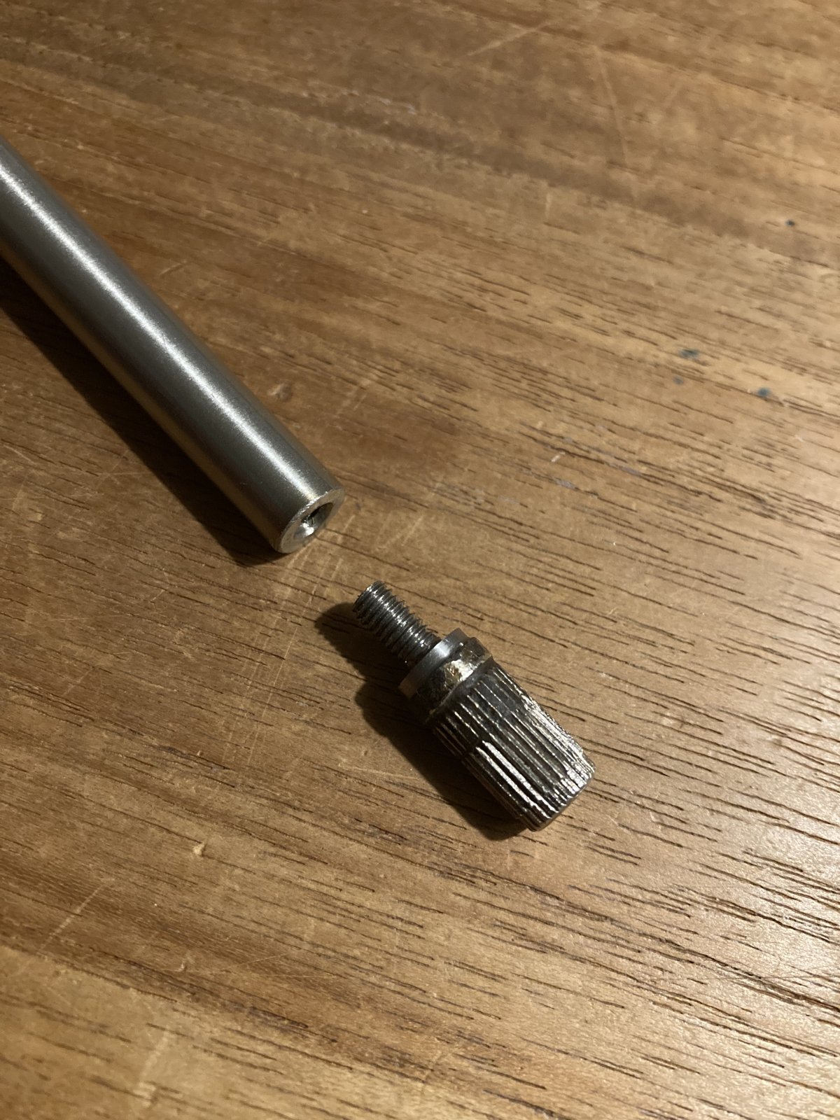

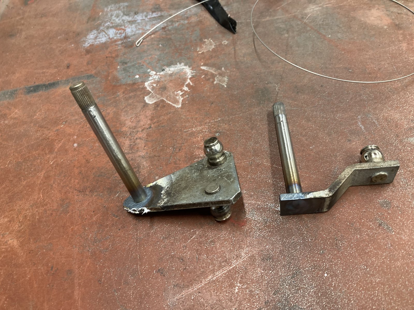

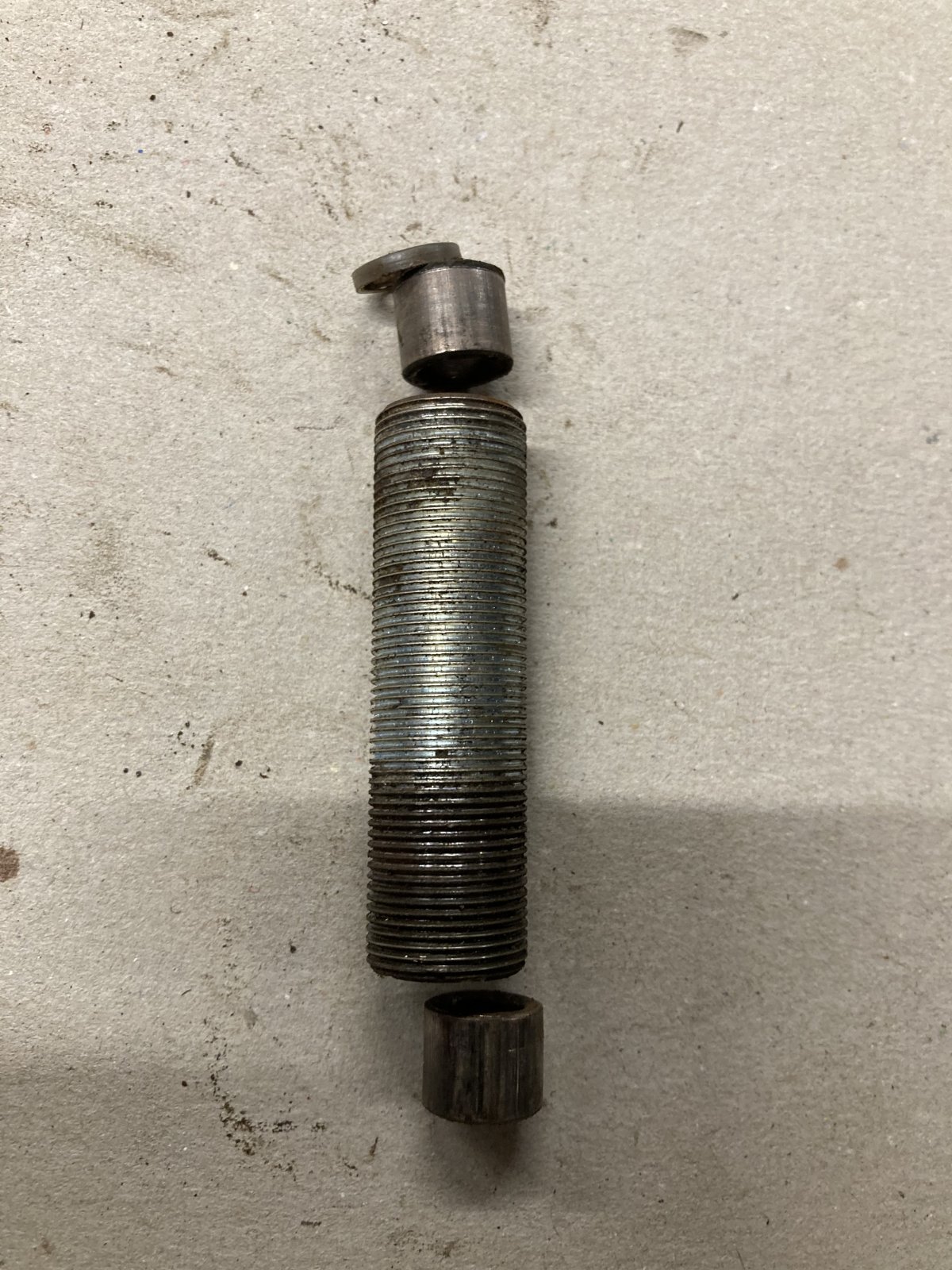

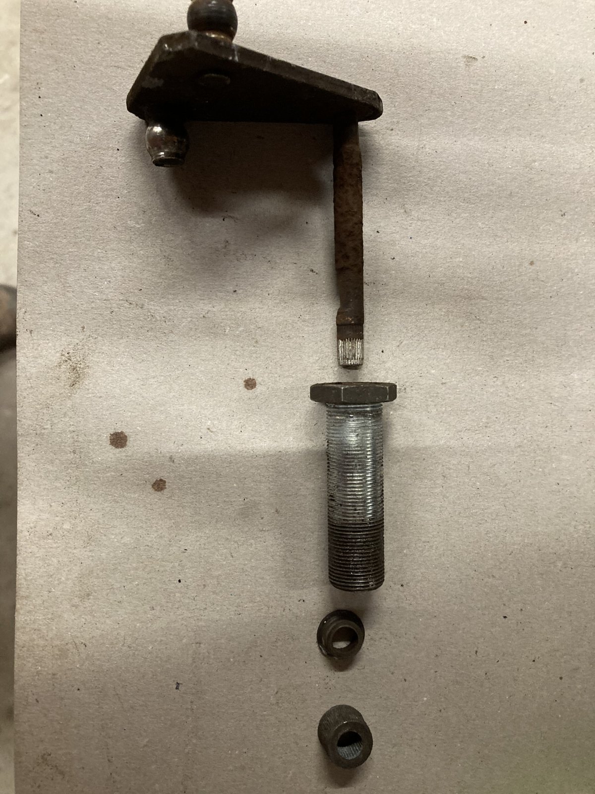

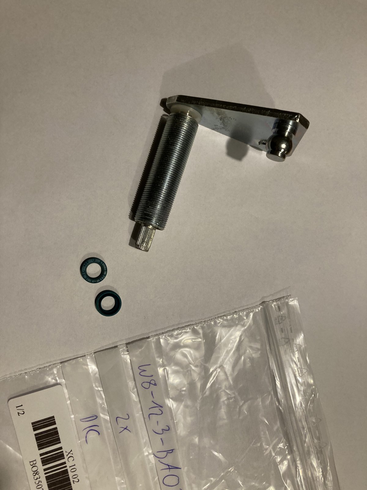

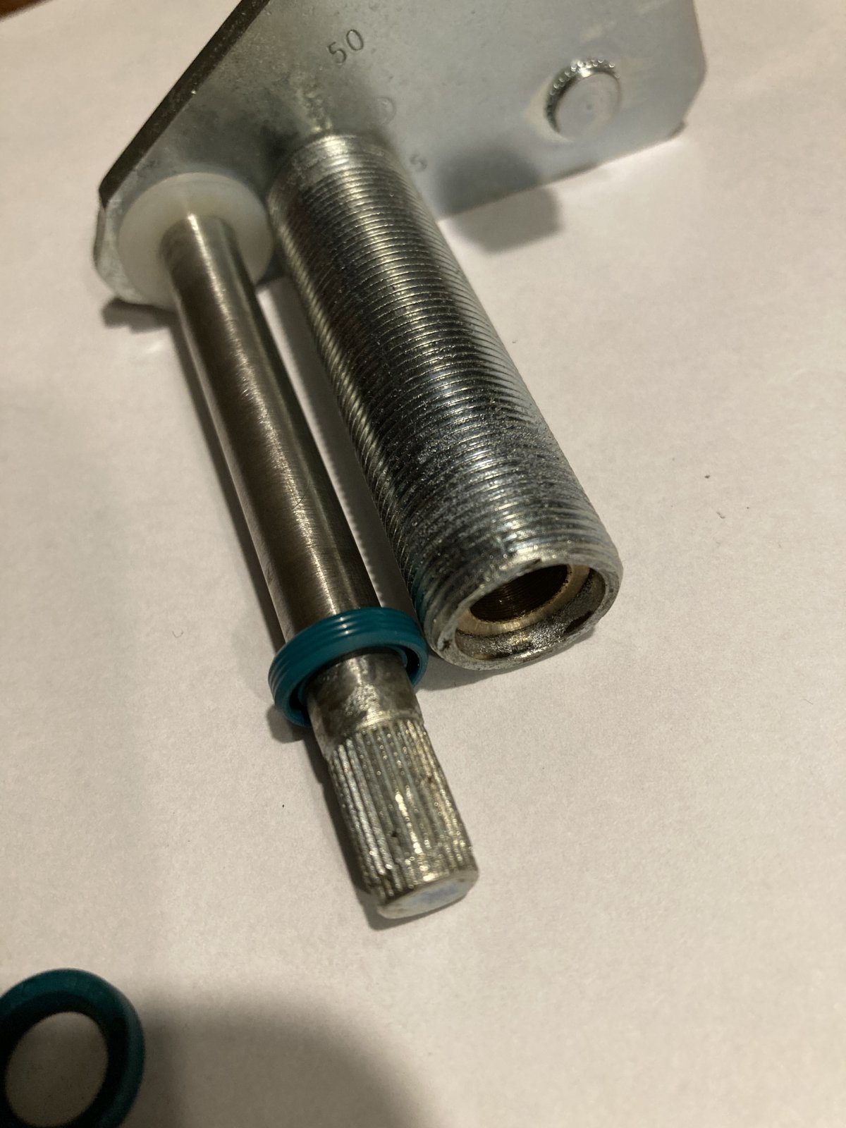

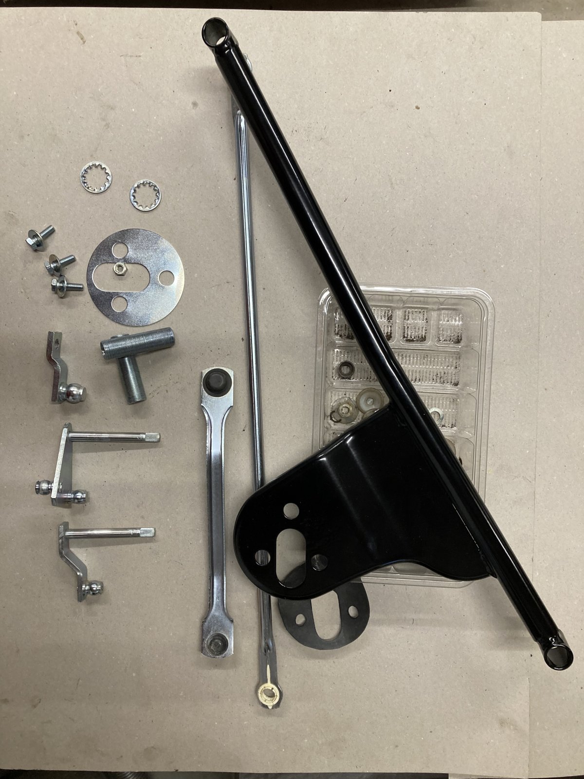

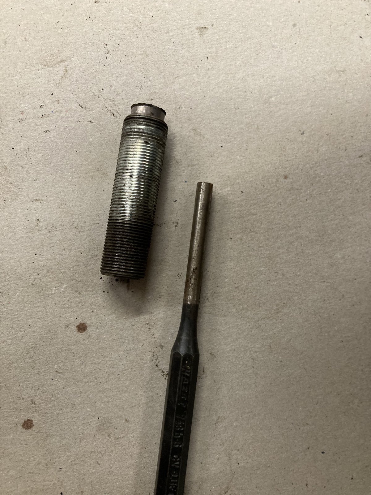

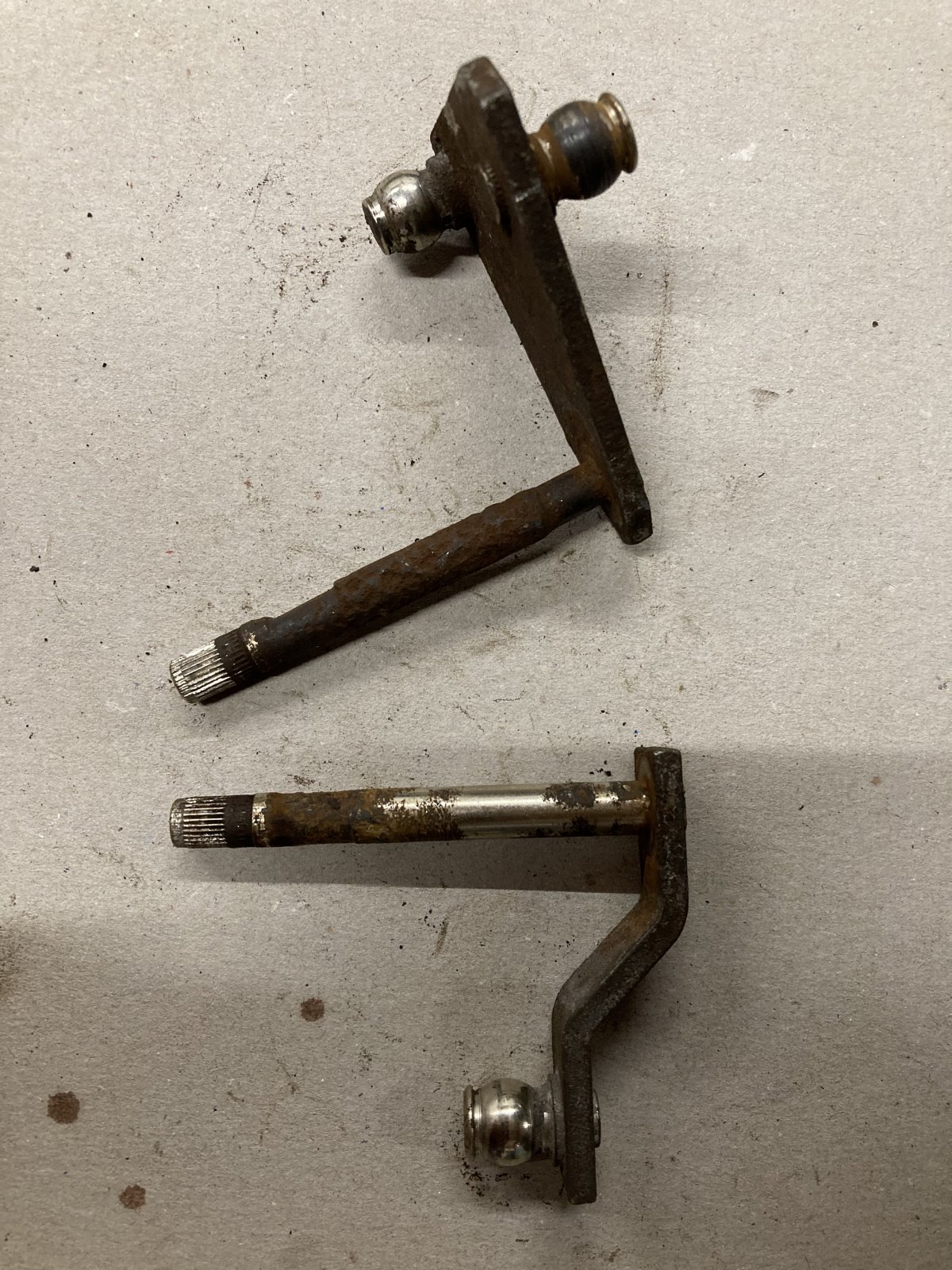

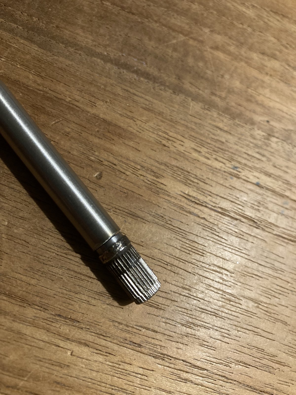

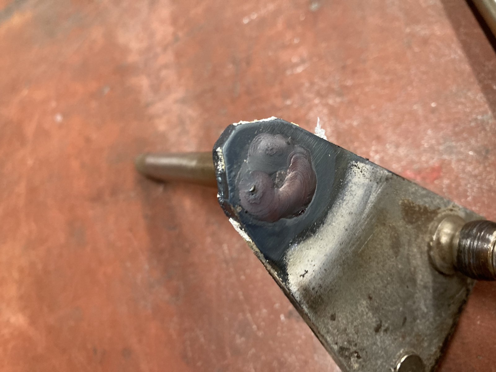

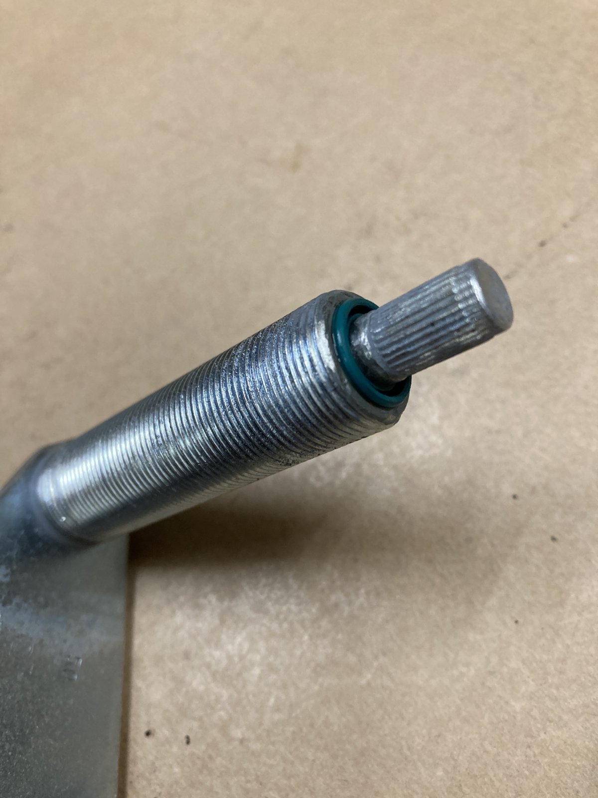

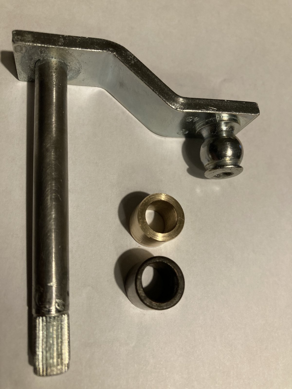

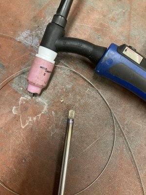

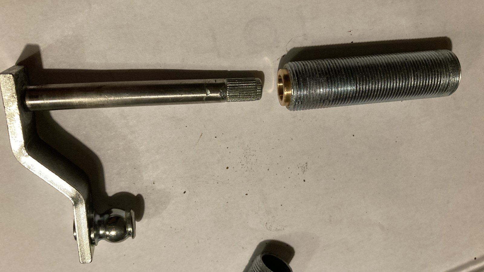

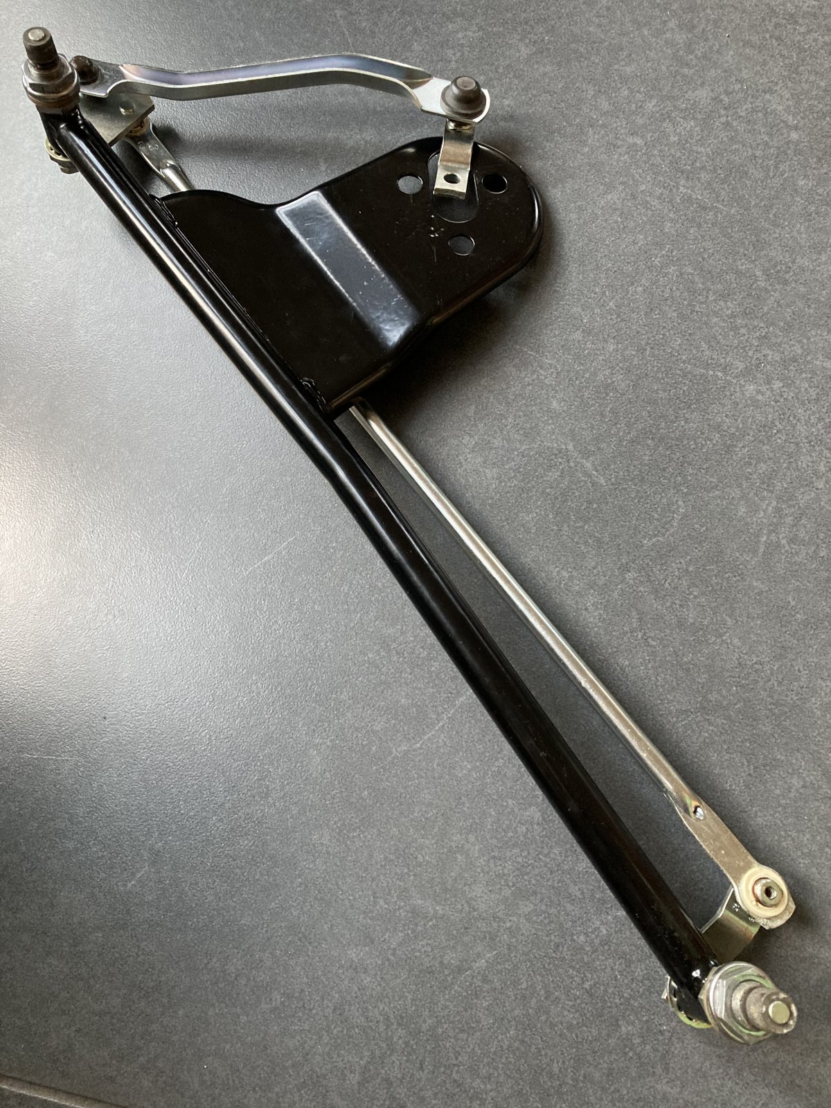

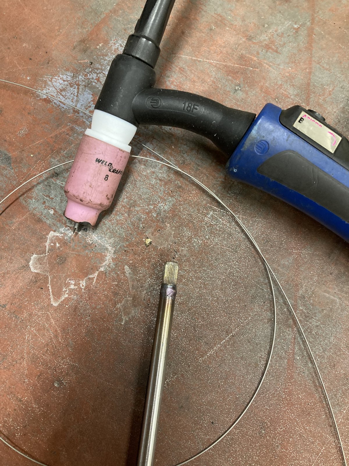

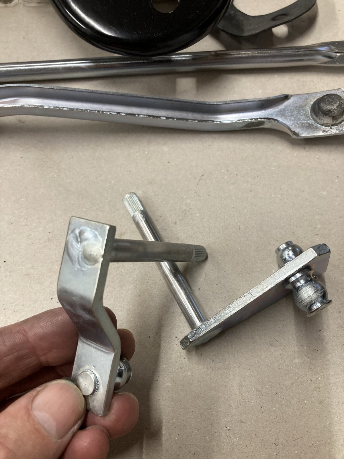

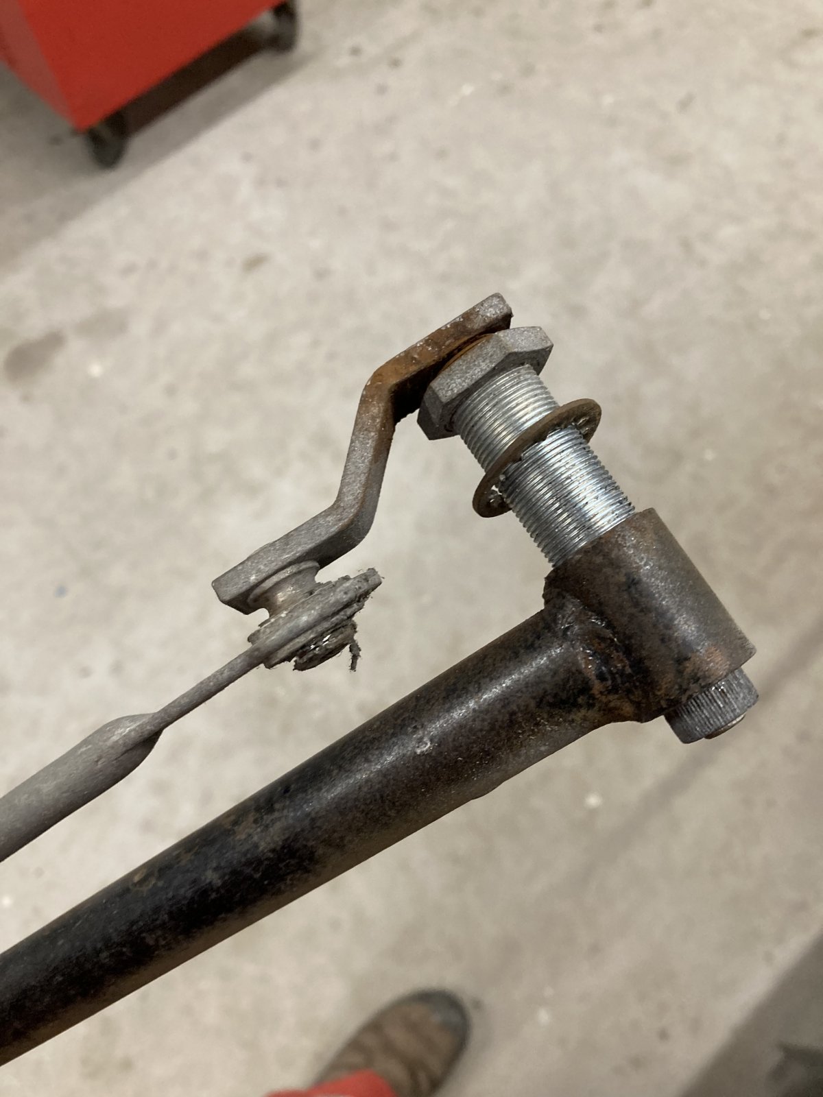

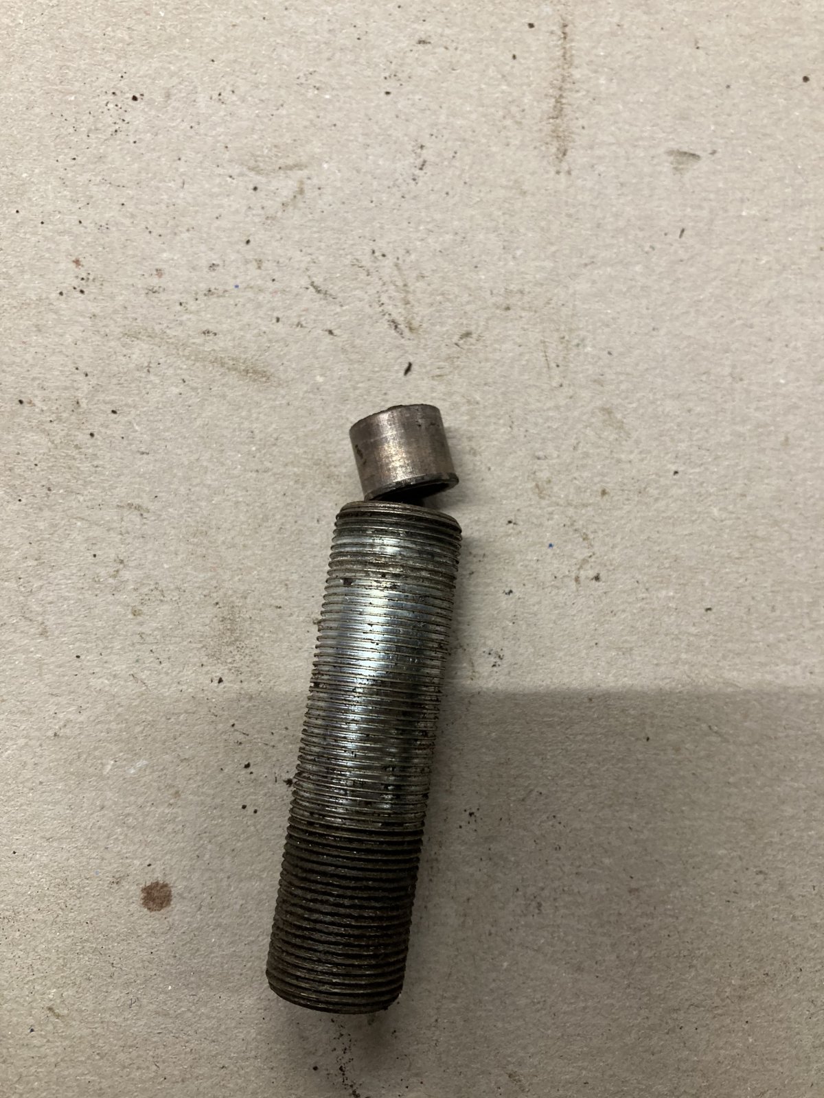

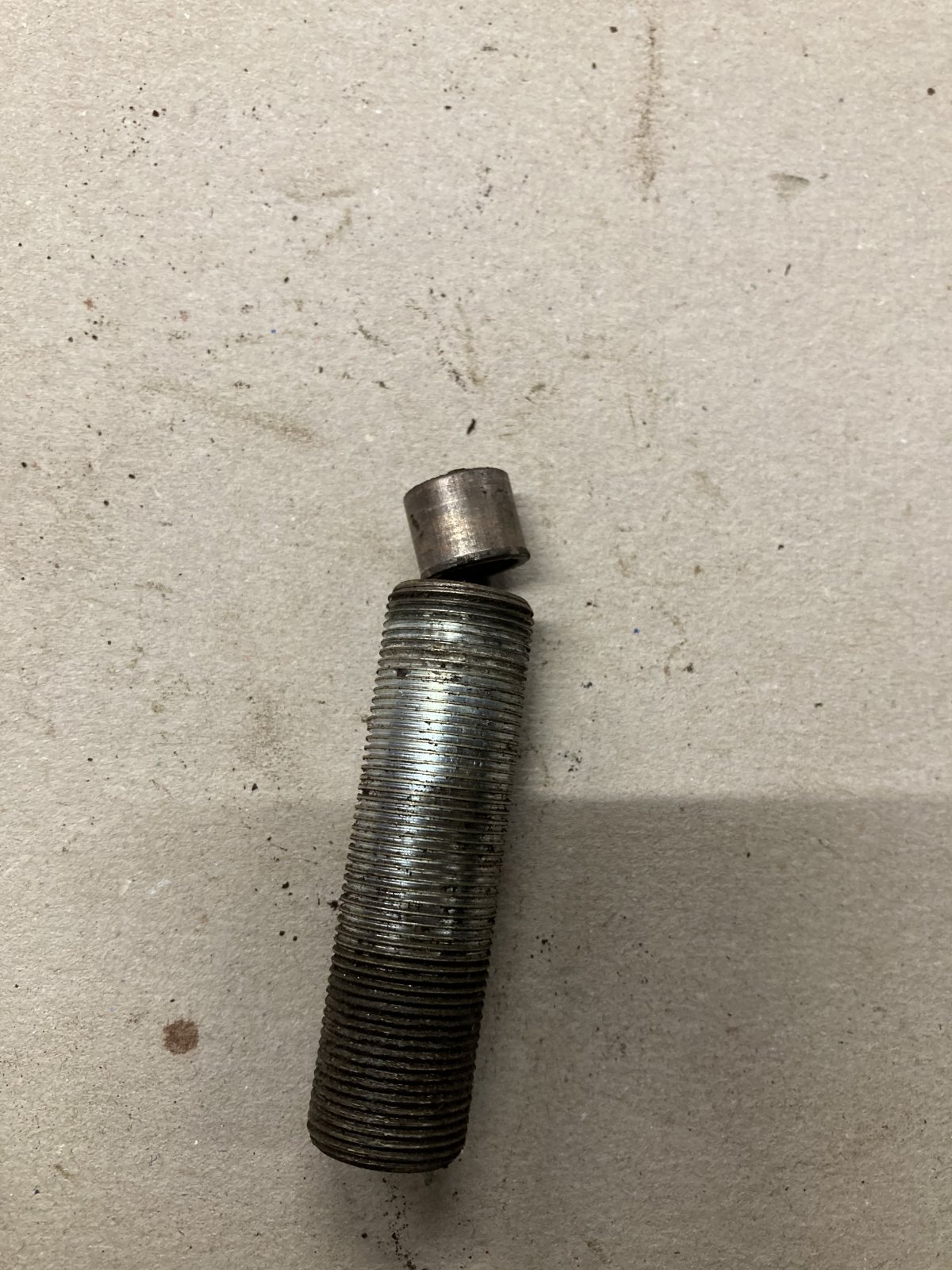

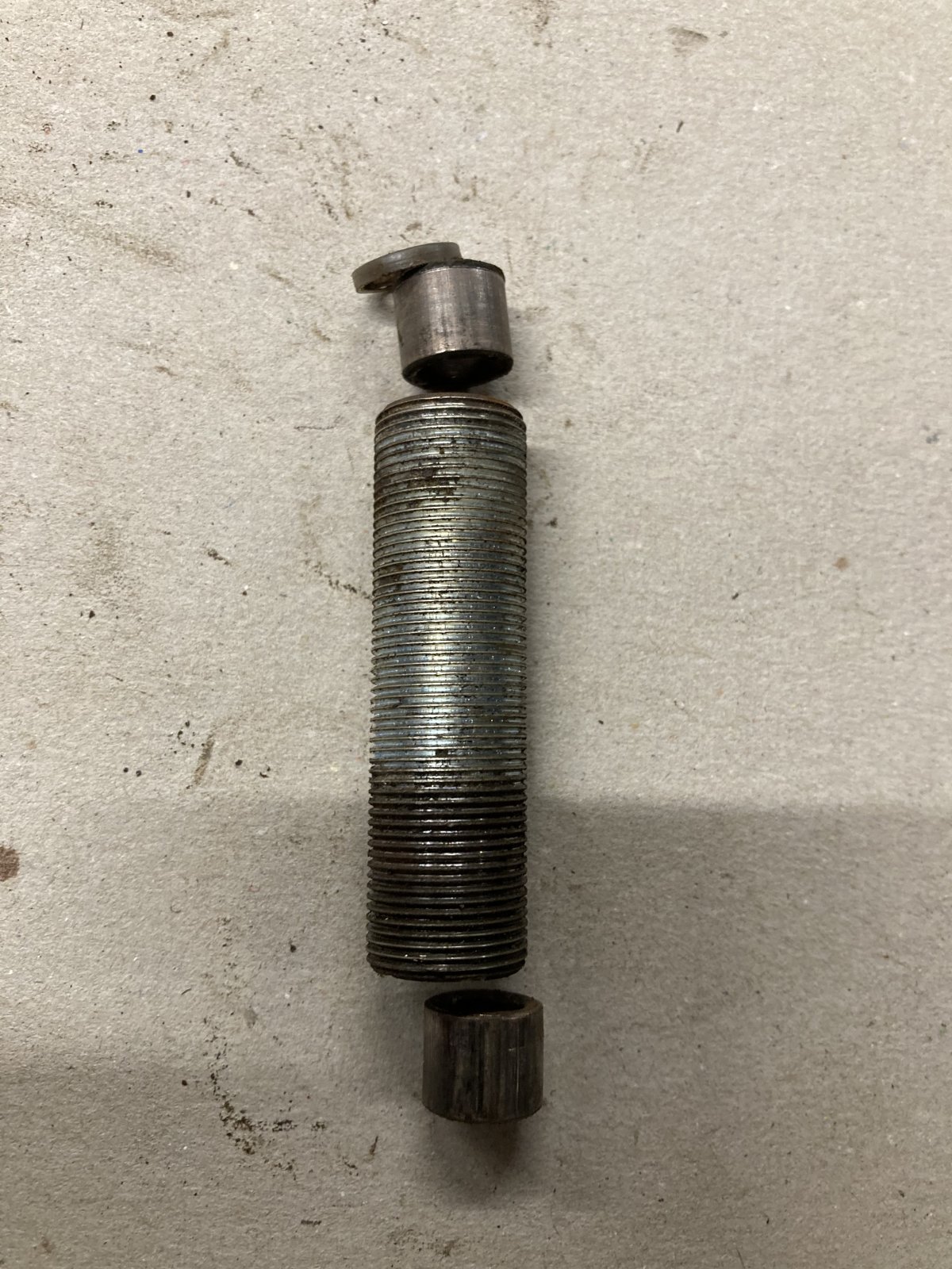

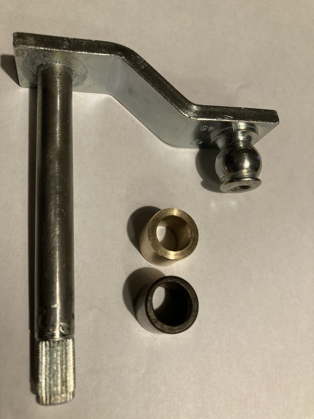

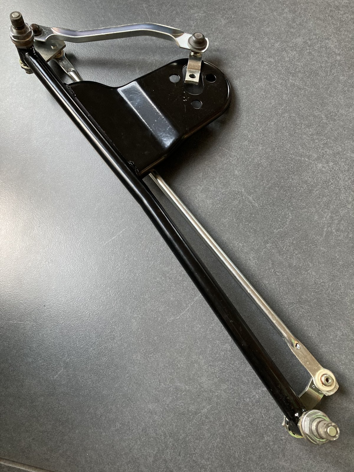

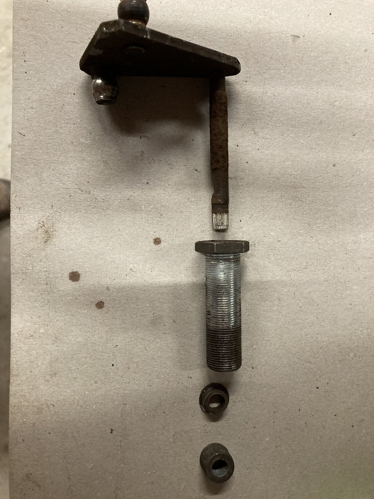

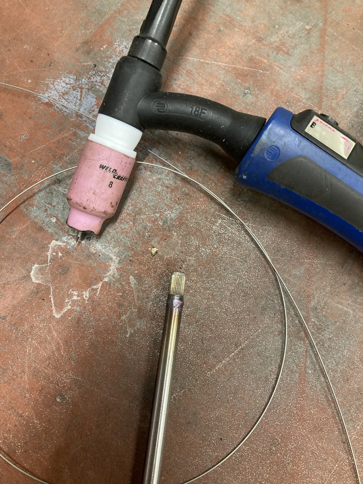

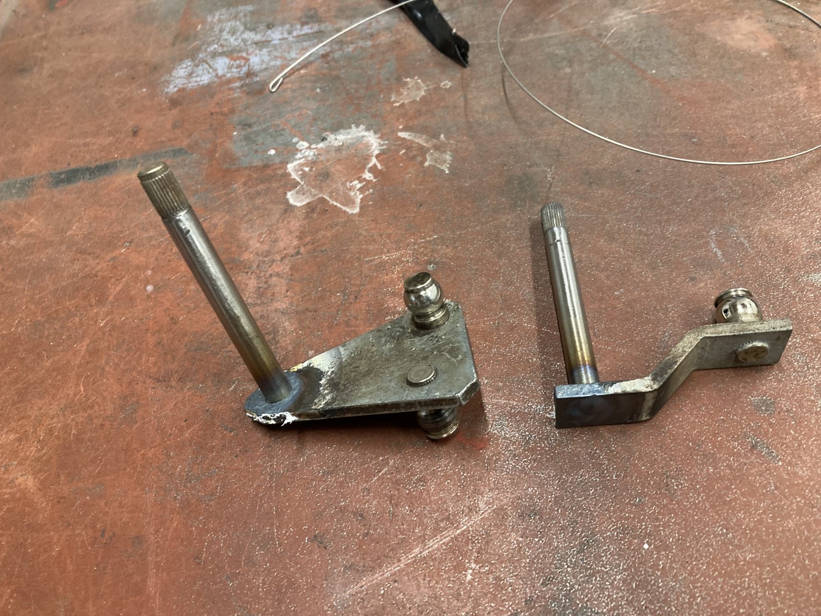

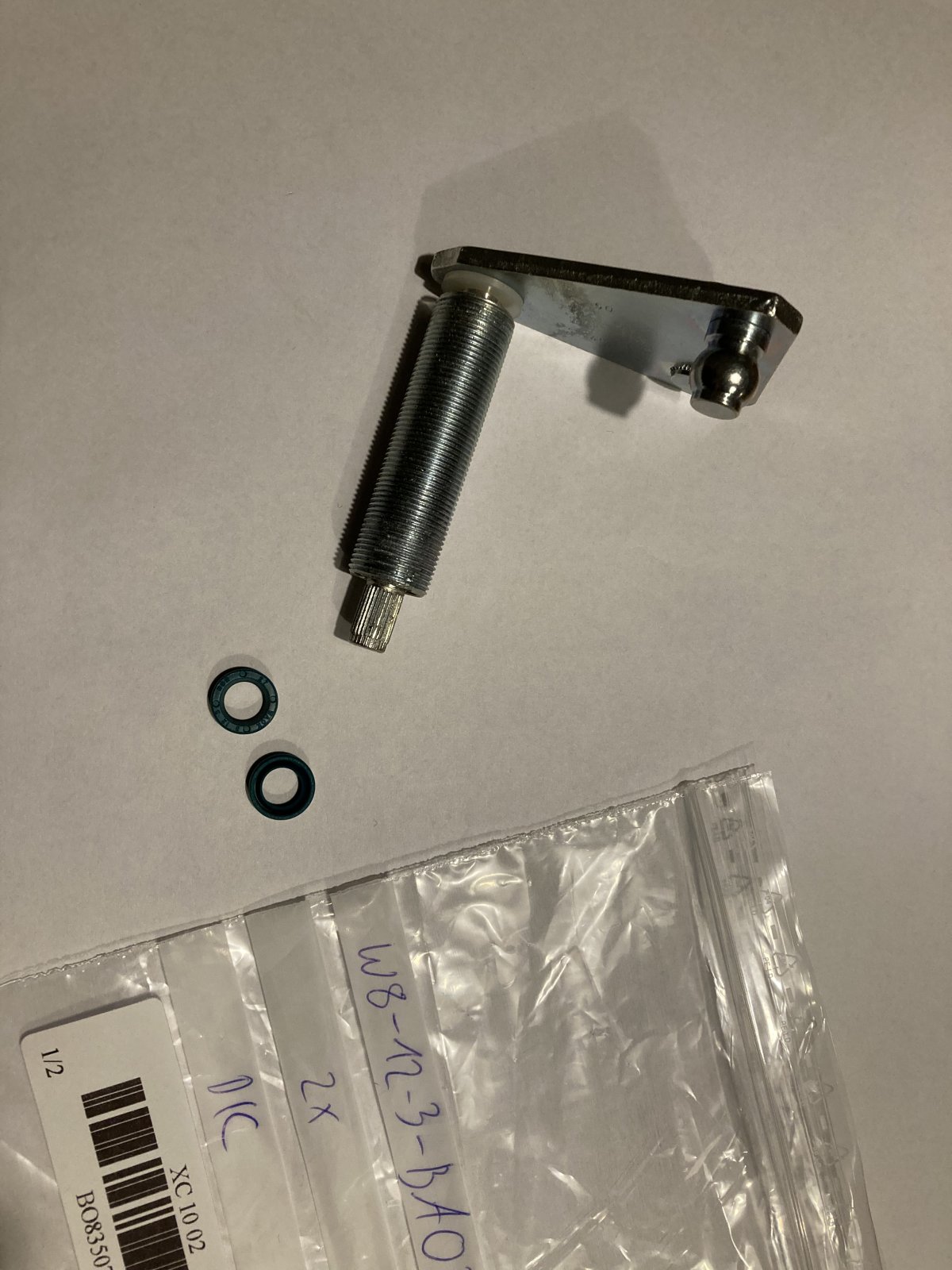

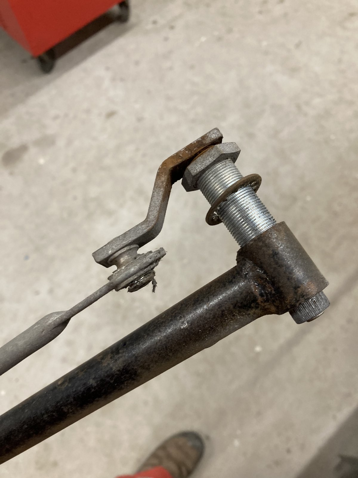

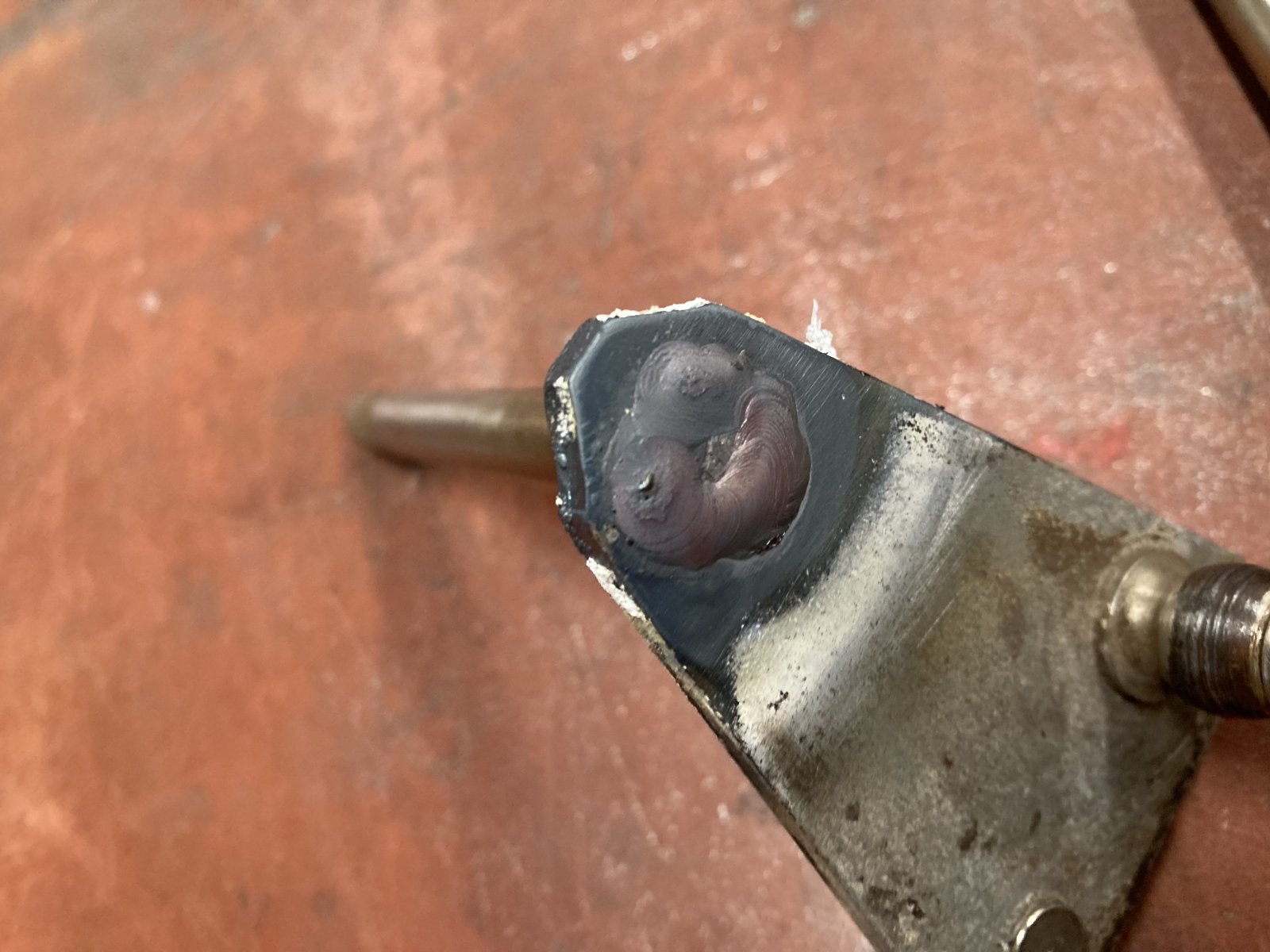

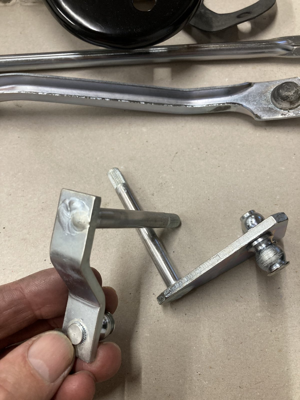

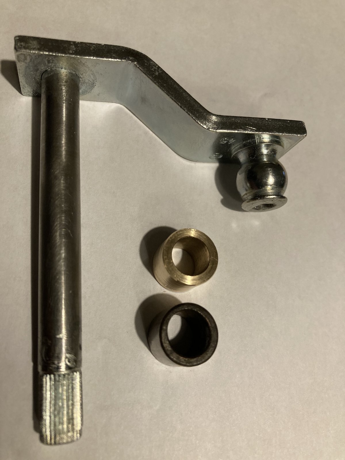

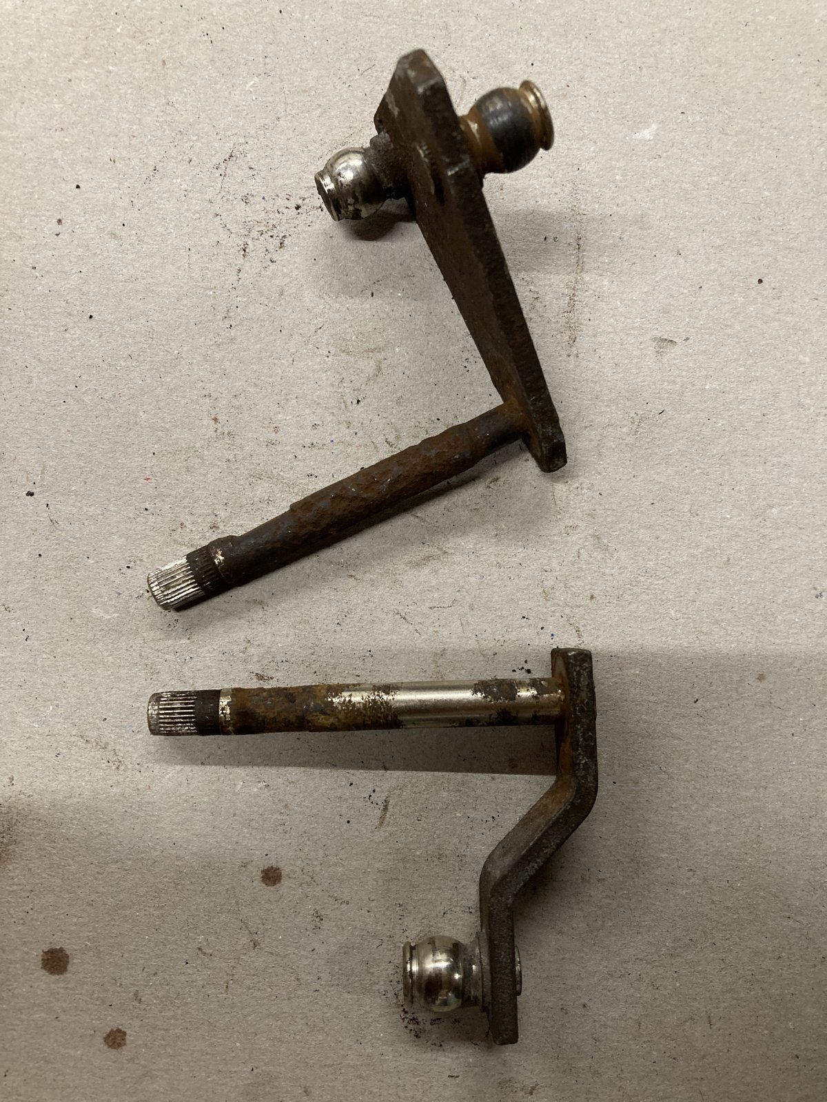

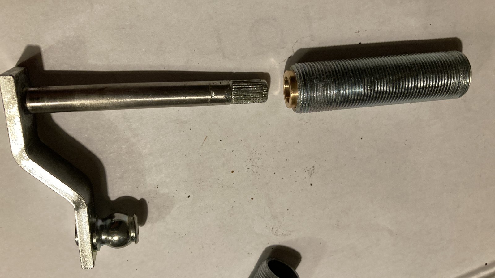

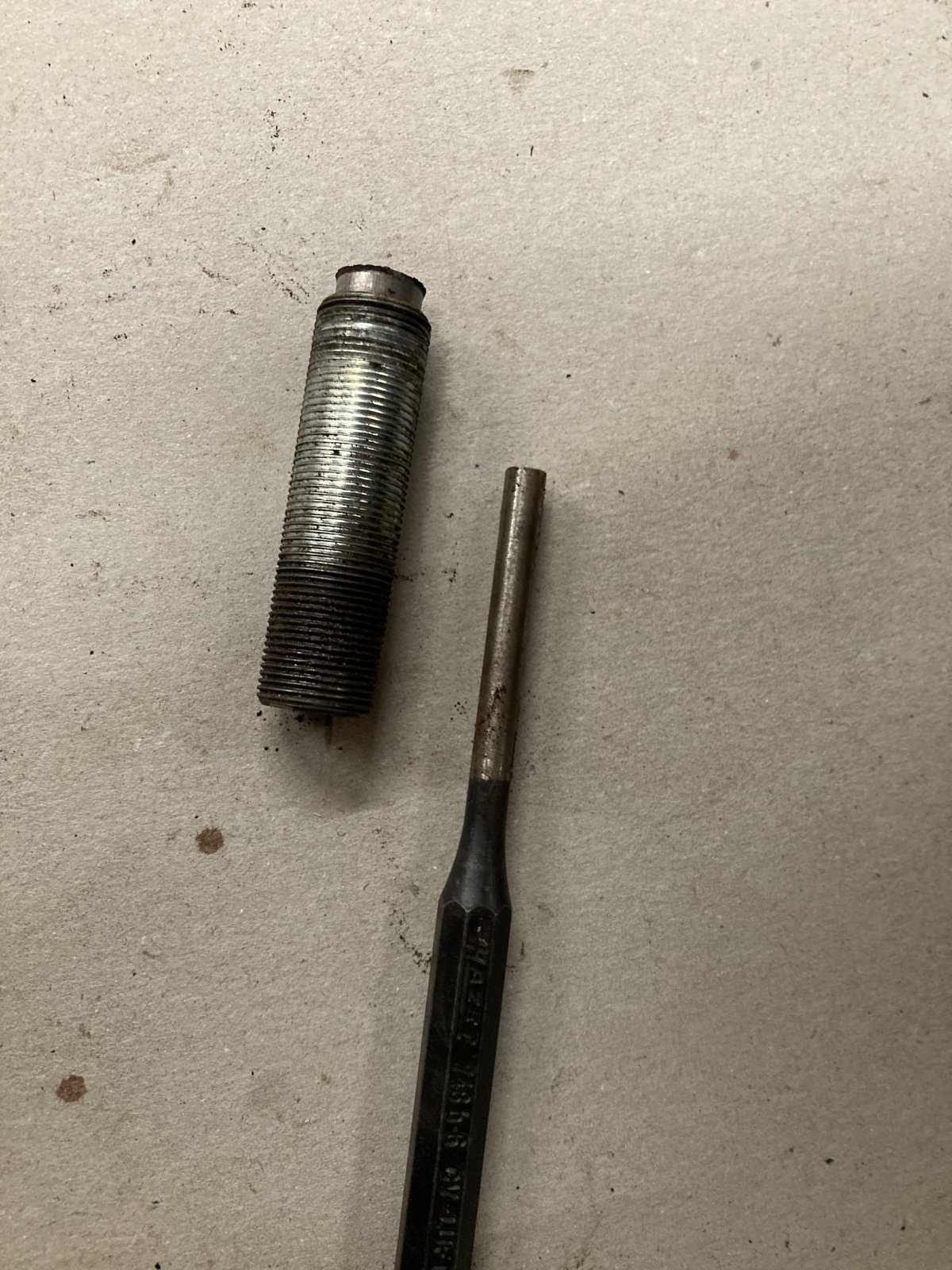

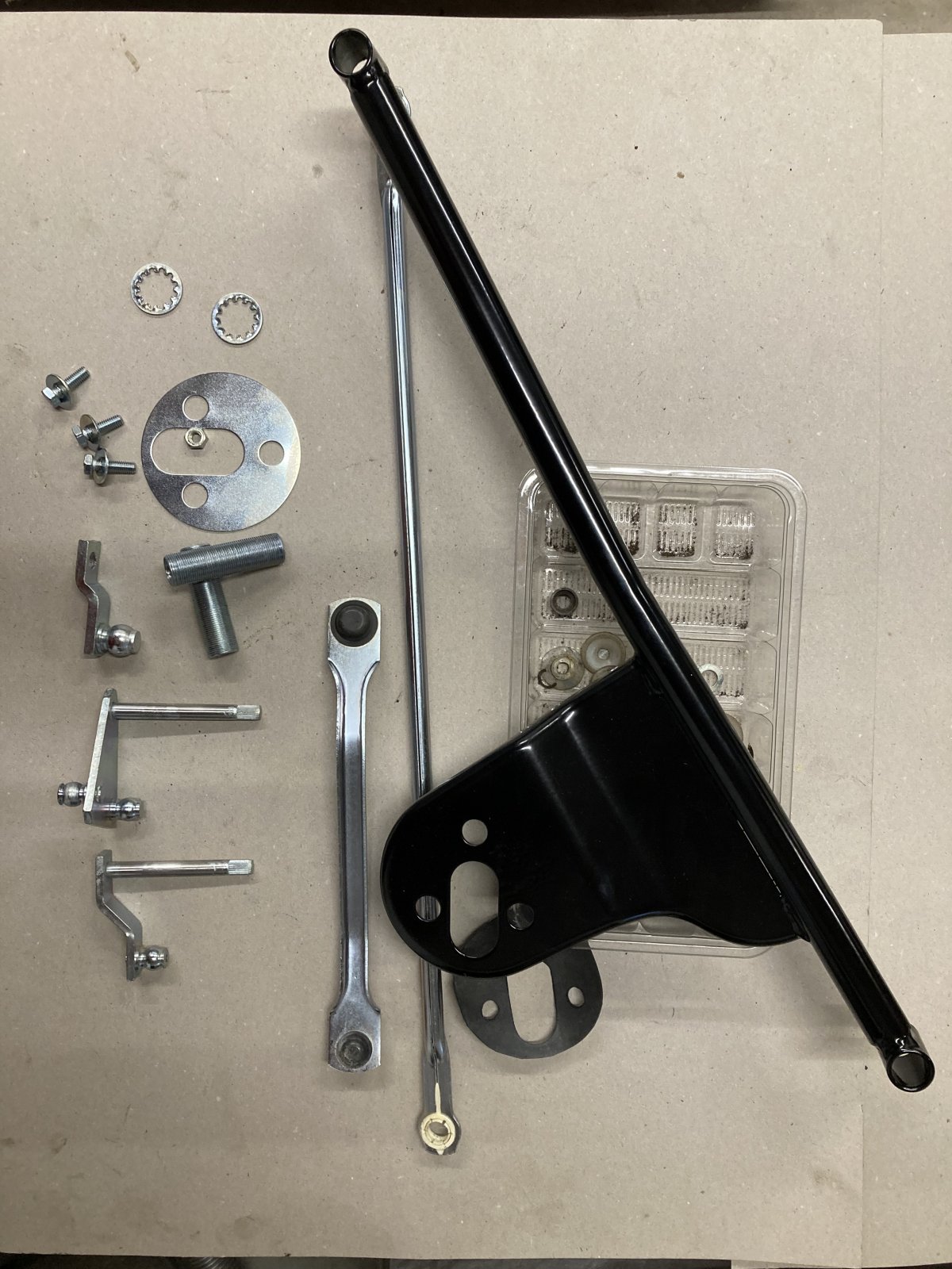

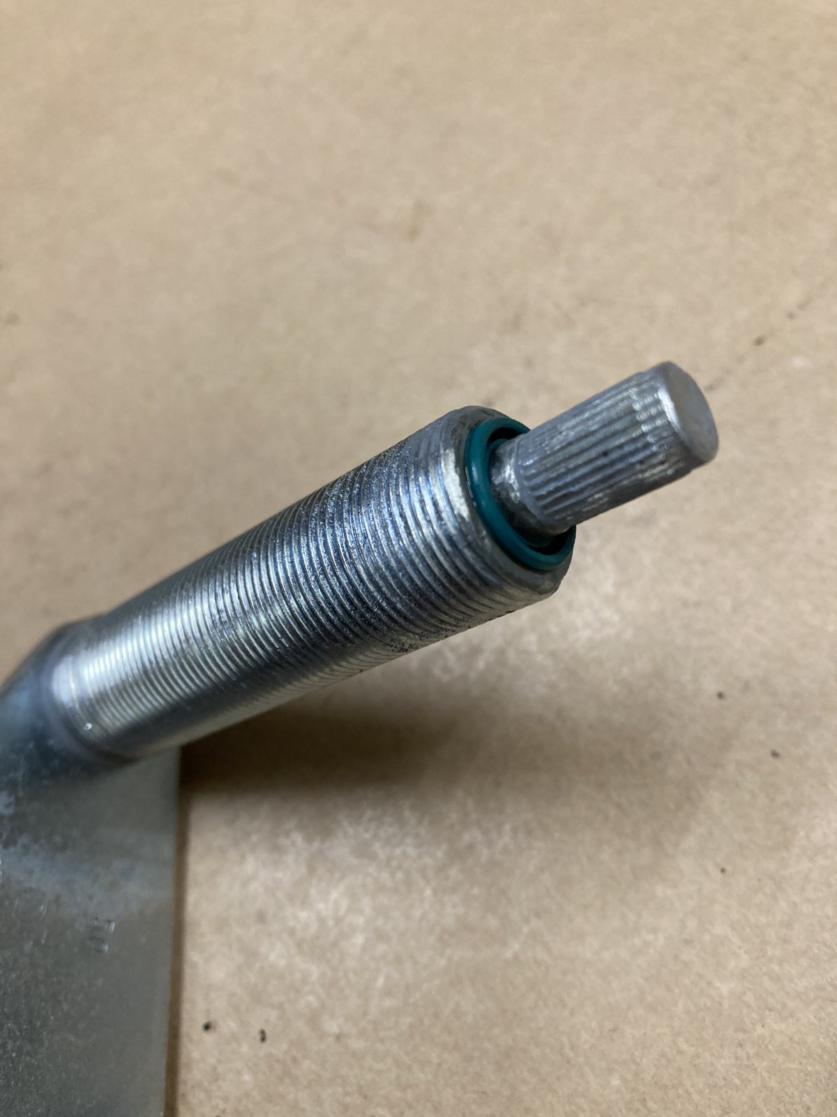

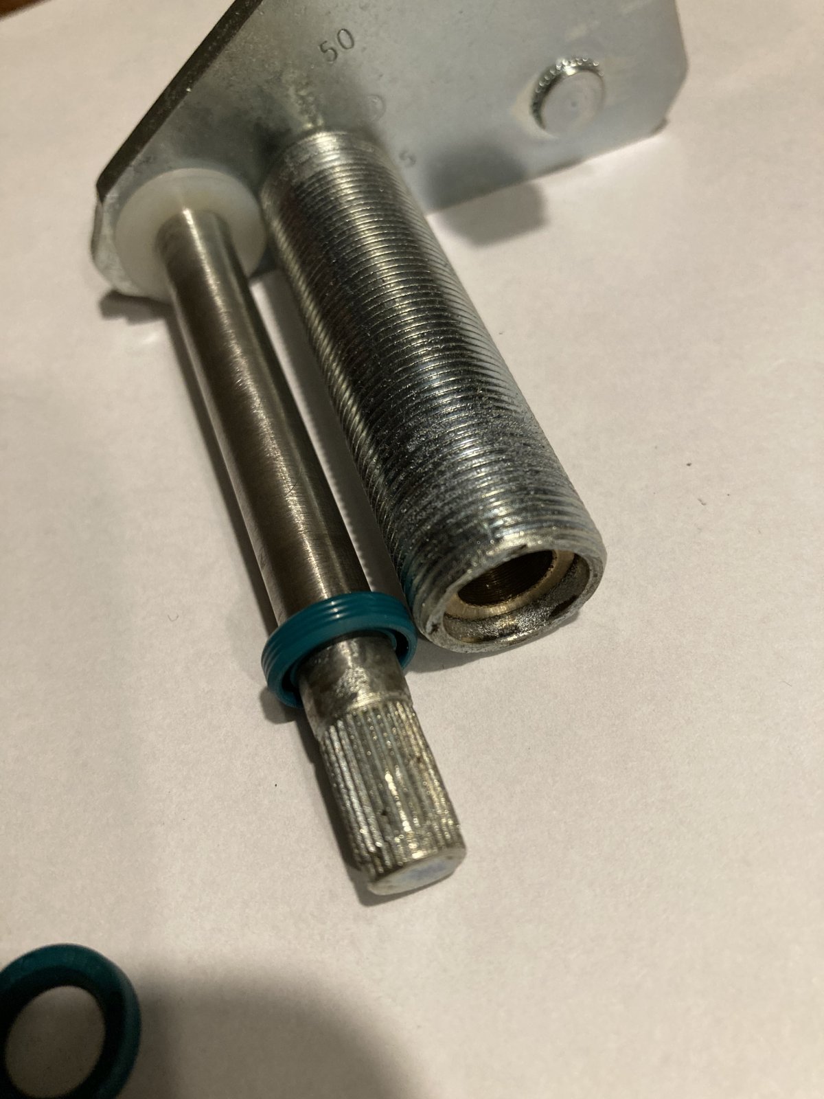

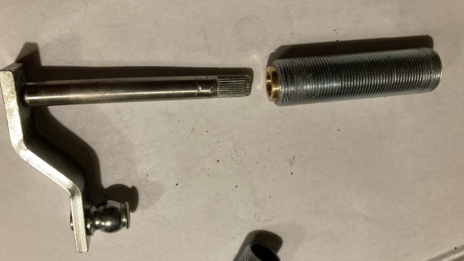

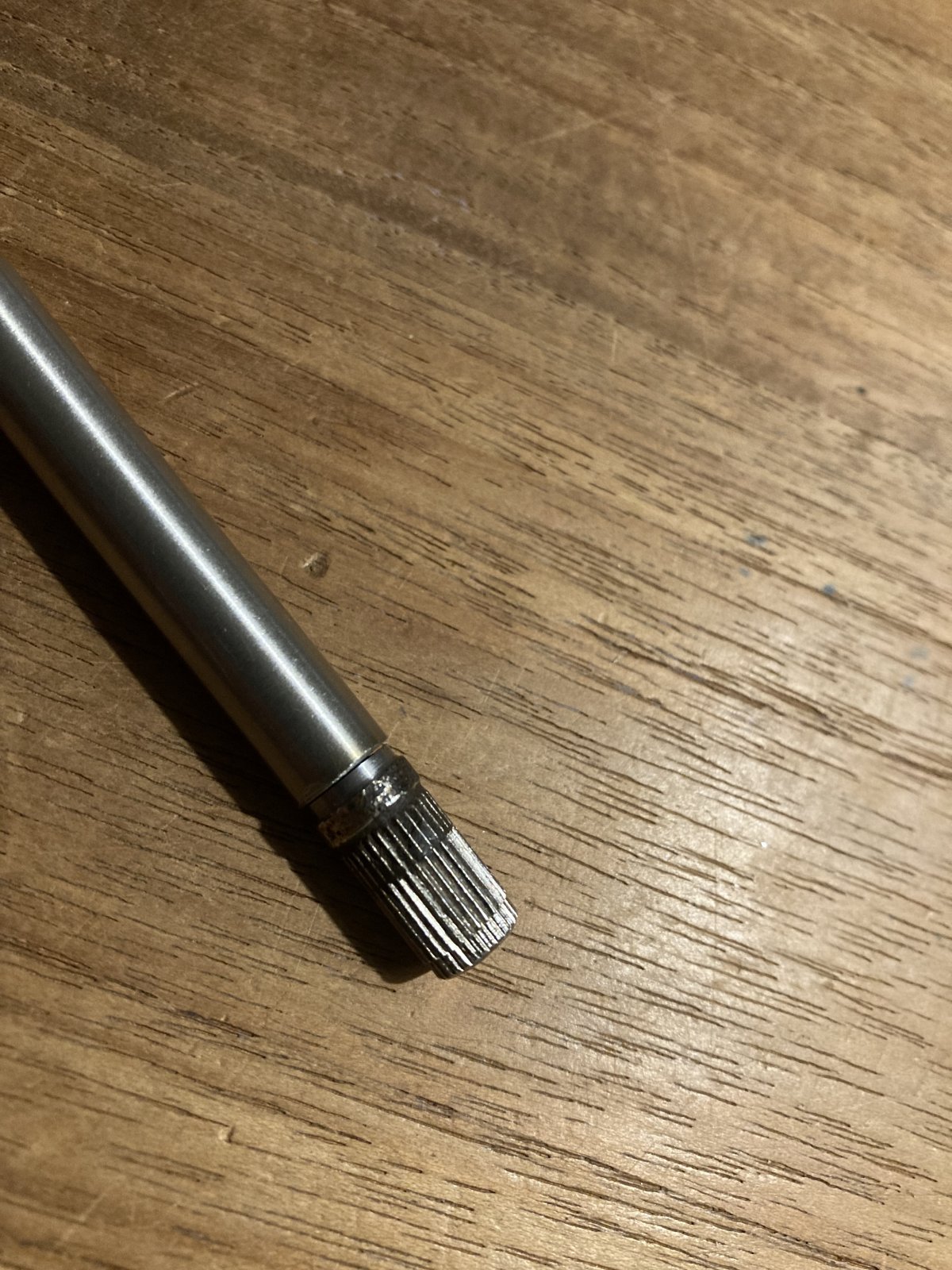

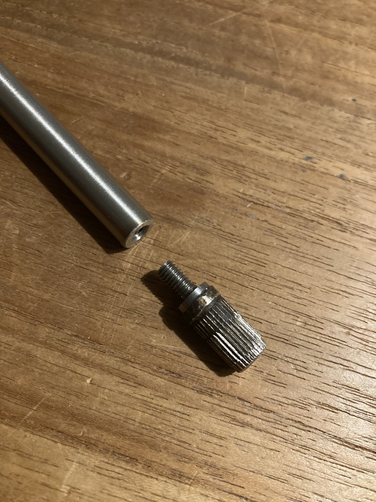

Hello e9 Freunden,
I refurbished the wiper system. In attached photos you can see my work.
1) dismantling the wiper system
2) remove the rusted rods and replace the rod for stainless steel. I TIG welded the part with the original splines on the new stainless steel rod,
3) new zinc coating of the parts,
4) powder coating on the carbon steel parts,
5) new brass bearings (selfmade),
6) reassembling: in progress - photos will come soon
6) update February:
Work finished. I also put a small sealing at the rod

With your skills, Fritzie, you should consider a better mechanism to hold the wiper arms onto the splines. A friend of mine used a screw through the wiper arm, immediately above the spline as an added measure of security. Roughly, his process was as follows:
Remove the wiper blade turn it upside down, and drill a hole through the center of the area that grabs the splines. Install the wiper blade on the splined rod, and drill a hole in the rod using the hole in the blade as a guide. Remove the blade again and thread the hole in the rod. The use a flat head sheet metal screw to secure the blade.
That works very well. I had to do this when my splines were smoothed over too much. I found the required replacement part but it had inflated in price to ludicrous levels.
Here's the thread describing the screw mod that Chris mentioned
This is an alternative method to the top screw option I suggested.
