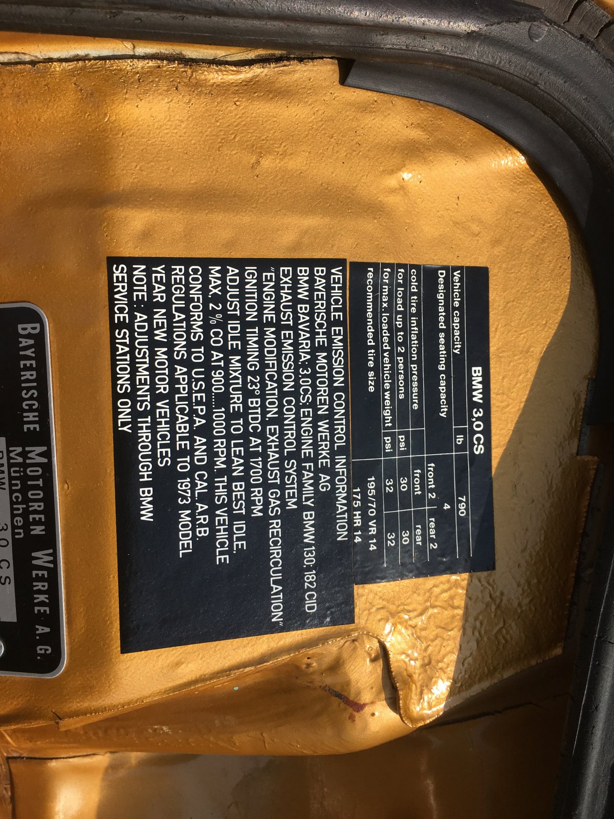

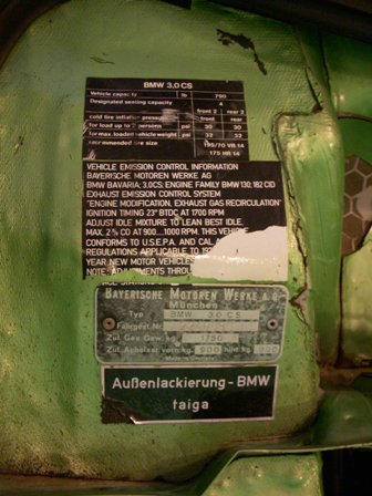

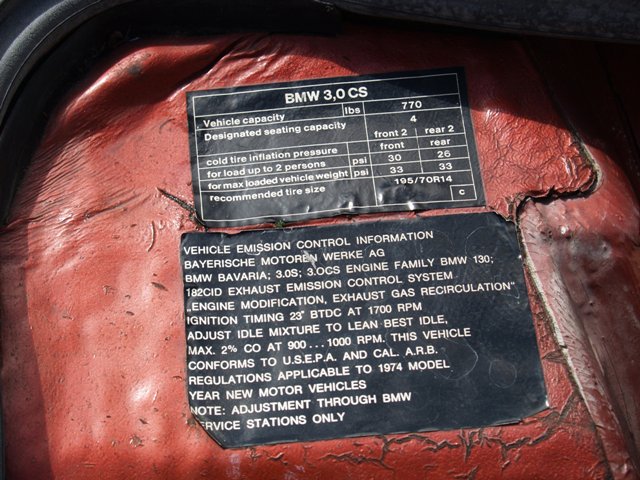

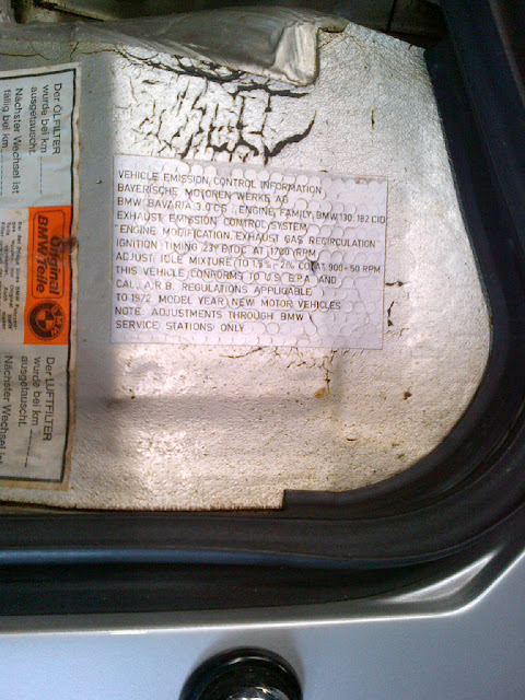

I will be creating new threads to help Mo make accurate stickers for our coupes. Let's keep this thread to this subject only. If you know your stickers are ORIGINAL only, you can post a pic with the dimensions in mm only please.
If you think these pics look familiar they may have come from you! Chuck's Ceylon is 100% original and am using his for starters. I have 73 and 74 only covered here, the 72 sticker is silver so we need a good pic of one of these, I only have a poor pic. The 74 has a smaller font for some reason.
We will eventually get to the 2800CS.
These are 105.75mm wide and 76.75mm tall

Thanks Chris,
Your efforts are appreciated although I would like to find one owner that has a high-res picture of the decal. I can set spacing and check fonts much easier that way.
The 72 silver sticker is mine, when I get home this weekend I will measure and take better pics.
