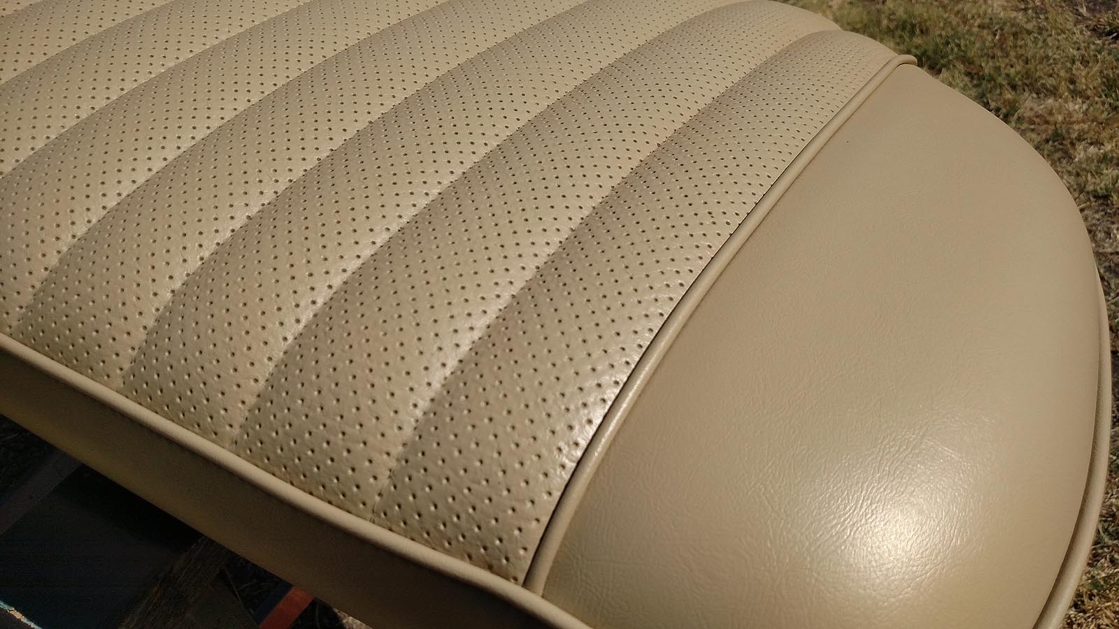

I'm cleaning up that '76 2002 I bought recently and decided to look into painting (or dying if you'd prefer) the seats. The front and rear seats are in very good condition and have been recovered in the past, but they all seemed faded somewhat. I searched the internet and checked out all the reviews and how-to videos and decided to try Dupli-color brand, plus it was the easiest to find. My friend is a professional leather repair guy and uses rubbing alcohol to prep the leather he works on, so I figured that was a good start. A couple passes with the alcohol and I started painting. It goes on thin, which is good, but covers pretty well. I was painting tan over tan so I had an advantage, but a guy I work with changed his black seats to white and it held up for over a year before he sold the car. Here's a photo of the bottom of the rear seat after finishing up...

Very cool, it must go on thin which is nice because the dimples still look great (not filled in with paint). Thanks for the tip.

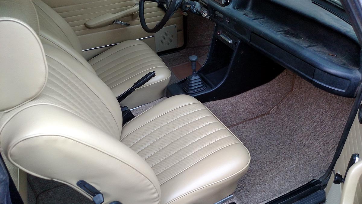

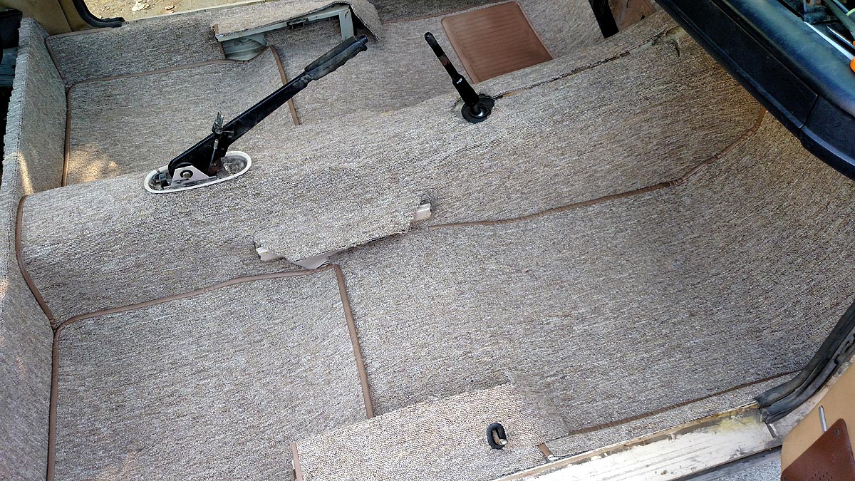

Finished the interior. Here's a few pics...
