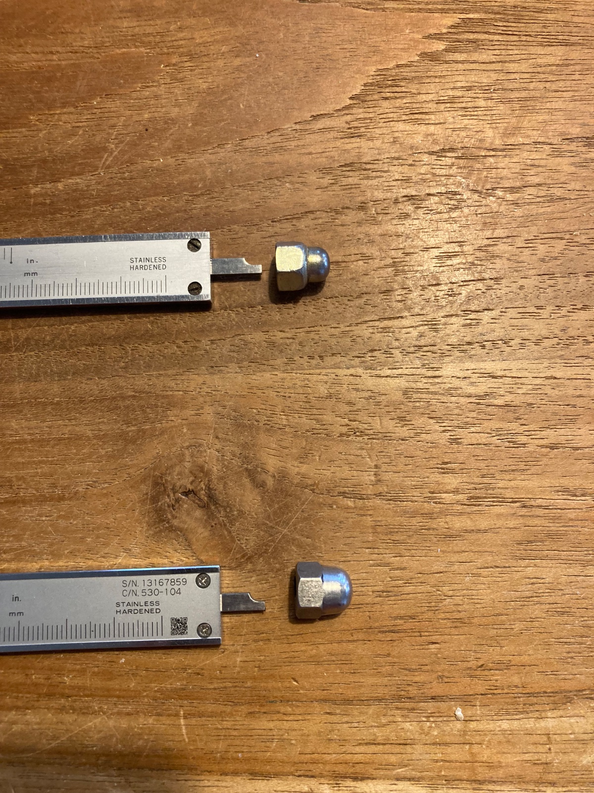

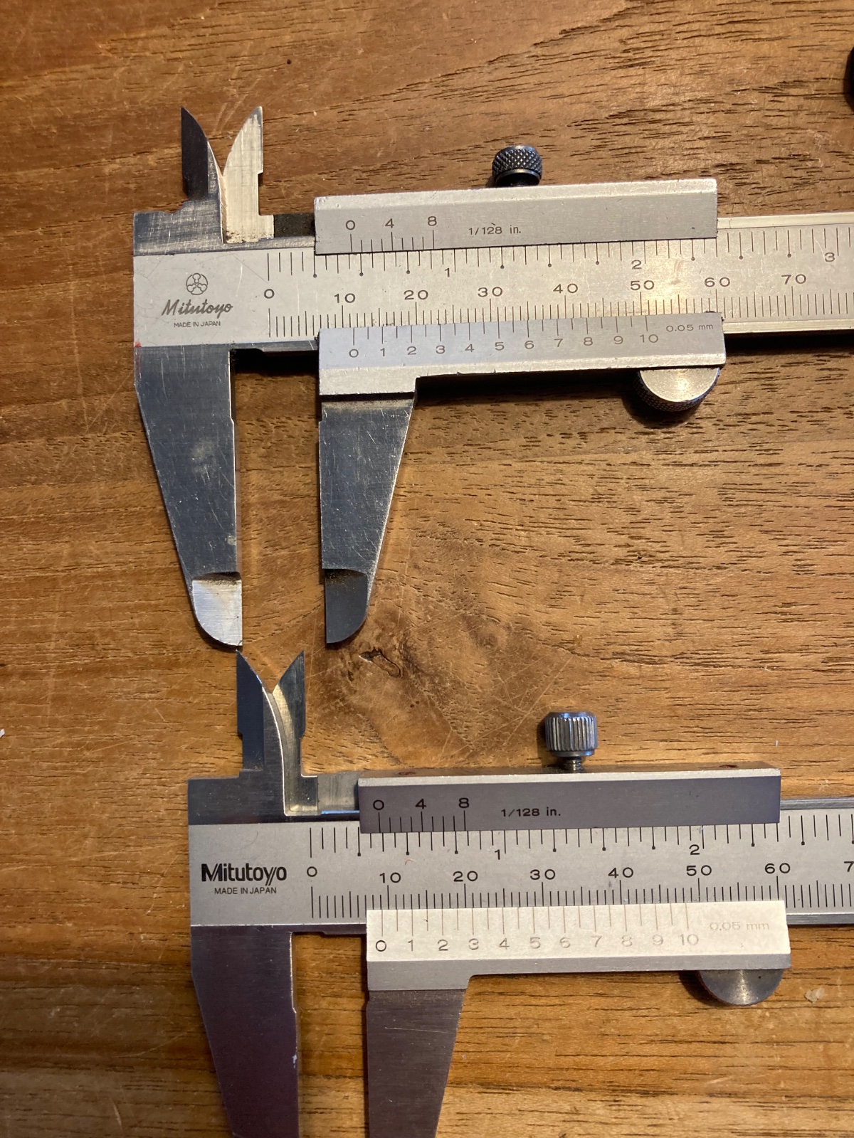

Be aware that the insert depth of the standard nut can be less than a OEM nut. The OEM nut is thinner at the top. So leakage can occur due to loss of gasket pressure
On top the OEM - dept 11.5 mm
Below SS nut - dept 9 mm
And the difference of 2.5 mm is needed for gasket pressure on the valve cover. You think it’s tight because you feel the resistance. :-)

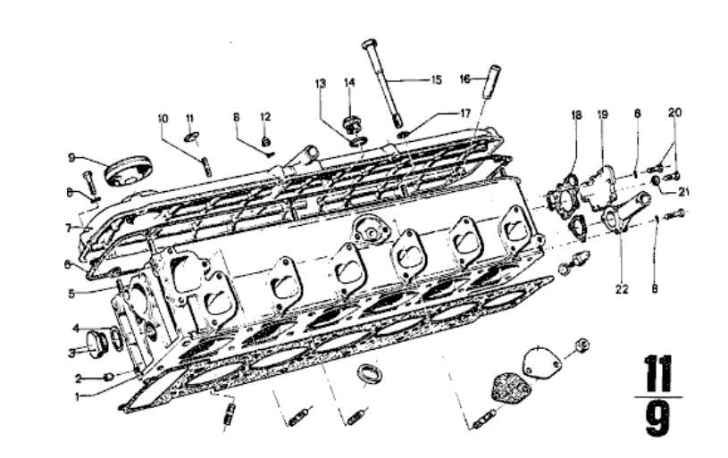

Parts manual shows that there are washers under the acorn nuts (part # 8). In my experience these are thin wave washers that are available from Belmetric in the US. I prefer using new ones when I re-assemble parts and/or systems as the wave is weaker after use and it is fairly inexpensive to buy a bunch of them to have on hand.

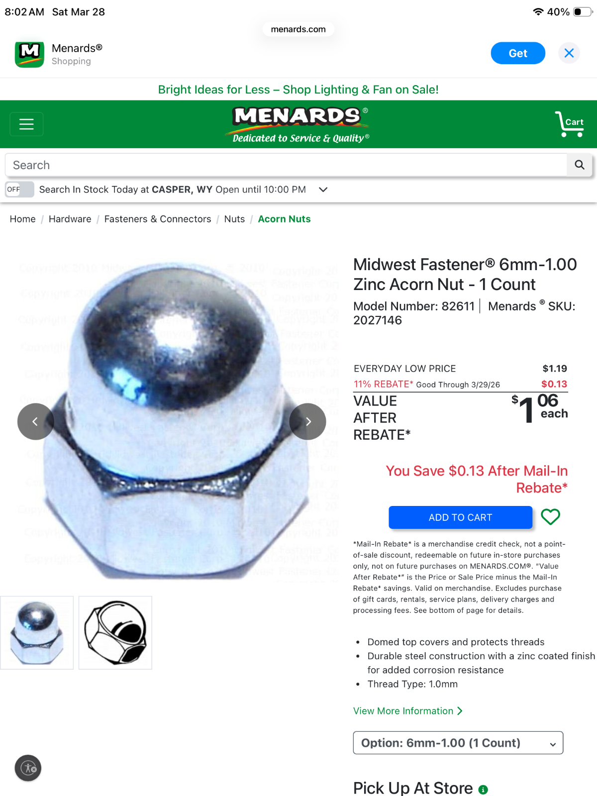

We buy from Menard’s

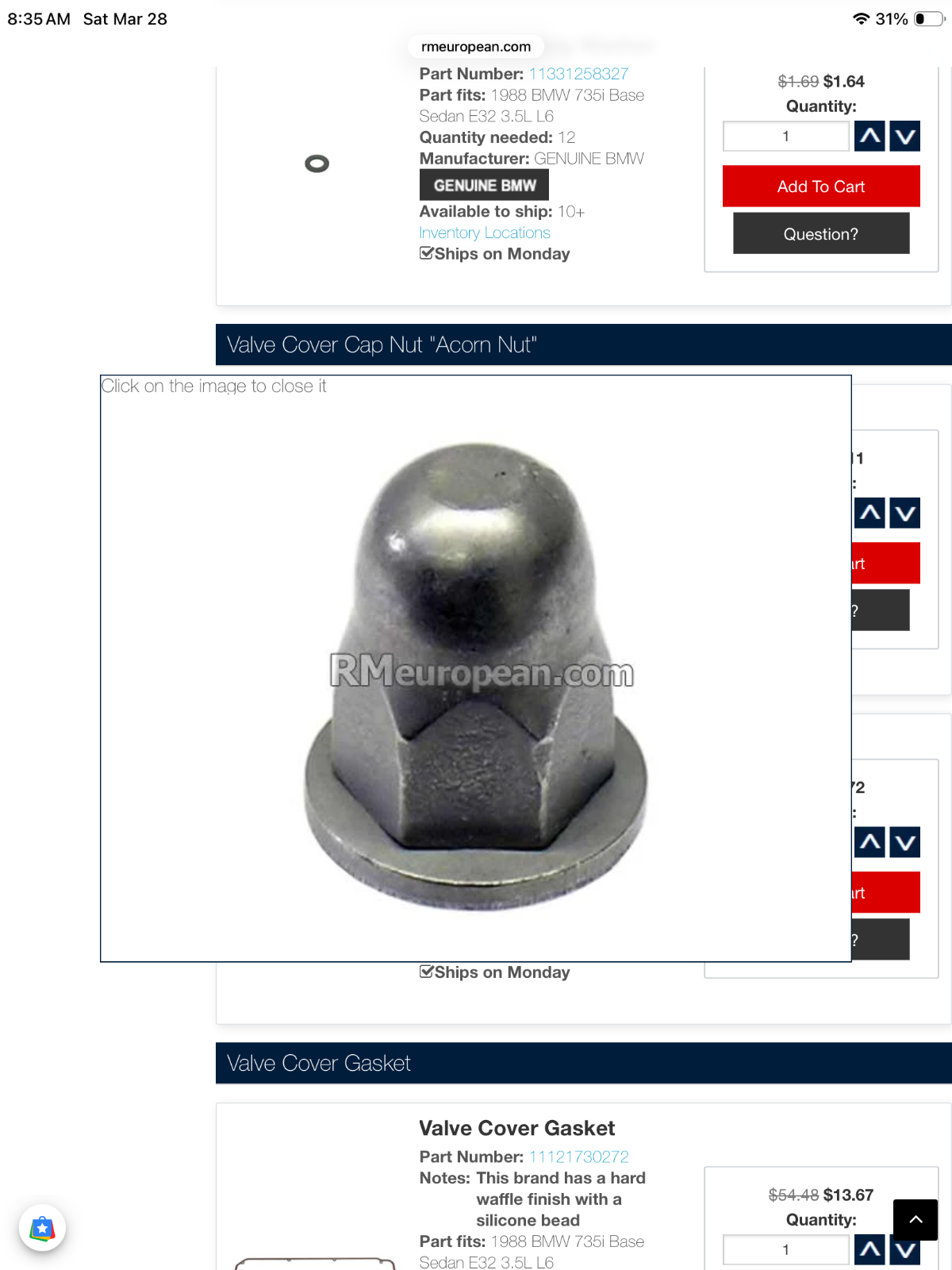

Along came the 1980’s and BMW came up with a solution for the Nut and the washer dilemma.
