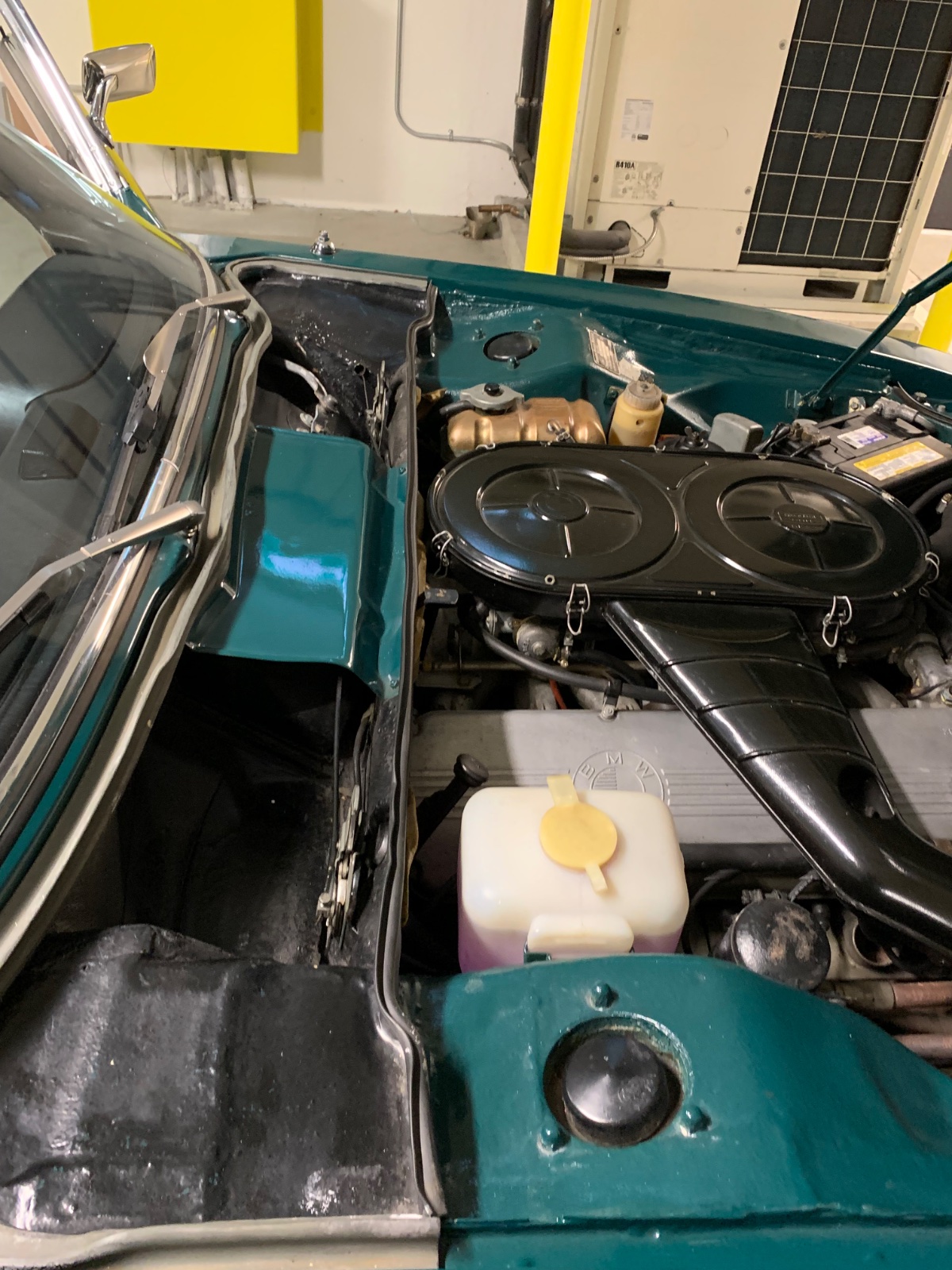

I have moved to Vancouver and need to find high octane gas for my ‘73 3.0cs.. I assumed 93 was the minimum. Equiped with dual Webbers, should I consider a fuel additive if I can’t find 93 or more?

Hi Pinstripe. Chevron has 94 octane readily available around here, just super pricey. I run that exclusively, no additive or booster, in my '72 CS with dual 32/36 Webers.

Thank you so much. I’m less concerned about price because I only occasionally take it out for a spin.
Timely thread and thanks for the question. I presume (my new to me) CSI coupe requires 91 no lead? That's my only option here in Vermont.
I've been using 91 octane PUL in my BMW's since 1984 or so. I try to get ethanol free fuel when I can, but that's not always available. I sometimes can find 92 octane here on the West Coast - but not that often. Regardless - If I can, I run ethanol free gas (and that is 91 regardless - at least for me here near Seattle).
Back in 1986, I rebuilt the M10 in my 2002 with 9.5/1 pistons and used a stock tii mechanical advance distributor (no vac advance). Standard premium gas worked great.
I have a stock set up in the 2.8L M30 in the 728i. No problems there either. I understand that motor has 9.3/1 compression - similar to what I had in the 2002.... 91 octane is fine for me.
I also use that fuel in the M90 @sfdon installed in the E9 a short time ago. Never had any issues with detonation with any of these cars.
