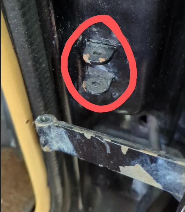

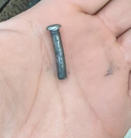

But need these 2 pins:
And also need 2 of these doors stop mount shown below: Is this the same as the used Mercedes "Meyle" units.

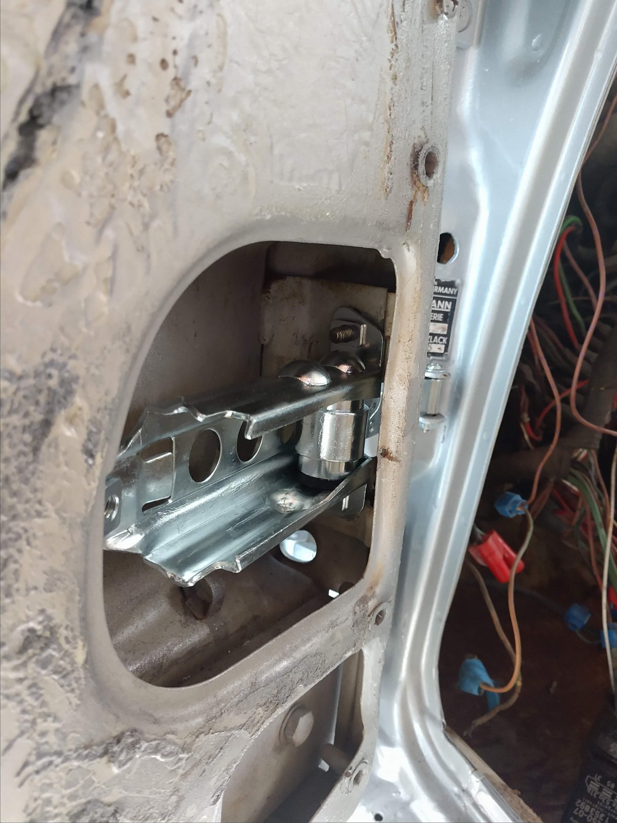

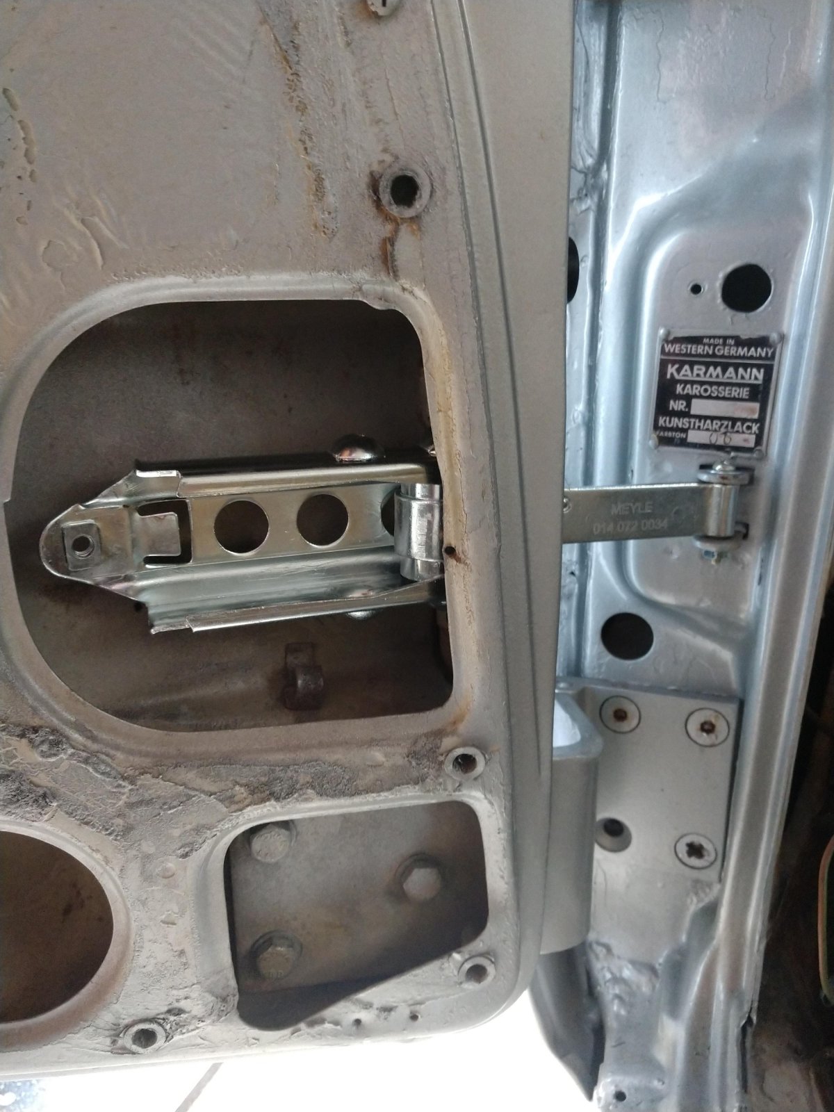

Here's a couple pics of my install. The Standard pin/rivet you show in hand was too big so I sourced a bolt and nut combo that fit close. Then I sleeved the bolt with a piece of nylon tubing to quiet down the metal on metal.
The only thing i didn't do that mercedes expects is affix a third mount point, notice empty threads on left side of unit.

It seems that my original post about the door brakes and the pins were answered, but my most recent post about the (Door Brake Chassis Mount) with pictures was not answered. I would also like to know if the mount is even replaceable or if it's going to be a custom replacement piece. (Metal Fabrication)
Thanks, I really appreciate the input.
