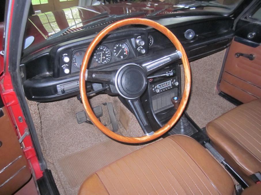

My Bav came with one of these. The laquer was cracked/crazed throughout. I had done a lot of furniture restoration so re-did this myself. The laquer sands off easy but be aware the wheel is not solid wood. It is a veneer on what looks like fiberglass. After re-staining with oil-based stain, I finished it with a 2K laquer (can get in a spray can set up for EZ app). Came out quite nice.

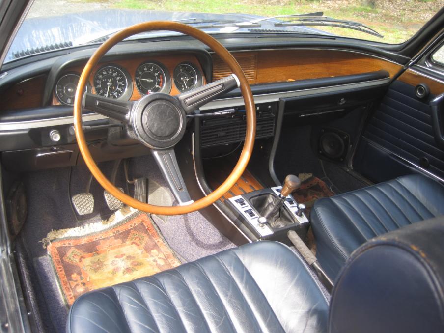

Athena, my coupe, came with one that had a crazed finish, I just sanded with 220 and refinished.

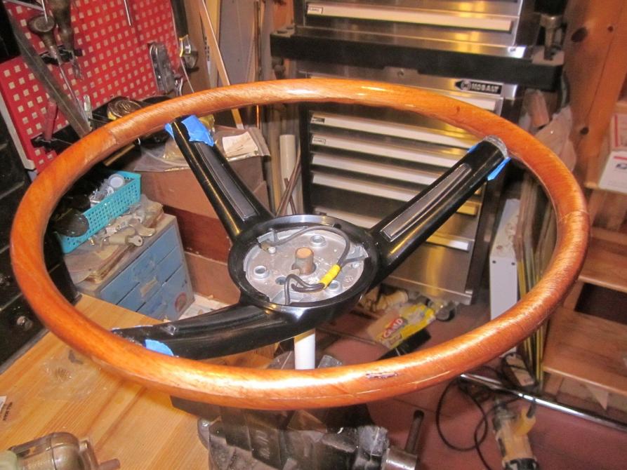

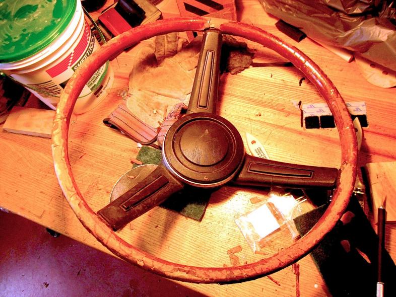

Vern's steering wheel was a complete restoration complete with new veneer. The spokes were cracked and crazed. I used Minwax High Performance Wood Filler to fill and smooth, then painted with semigloss black spray, then used 0000 steel wool to make it look right.

Great photos, thanks! Please tell me know how the re veneer works. I am a professional woodworker with extensive veneer knowledge and it still is a headscratcher how that can be re veneered! And I assume the spokes can be repaired with an epoxy filler, sanded and sprayed. And missing 1 silver trim piece where spoke meets wood...backside. Any leads for salvage steering wheels? Thanks again for all the feedback. BTW, I reside in Atlanta.

Reveneering the steering wheel. Remove all old veneer. I used blue painters tape following the seams of the steering wheel to make patterns to place on pressure sensitive mahogany. Placed the tape on the veneer and cut out the pieces. Then I wetted the veneer with water, keeping the PSA dry. Placed veneer on the wheel and pressed it into position, then used fiberglass reinforced strapping tape with a lot of pressure to get the veneer to conform to the wheel. After 45 minutes I carefully removed the strapping tape. Repeated the process until it was done. I used an iron to conform the veneer to the finger grips on the back.
