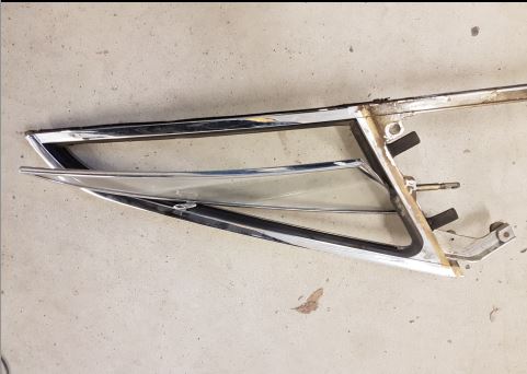

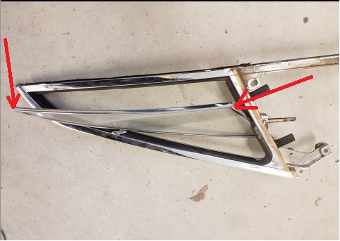

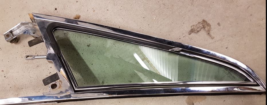

Thanks Peder. Great advice, but unfortunately now I'm committed and everything is already in pieces. Part of me wishes I hadn't touched them, but I did need to remove the glass as the colour was not correct for my car. I did read about newly bought glass not fitting a while back, but my glass is original and hopefully will fit ok, albeit from a different car. The screws came out very easily, so one good thing. I did put a nice bend in the frame on separating it from the glass, but I think I've rectified that. What a painful job. I found a good method to remove the glass in the end, I'll post pictures if anyone's interested.
I didn’t find it that easy, hard to grip and use the necessary pressure without causing damage. Maybe if the sealant has degraded.
