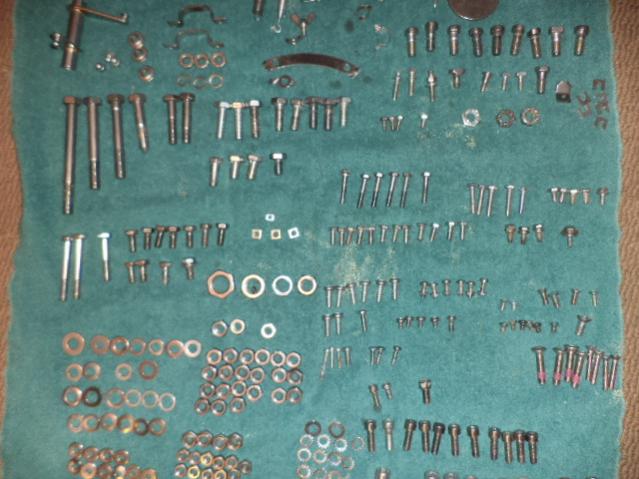

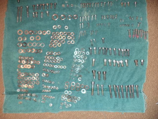

I have included a picture of a bunch of stuff getting ready to go the platers but all of these were either rusty or painted over. When I mean rusty, I mean that a bolt is rusty but not lost it shape or the threads are too worn out. Don't expect a bolt so rusrty, it looked like it came off the ocean floor , to come out pristine. But they will come out really, really good if they are halfway decent going in.
