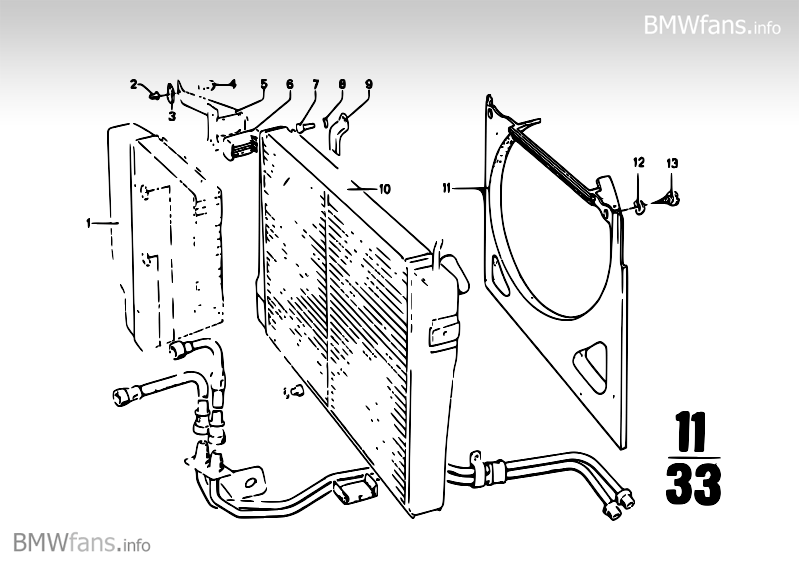

A radiator shroud will probably will alleviate and possibly solve the high temperature problem during idling and low speed operations. The shroud will help to "centralize" the air coming through the radiator instead of the fan pulling air from every which which way. I suspect that the later viscous 9 bladed fan system work best with a shroud in place. The original fan setup on my previous CS did not exhibited these cooling problems.
My coupe uses the same clutch/fan as yours and it exhibits the exact same cooling faults as yours. I too have change the fan clutch, thermostat, coolant, a new radiator and the problem still persists. I've bought a new shroud (still pretty cheap) to install on my coupe but have yet had the opportunity to do so. Hopefully when installed, it will solve the nagging problem.
Bmw shows the shroud in their part catalog, but very rarely have I seen one install on a coupe. This application may be for the very late 74 and 75 coupes.
Radiator - BMW parts catalog

The shroud could be used but your problem is elsewhere and there's a good chance the shroud won't solve the problem. I can also tell you that a shroud from a E12 won't directly fit.
