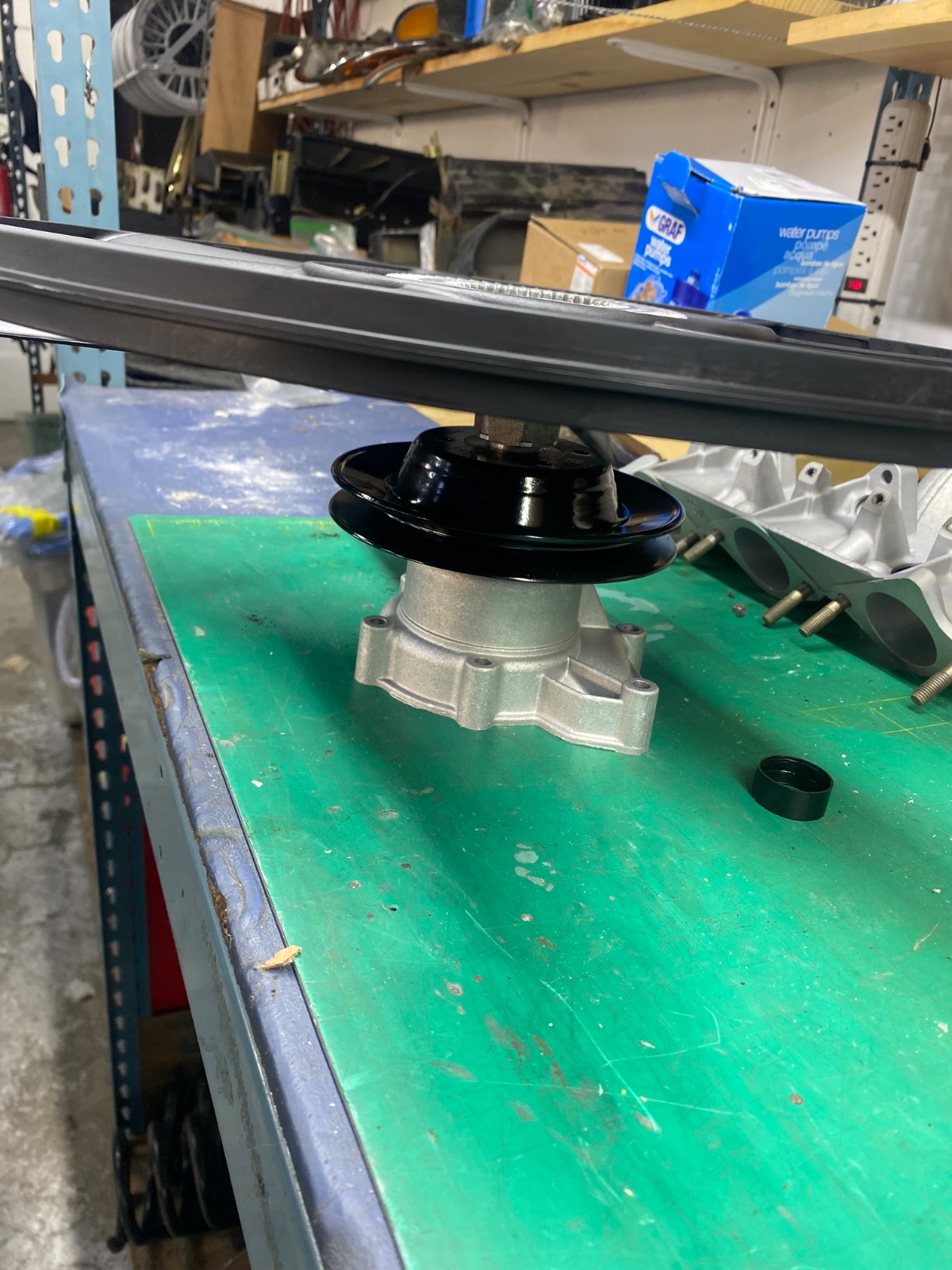

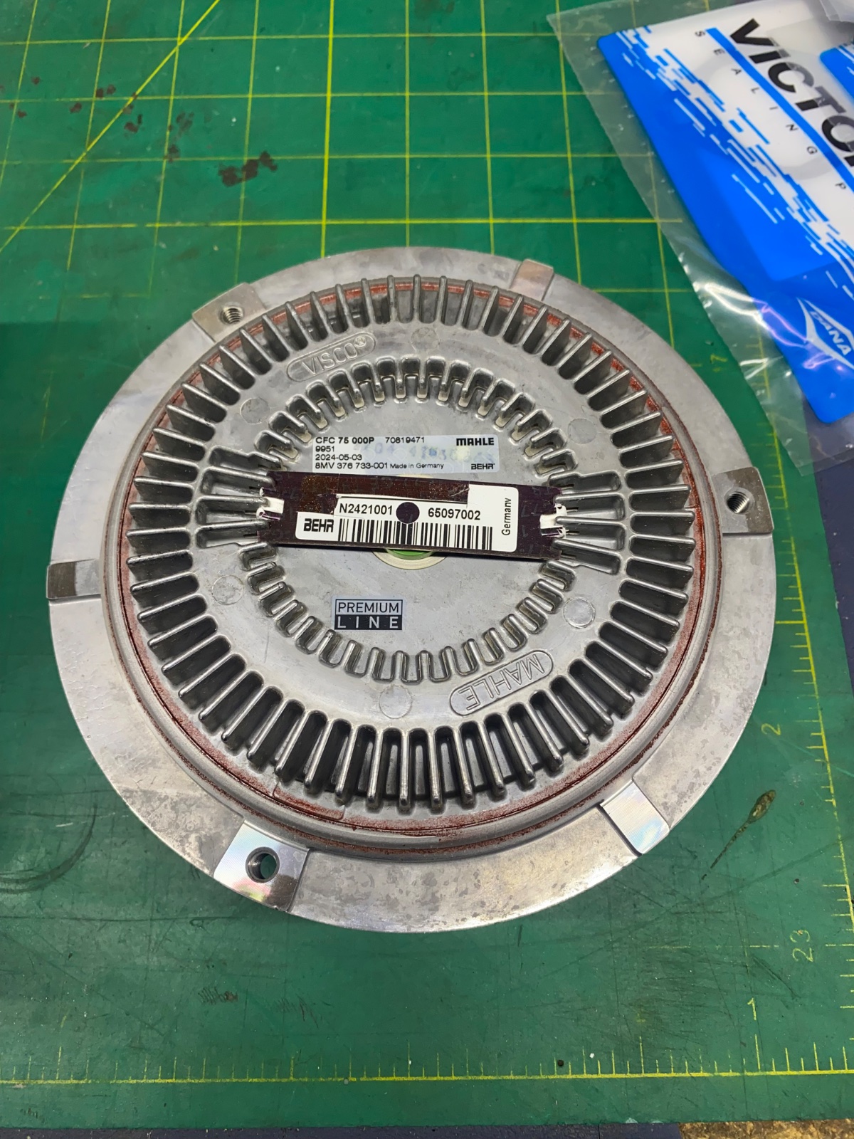

In the shop, we use the best final cooling elements available from BMW to get spin-on ease, super thin fan with integrated fan shroud and heavy duty fan clutch cooling.
Add an auxiliary fan with an 82* C temp sender and you get 185-190*F stable temps.

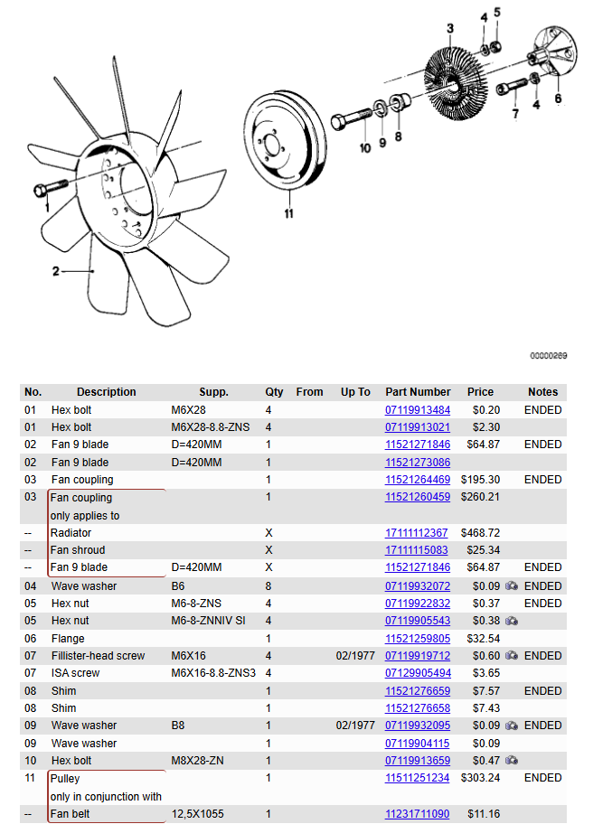

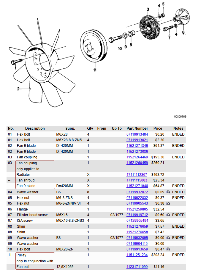

thanks for the thread. Sounds like its better to upgrade to the 9 blade set up. Is this a simple change or are there fitment issues?
i read people talking about a 400mm blade but the diagram below is showing 420mm. If i buy everything in this diagram will it work without any other modifications for fitment?

Let me repeat, I am no expert. That said, the short answer regarding changes and fitment concerns is “few.” If memory serves me correctly, switching to a nine or eleven-bladed fan did not present any fitment issues, although the newer-style fans seem to sit closer to the radiator than with the five blades. Further complicating the fitment is attaching a fan shroud to improve air flow - if your original radiator or radiator support does not readily permit this. (Hint: 2x check those motor mounts and transmission mount to ensure against too much engine movement during severe braking or acceleration.)
Regarding the 400mm versus 420mm conundrum, I cannot speak with any authority as to whether an additional 20mm creates any any additional fitment issue/s. Sight unseen, after 50 years, radiators and radiator placements have a tendency to vary with each application. And . . . if your radiator has been re-cored or replaced, it is impossible to foresee how or by how much the radiator might differ from the original.
Regarding your post whether the highlighted parts would make for a complete upgrade, it appears that the answer is a guarded, “it depends.” If, for example, your vehicle has been in an accident, you might have unforeseen fitment issues. Likewise, not all parts, even new ones, are identical. But, if you are considering a wholesale R&R of the current cooling system, why not upgrade to a new water pump that accepts the eleven-blade fan?
Unless you are experiencing overheating or poor cooling issues, you might consider keeping what has worked for five decades, i.e., five blades. In fact, if your fan clutch is failing to engage, a simple fix might be to try shimming the clutch as mentioned in forum threads, or as a default position, locking the clutch by two lengthy bolts. Obviously, the latter solution is less desirable, considering additional noise and drag. However, it is probably far more common than some might think, considering the cooling issues it might prevent.
Answer is yes
You have the initial setup with friction clutch and five blade
Your description and parts are ok for a nine blade with viscous clutch conversion, easy to swap
Careful as you will need all those parts…
Here parts 6 and 8, crucial and me thinks NLA, but I might be mistaken
You need to remove the radiator to be able to do this
One small detail about this drawing is that the pulley 11 is wrongly represented, it must be at end right position, rest is ok, it works well, me as of 14 years of ownership

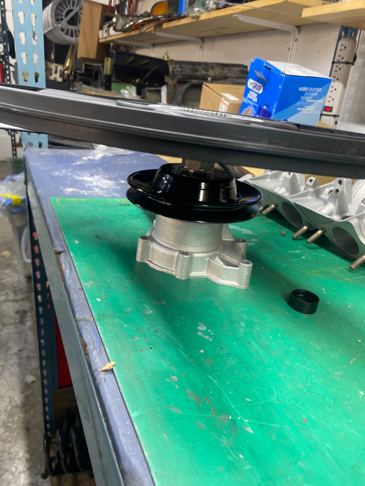

An excellent solution too,
@sfdon could you please provide 82ºC temp sender reference ? I can only find 90-95 one
Thanks mate, just trying to understand your reply. Are you saying i should buy all the parts in the diagram i posted?
Your diagram shows what I would call Gen 2 cooling. A bolt on viscous fan clutch. 9 blade fan.
Gen 3 would be the early small spin on fan clutch.

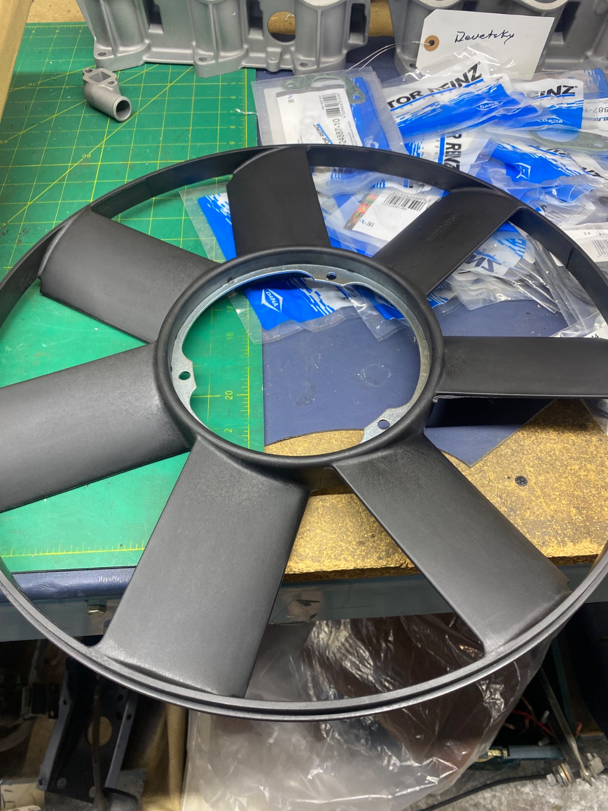

We are using Gen 4 parts - European only thin fan with last iteration big viscous clutch
ok. So do you have a diagram of the parts required for the Gen 4 system you refer to?
