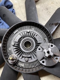

I have the setup shown on my E3. I am clearly missing something as the fan shim/coupling fits into the bearing so loosely when tightened that the fan has play front to back and periodically rubs on the radiator fins. Also so loose that the coupling will spin freely without turning the bearing when completely tightened down. The bearing itself seems fine, smooth and zero play.
The Google translation is amusing but for the most part, unhelpful. The dimensions given are identical to mine. At this point, I plan to make a shim to cover the difference between the OD of the coupler and the ID of the bearing on the viscous fan. Amazing that the fan has been rendered almost useless but I have not overheated.
Widely discussed in our forum in english too
Try a search in the e9 section
Switch to the screw-on viscous clutch and water pump? It's way easier to get on and off. And cheaper too. Or the one that Don is using now.
