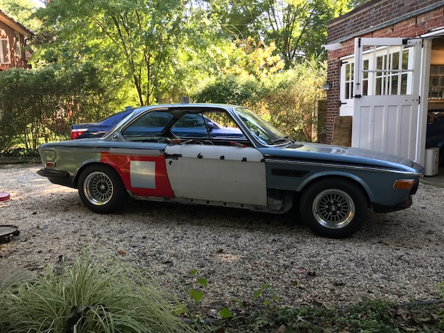

In my case it was a mix of all the above, rusty frames, rusty skins, lots of filler, dents underneath the filler, alignment issues as the doors were not original to the car.
I used both left and right W&N aluminium door skins as you can see.
