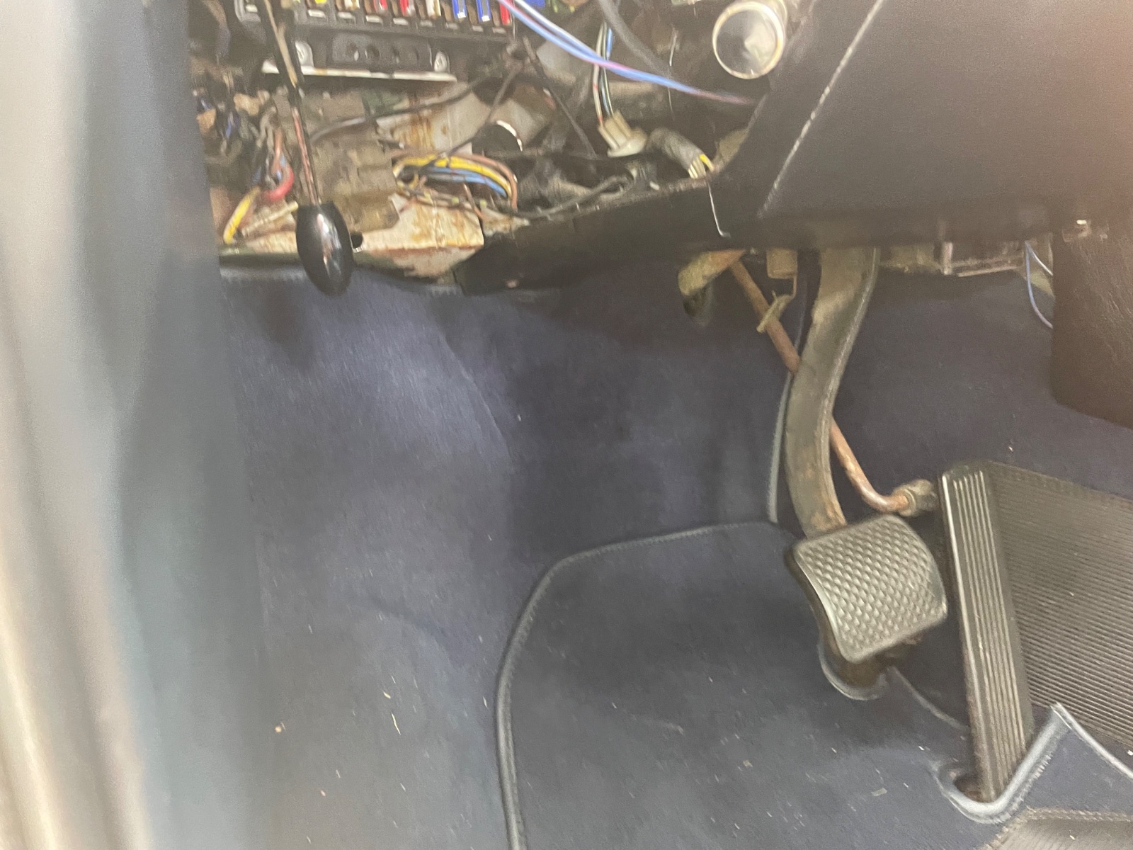

Three weeks ago my power windows worked well.
This weekend only the passenger front window worked ever so slightly. I need to use my hands to help it upwards . No movement from other windows.
Checked fuses and sure enough fuse 9 was blown.
Installed new fuses in 8 and 9 .
Yet only passenger front working again.
No red reset button under dash like I’ve read in other forums.
Checked switches (unlikely given they all wouldn’t fail at once ) - those look clean and good contacts.
Is there a relay I should investigate? If so where is it?
Other diagnostics to resolve this issue?
Strange
