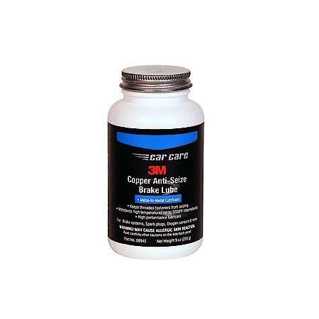

there is no need to add another piece to that puzzle,
just a dab of copper paste
Jesus is correct. 3m coper anti-seize lubricate. Apply it to the back of the pads.
