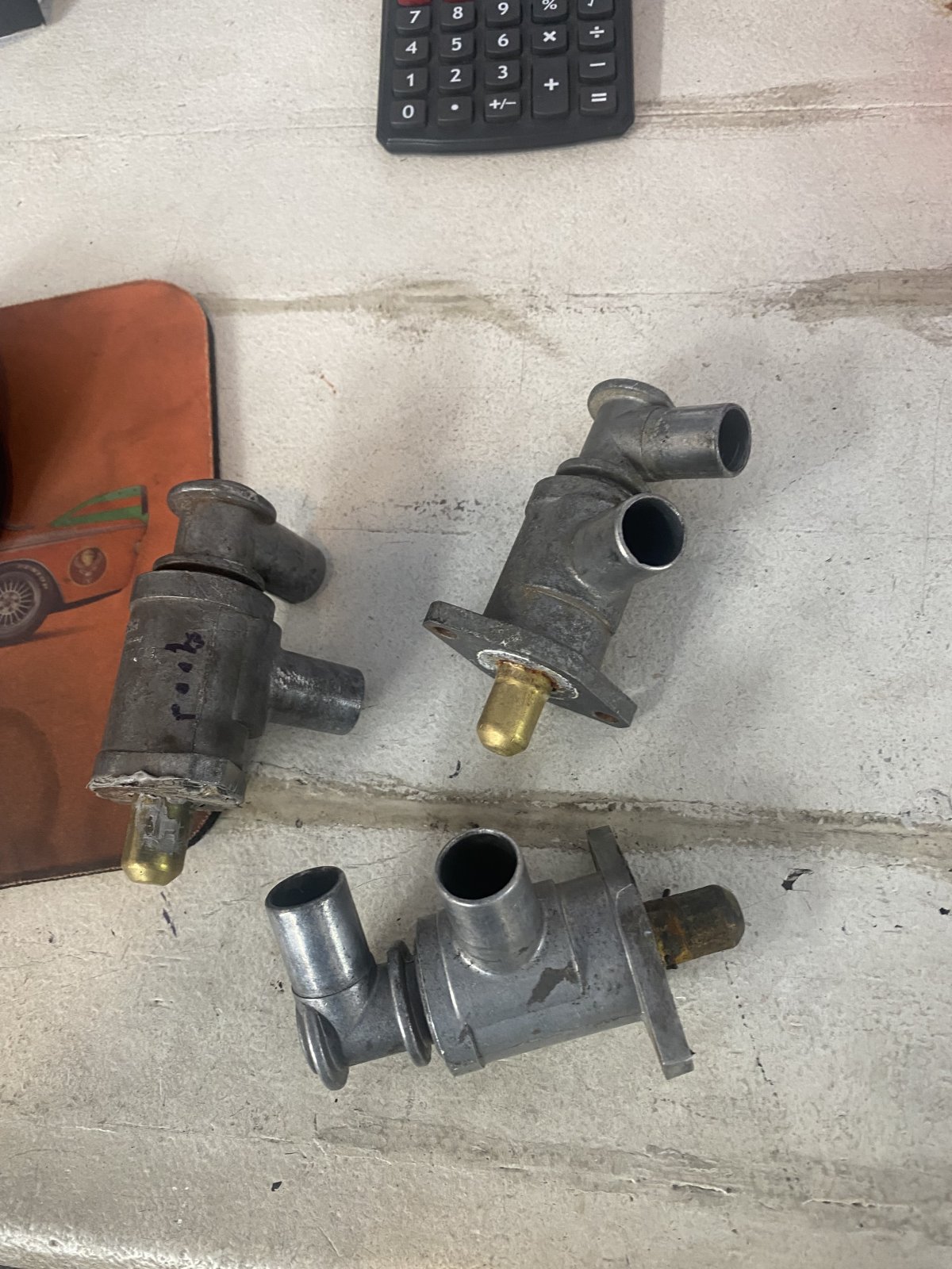

Hello,
I am having a problem with my idling after starting, idles high when starting which it should, but does not come back down.
I was told by my local mechanic that it is due to the "Idle Air Valve". The only place I was only able to find one is on Ebay VERY EXPENSIVE... or can it be rebuilt, what are my options?
Thanks,
Michael

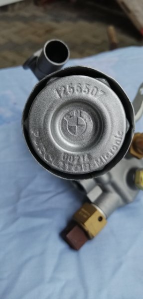

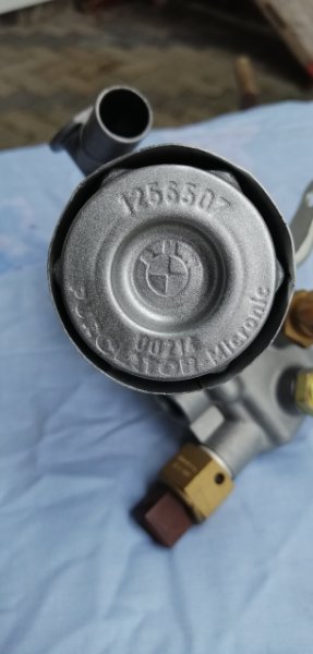

That part is the manifold pressure sensor @Fritzie

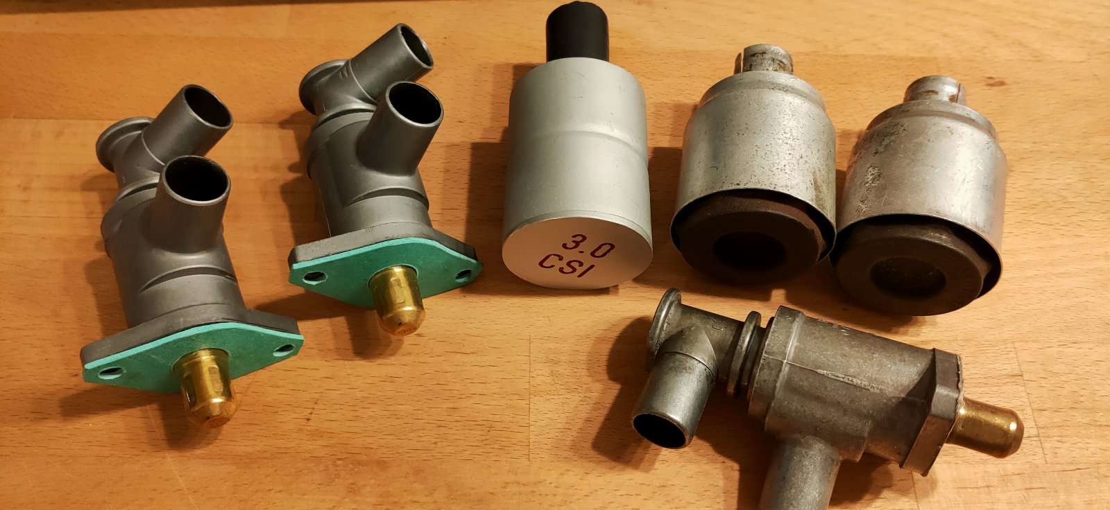

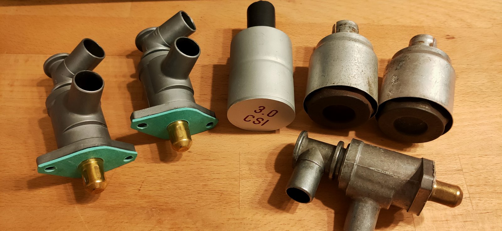

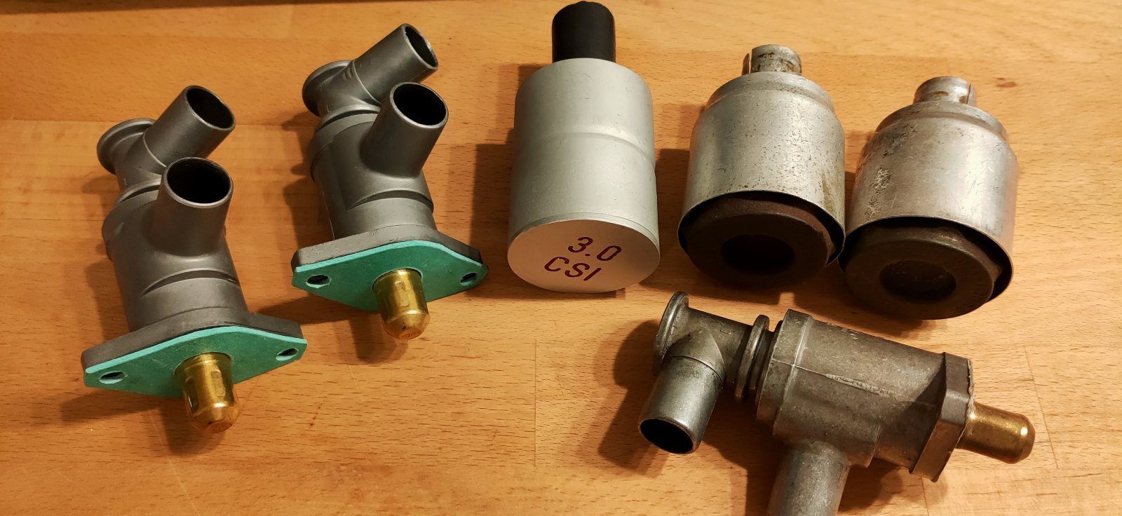

@ocra67 is looking for an AAV - additional air slide valve for cold idle enhancement.

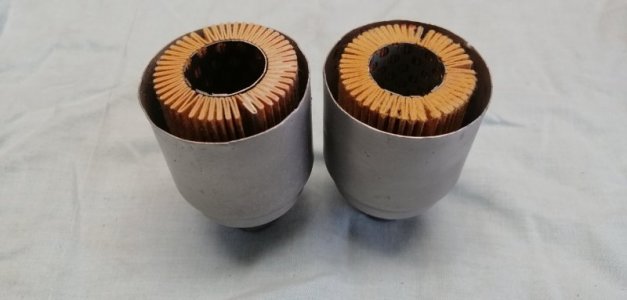

A member of the german forum offers the overhaul of the ZLS (ZusatzLuftschieber) with new expansion elements:
Last price was about 320 Euro if you bring in your ZLS.

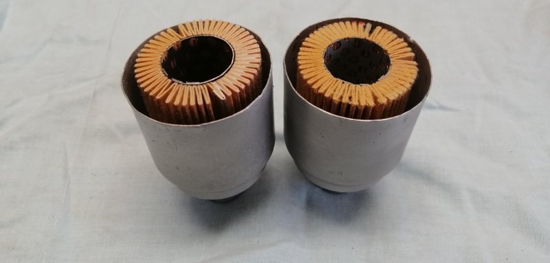

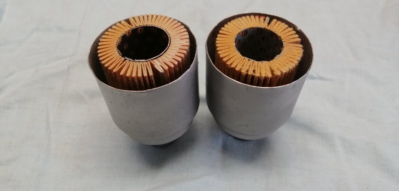

Furthermore he offers new filter housings and new specially made filter elements for the original housing.
Last price was about 150 Euro
If you are interested I may assist you.

I see Bosch nowadays remakes them instead of repair.
https://www.bosch-repair-service.co...hrdruckfuehler-pressure-sensor-0280100030001/
Check the numbers by yourself please.

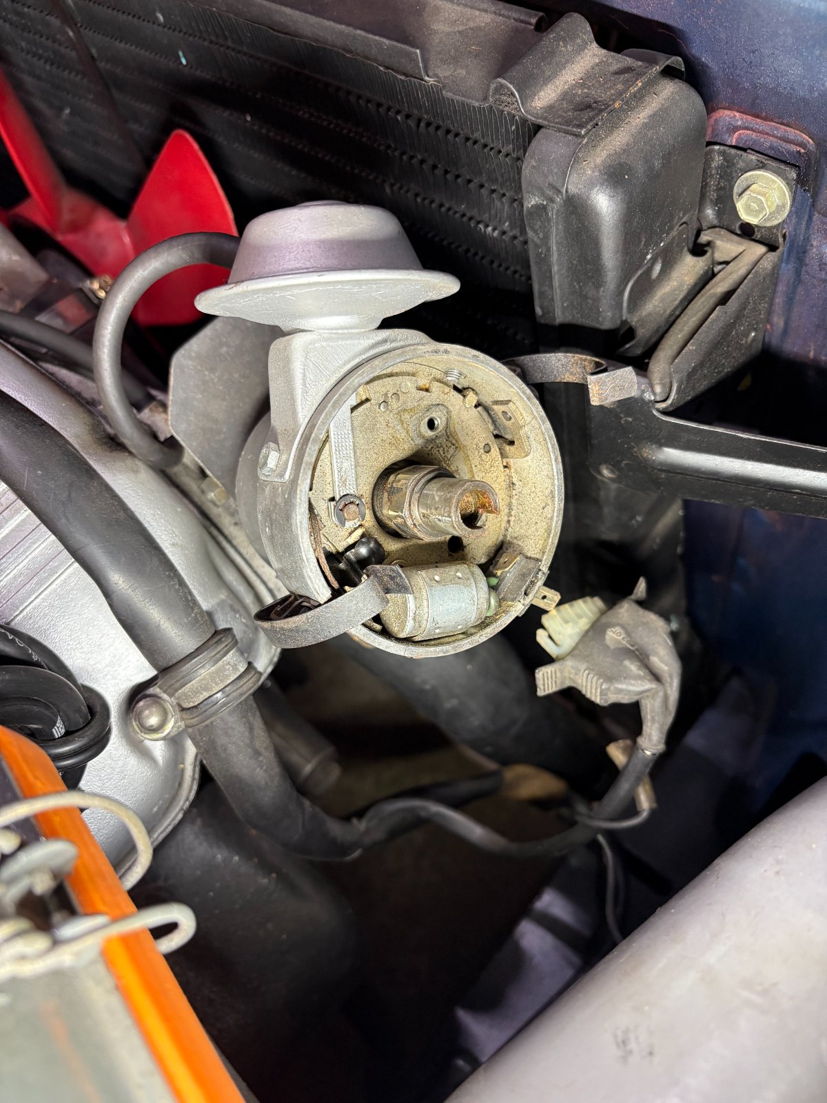

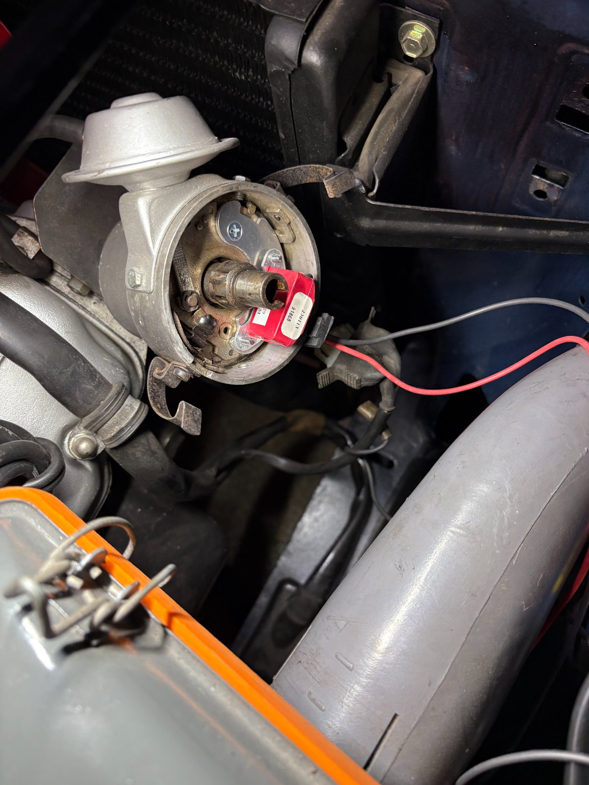

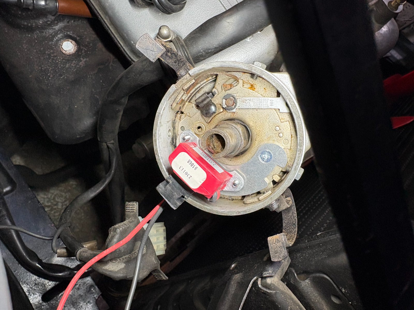

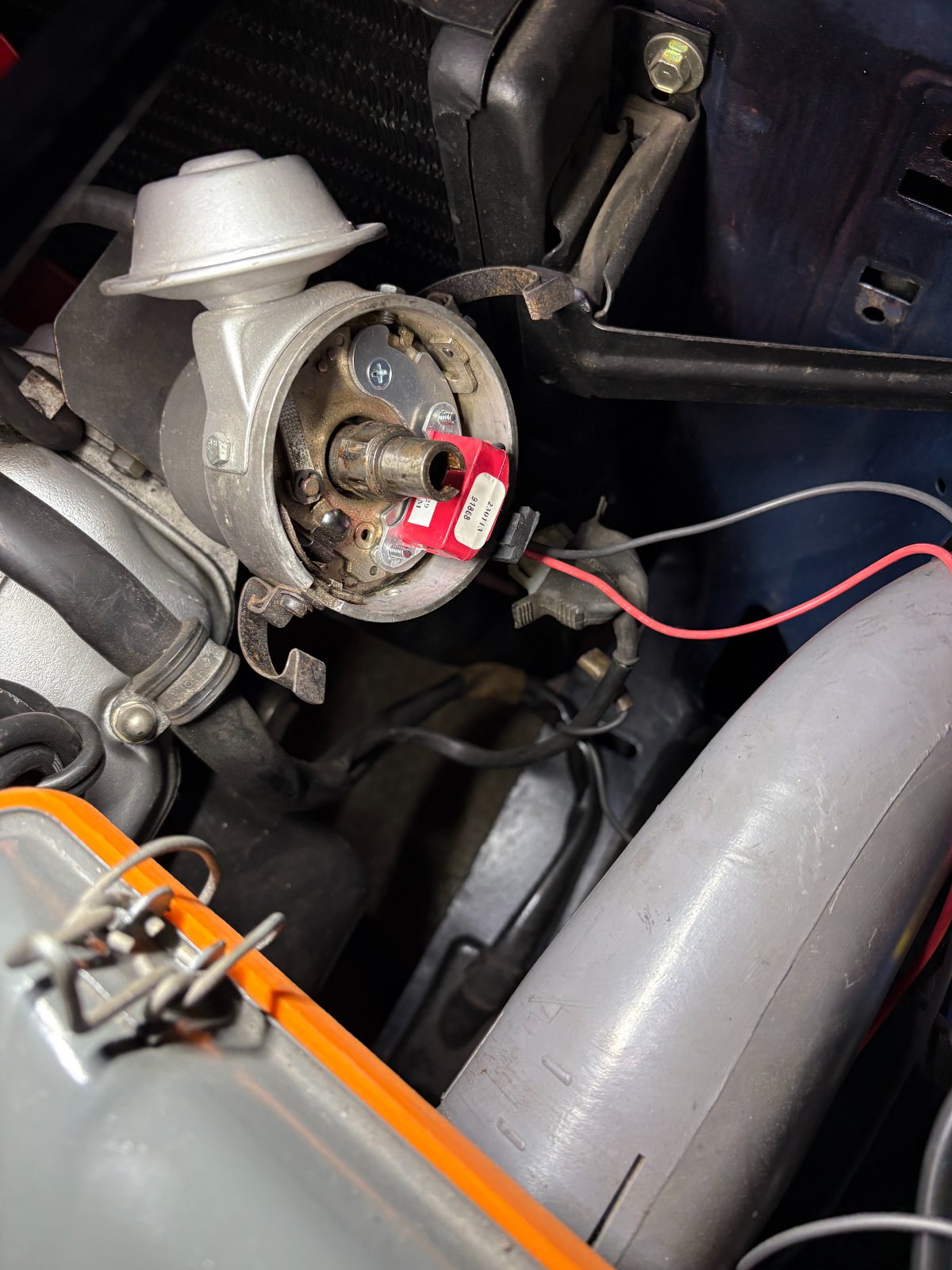

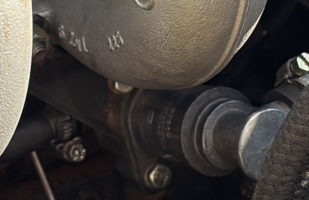

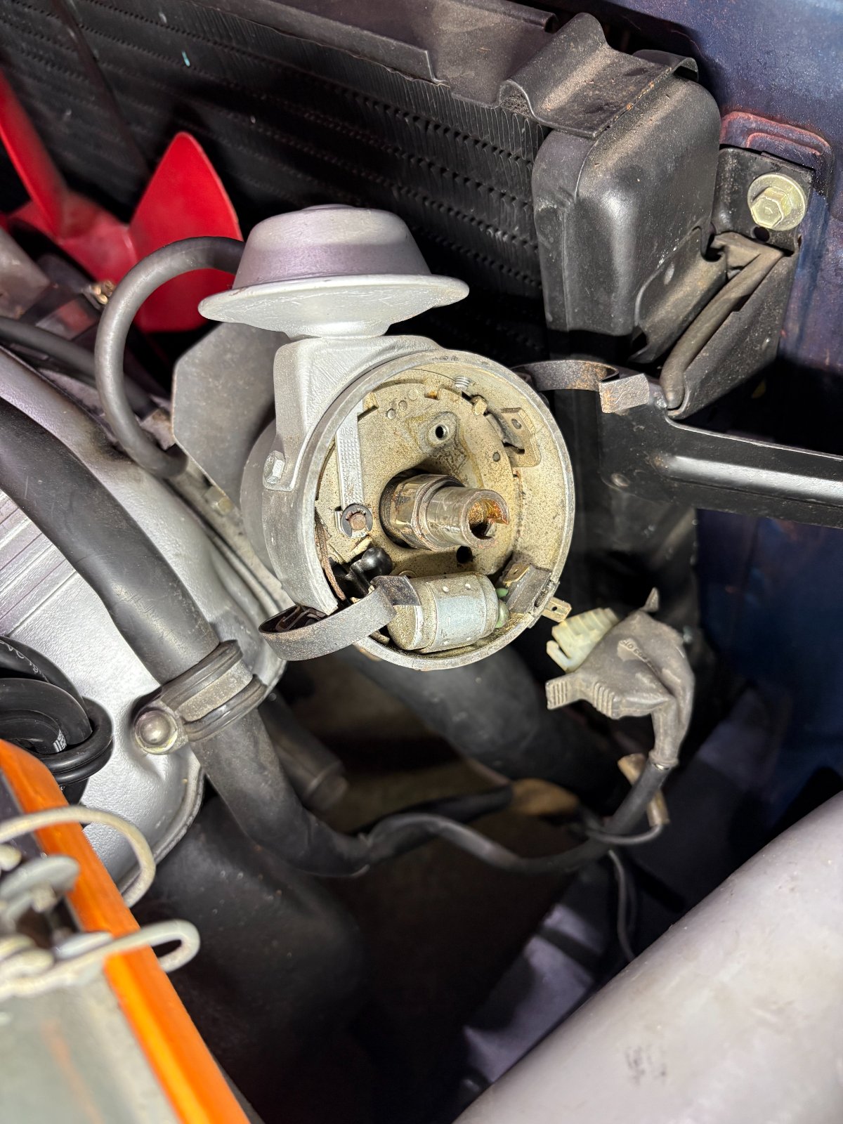

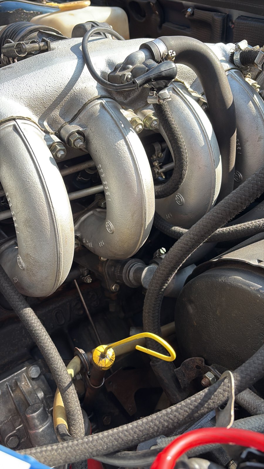

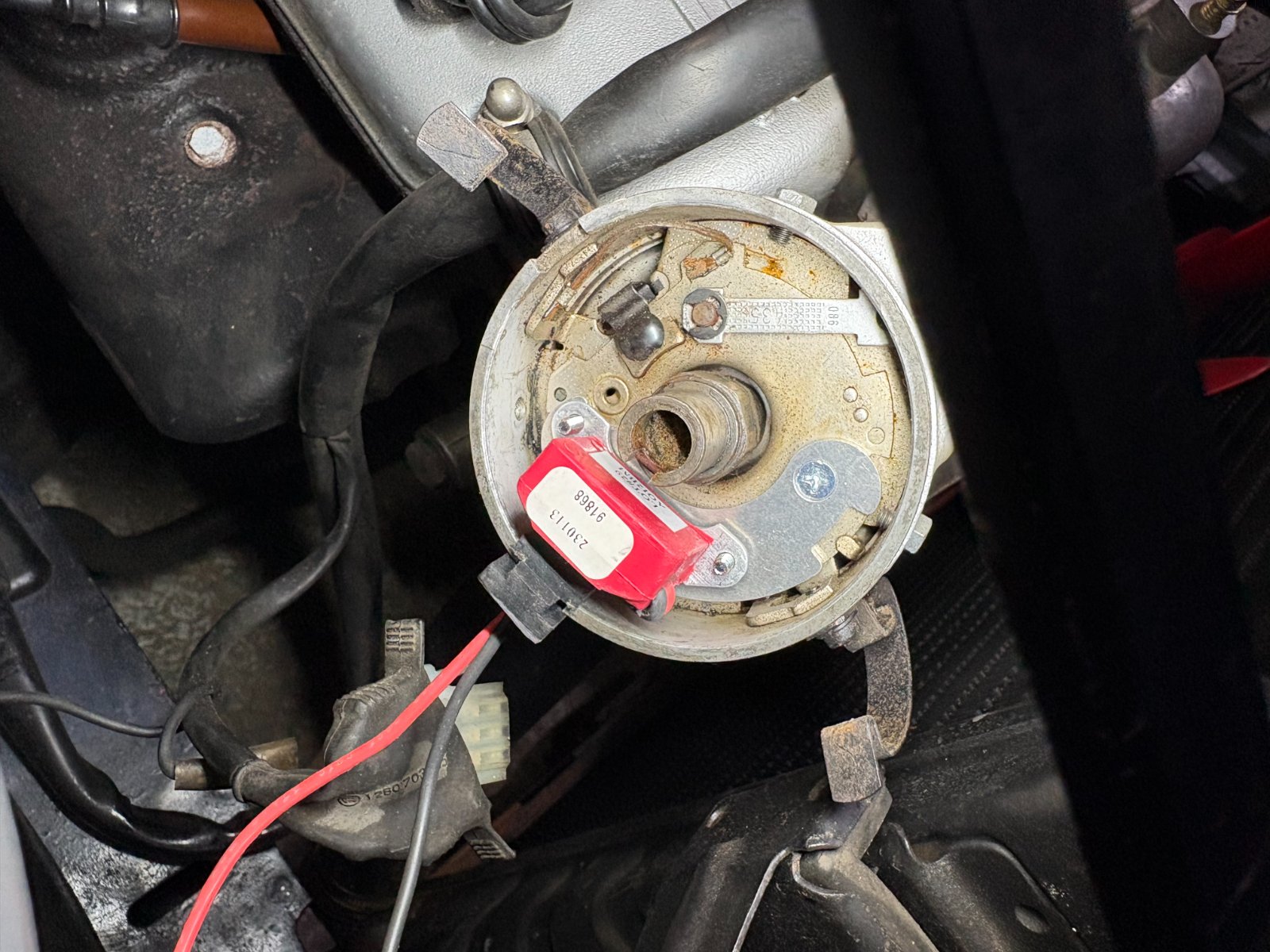

Hi guys,
Just wanted to share my experience last weekend. It may be useful to some facing the same issue, and probably save time and money:
I was thinking to remove my AAV, send it up to the repair shop we talked about in this thread, because the car had a terrible idle, would stall, and do the "sawing" (reving up and down)... and so on, until car would be "warm enough".
In the meantime, I had ordered from Pertronix the Ignitor II and the corresponding Flame Thrower II coil, which I had received a few weeks earlier.
Last weekend, I thought: I will start with the Ignitor, and if I have time, dismount the AAV, and send it for overhaul.
To my big big surprise, when I successfully finished the Ignitor + Coil mounting, I started up the car, just to m
to make sure (sorry...) the engine would start normally, well it ran perfectly. So I waited a few minutes to eventually get to the sawing.... And it never happened!!! The idle went down to where it is supposed to be, ran smoothly, and even the engine noise, even the fumes smokes were different. No more sawing. I drove it something like half an our, getting it to the "fatal read light"... It was "healed".
Well... all this to tell everyone who is planning to dismount the AAV: have you, if not installed an electronic ignitor, checked and tuned up your pin point ignitor ???
Happy ending for me...

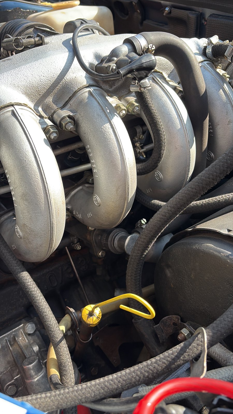

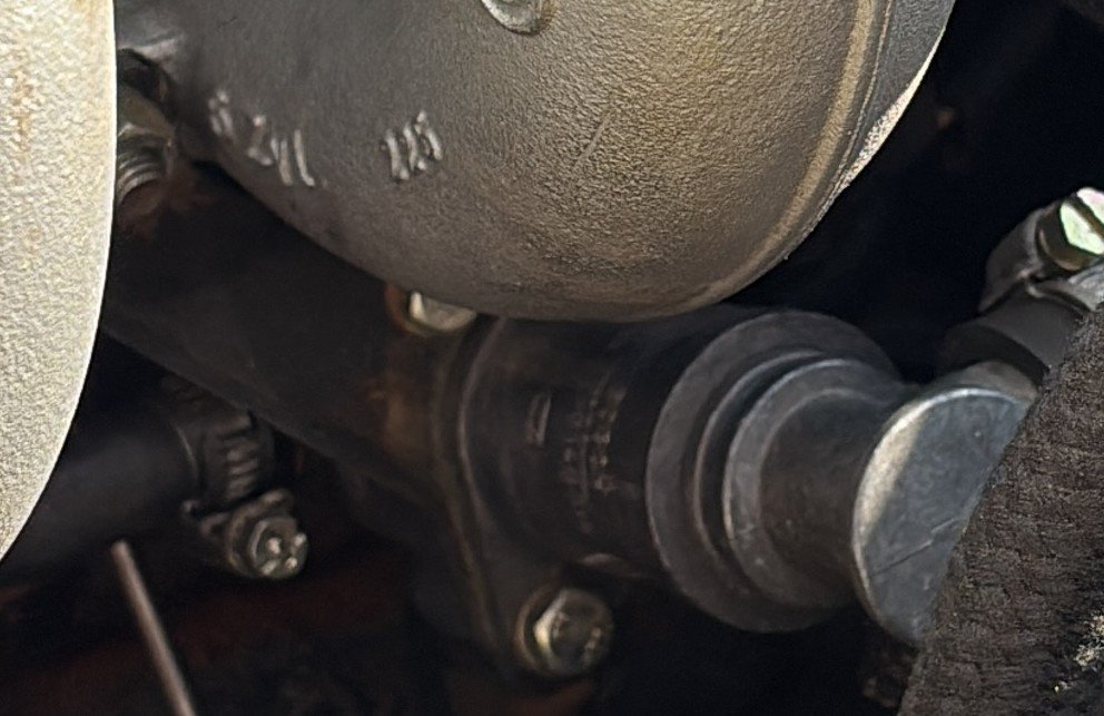

It’s an easy test- large pliers on hose when cold when warmed up.
You will know if it’s working.
