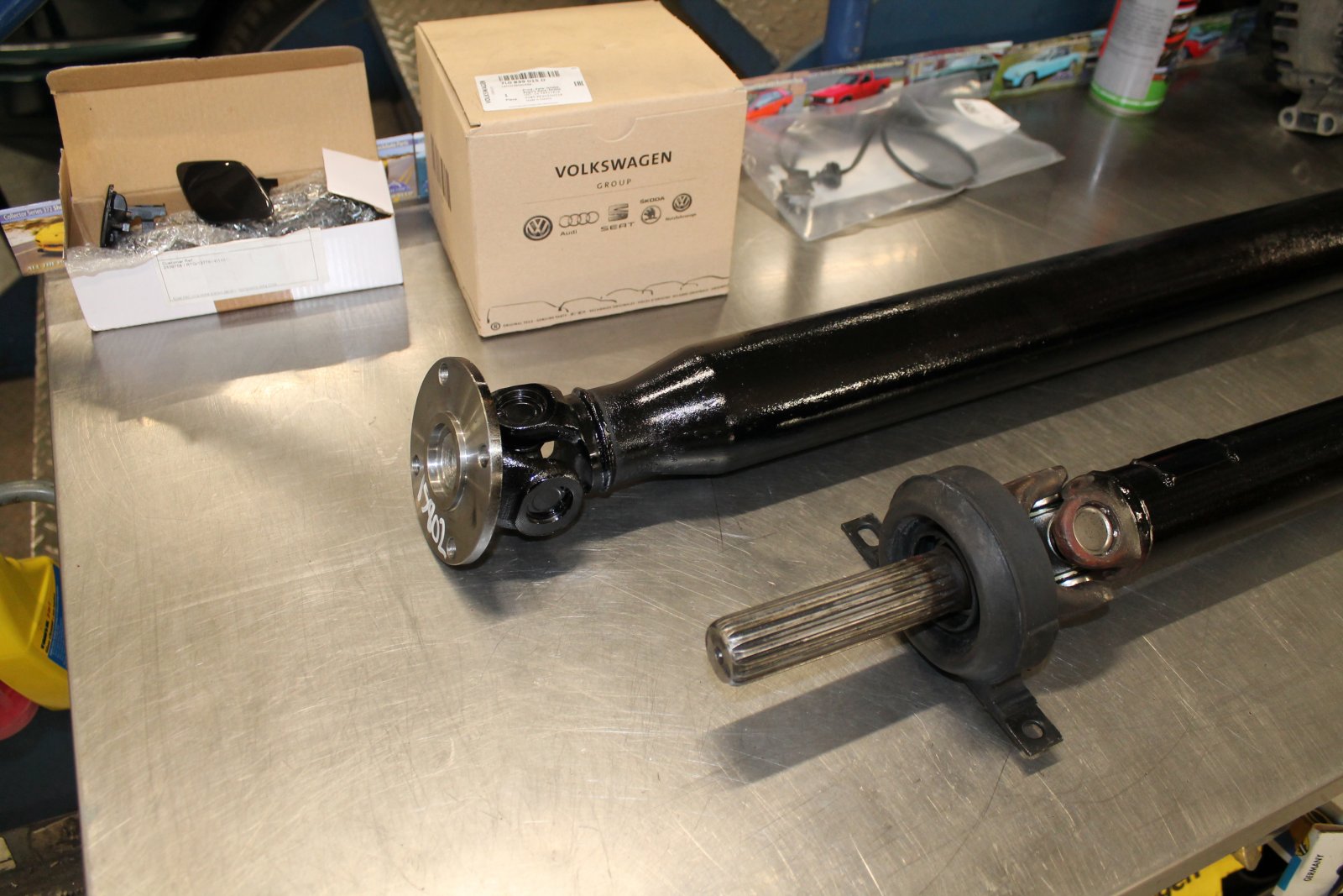

As you can see, some clever person has rendered my prop shaft useless by welding the joints in place.
I believe the part numbers to be
26111206741
26111206534
Any help greatly appreciated.
Sorry, no parts available myself, though some in Germany.

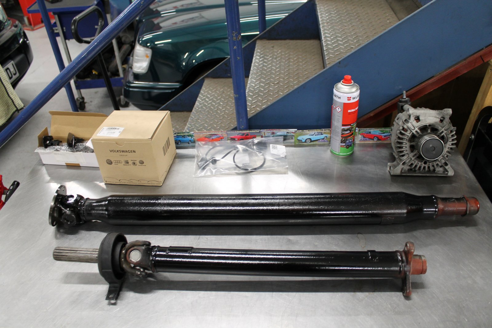

note that differences in the length of the long and short tube exist: measure the length what you now have, and find a matching one.
one that has some dimensions on the pics: https://www.kleinanzeigen.de/s-anzeige/bmw-e9-kardanwelle-automatik-ca-97-cm/2053016605-223-10648
claimed CSI one: https://www.kleinanzeigen.de/s-anzeige/bmw-e9-3-0-csi-kardanwelle/2444752938-223-8996
"Various": https://www.kleinanzeigen.de/s-anze...n-automatik-und-schalter/1771269895-223-10648
How did this ever allow someone to drive?
That is very helpful Erik, I was not aware of this website, very greatly appreciated.
In the end, a very helpful propshaft speciliast just ouside of London fit new UJ's and a centre mount for me, balanced and painted the whole assmebly and then replaced the junk coupling.
