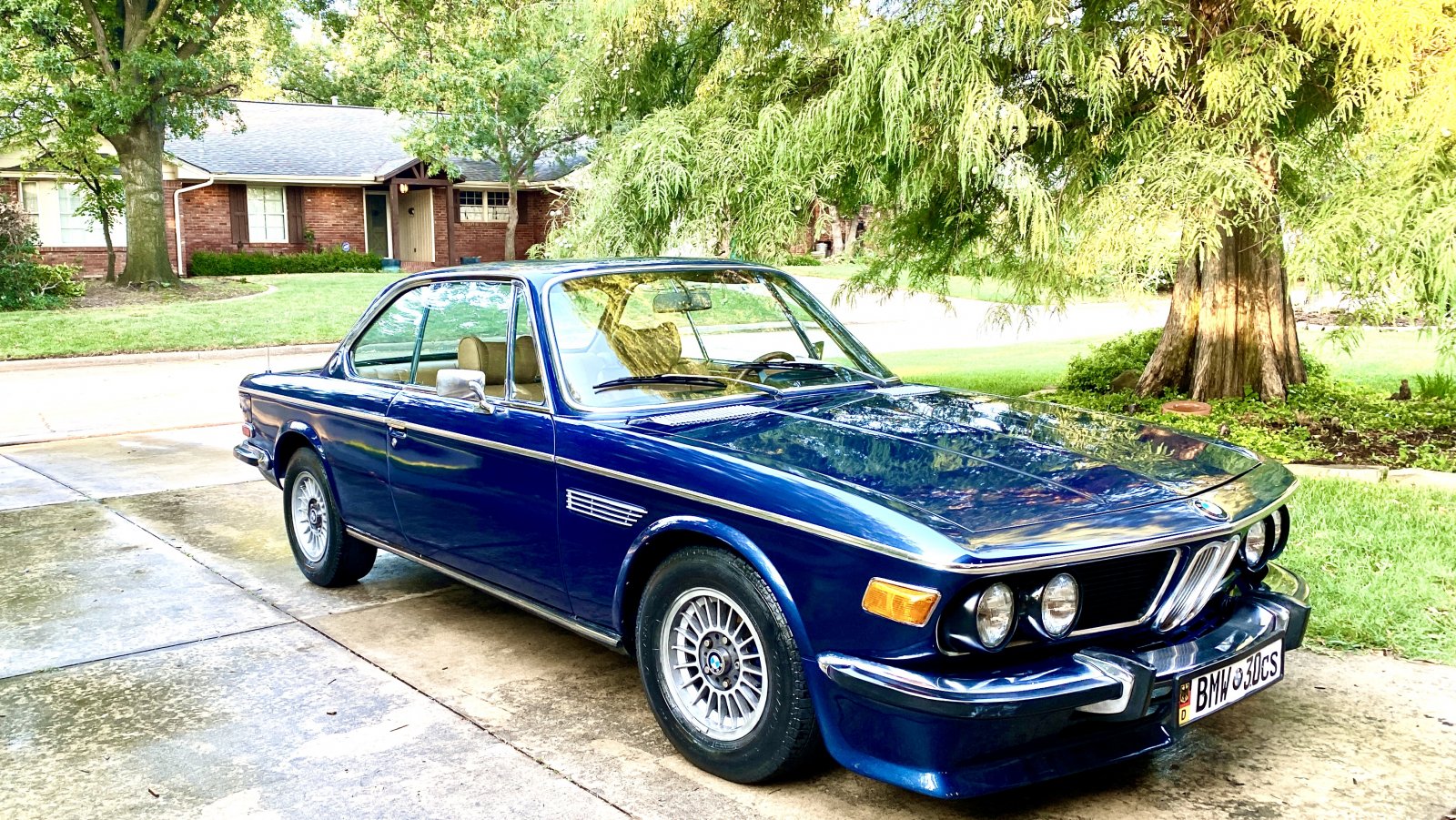

Howdy - in final stretch of resto and looking to replace the ac compressor on my 74 e9 3.0cs. If anyone has a good one - rebuilt is fine too - please let me know.
Also - if anyone has a good resource to buy one domestically I’d be grateful for the info. as well.
Thanks as always. -Tom
