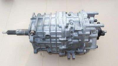

OK I have just pulled the trigger on the one that @frogisland suggested after a lengthy discussion - It will come with the correct bellhousing, clutch fork etc. and shifter mechanism.
Seller is located in Lithuania of all places - he says that it came out of an E12 despite having 230k KMs on it (140-145k miles), it doesn't need anything other than a cautionary set of seals before installation (I know these transmissions are very strong, but is that even possible?!). He did show me a photo of the drain plug undone and some of the oil draining out of it which looked fairly healthy and free of swarf.
I won't divulge what I paid but if that's true then I'm happy. I will also renew the shifter / gear lever bushes as a precaution - I believe there is a "prep" article covering the work that needs to be done in the tech section.

I’m in your ballpark with bellhousing and clutch fork AND including shipping from Lithuania to the U.K. - Seller assures me the box was quiet in use and all I need to do is a precautionary input & output shaft seal renewal. He sent me lots of pics including one with the oil drain removed and a sample of the oil that came out of it - He was great to deal with and has another on ebay as I write this so I will publicise his email address in the parts section for others to follow up on if they wish.
What clutch plates will fit this? The E12 528i ones I can find are stupid money, I’m sure others that are more reasonable would fit?
I managed to find a new Sachs pressure plate and LUK release / throughout bearing for about £55 delivered which is a score!
