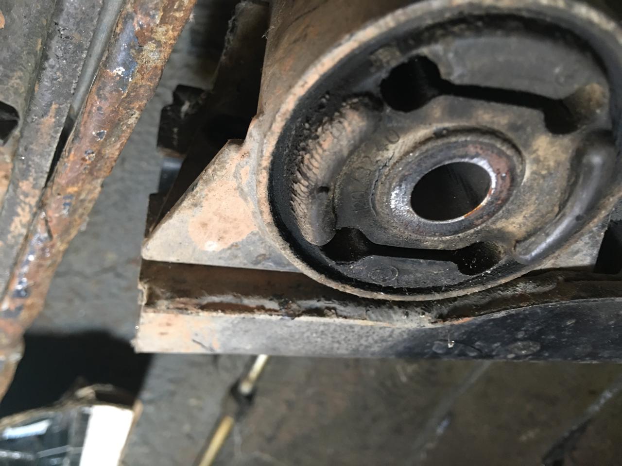

Hello friends,
Anybody know where I can buy 2 quality of these in the USA?
W&N is another option, but I need them by next Wednesday.

Do you want those or the solids or go with the fingers?

Ireland Engineering sells poly-based subframe mounts.....or at least it is listed on their website. Anybody use them? I replaced the standard mounts on my E24's with poly bushings and it did not harshen the ride but did tighten up the back end.
I too bought originals a while back from the dealer, just assumed now NLA. I did do the IE finger bushing thing mostly cause of the location of all the cracks in the original, clearly the rubber fatigued around the holes so logic was to decrease motion in these areas. I think the original design was suppose to give and lend itself to a nicer ride.
Alberto check part # 3321137564. I think they are still dealer available the BMW parts list shows "66-"81. You can find it on Realoem under the "rear axle" subtitle. The number I gave you is from a early 6 series but I think they are the same
