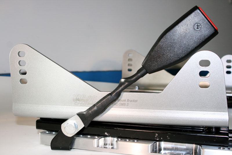

Who’s done it? I am wanting to modify front belt receiver so that it ‘travels’ with the seats as seat is slid forward. Presently mine is anchored on the transmission tunnel and I’d like to get away from that configuration as I am presently renovating the seat belts.

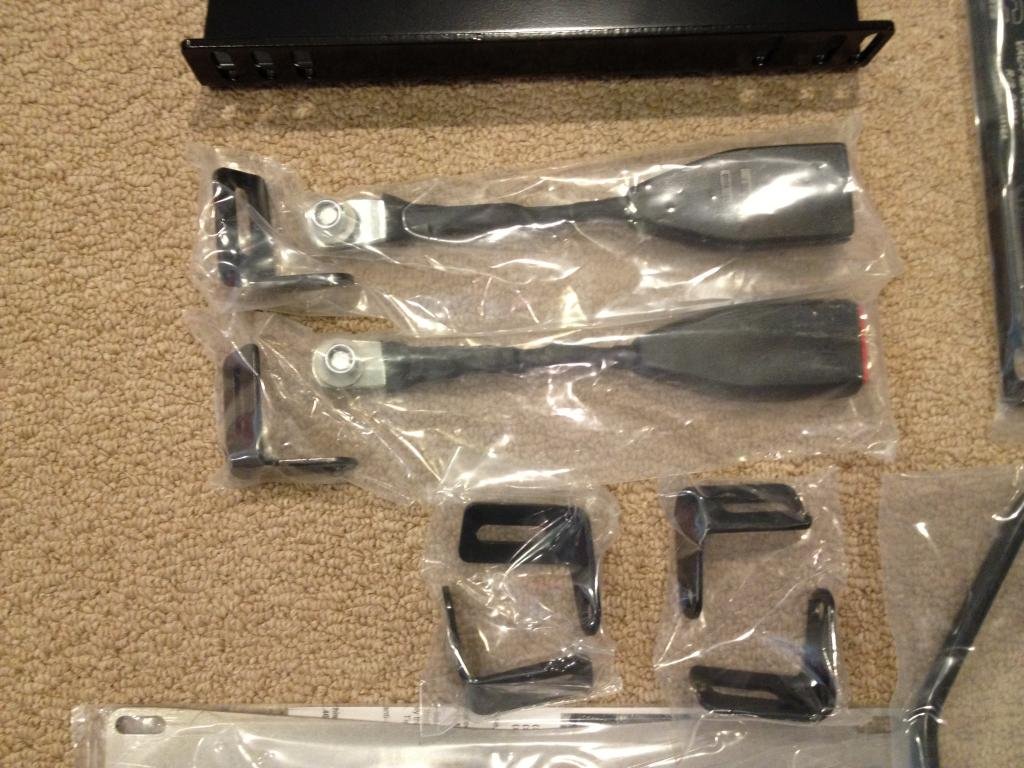

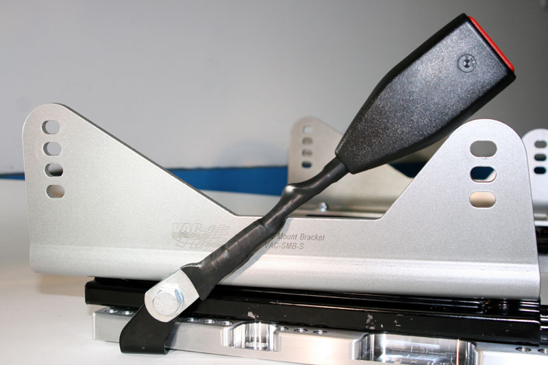

VAC Motorsports caught my attention with kit pictured below.
Seems their bracket could -
1) sandwich between the seat and the rails and so ‘travel’ with seat or
2) between the floor mounting frame and bottom of seat rails for ‘non-traveling’ receiver – but in effect moved forward and off of the tunnel.
If anyone has successful experience and kit source I much appreciate your advice!

Seats mount to sliders and to floor with m6 bolts, I wouldn’t trust my belts to those bolts.
Exactly! Modern cars' "travelling" shoulder harness latches are part of a well-engineered, well-tested system. They've been designed using finite element analysis and then crash tested under a variety of conditions. So yes, you can just bolt the harness receiver to the seat and hope for the best, but keep in mind that your life does depend on it.
My 2 cents
My concern is that E9 seats are not anchored very strongly to the floor. The rear bolts and nuts are quite small and might rip out of the seat riser structure in a big crash. The original anchor to the tunnel is much stronger and serves to keep both the occupant and the seat in place.
If you updated the seat to floor attachment and the seat base itself then I think you could easily adapt the latch part to attach to the seat frame/base ... and not decrease the level of safety.
John
As a crash test safety engineer i can confirm; 'bad idea' ...
I've personally witnessed a full scale crash test of a very, very cheap car. Pulled the M12 fine thread bolt right out of the floor pan, sending the passenger adult dummy right through the windshield.
Having disassembled my e9 seat rails for fresh zinc plating, i know them in fair detail. I am quite certain they dont hold.
In a crash the seat will have to carry a load of (roughly) 25 times your mass+seat mass. Say 100 kgx25 is 2500kg, or 24500 Newton, or 5500 lbs.
I would think that you could install a short seat rail next to the original rail using larger bolts and somehow improvise a slider into the rail track. You could also connect the new rail to the original rail and use the same holes with larger bolts.

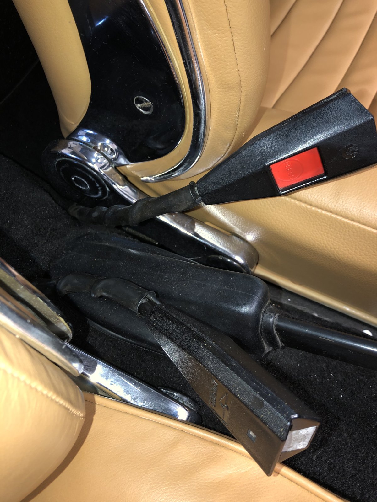

Those of you having the front seat belt receiver of the flexible cable structure - about how long is that assembly from its 7/16 hole to receiver end. With the front seat adjusting forward to rear about 10" and the receiver being fixed length it seems problematic.

Follow-on question -

This style? 18”
