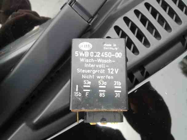

Hi all, is there any where we can get the wash wipe relays from? Or is there a generic one we can fit?

Thanks for offer of finding me one of your relays, I have however found a new one from from
Walloth Nesch, thanks for you offer any way.

At 104 euro each new, I would think you are sitting on a couple of hundred dollars with what you have, get them on the Bay for sale.

Fitted new wiper relay today, every wiper function now works perfectly! if your intermittent, or one of your speeds doesn't work and all the switches are ok, I would bet the house the relay has a fault, there is quite a bit of circuitry in the relay that operates all the intermittent timing, wash wipe etc etc
