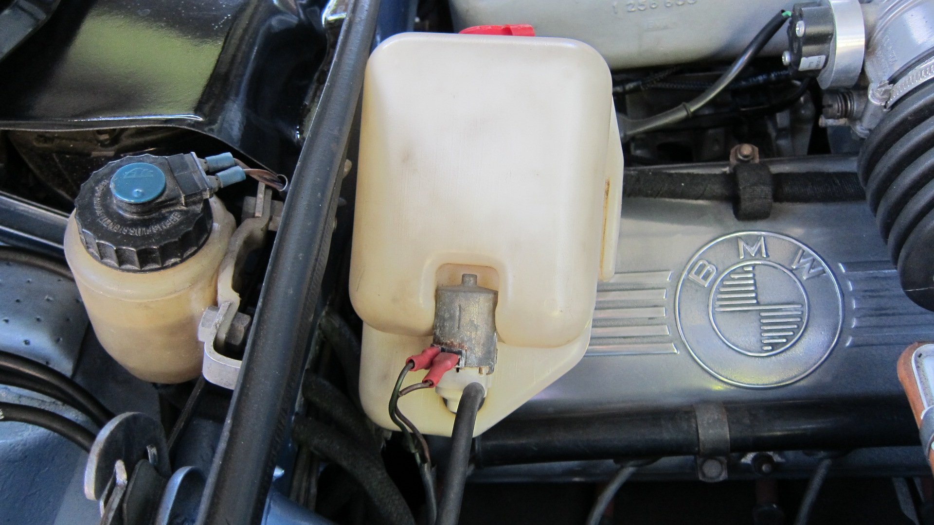

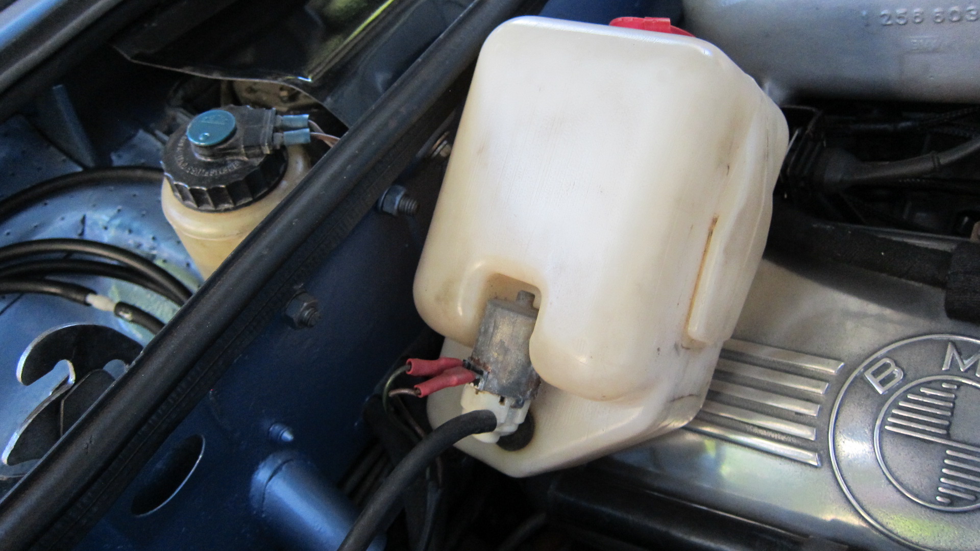

My pump is no good so I need to replace it, luckily I checked before ordering from W&N.
So what have I got, because it looks to me that the replacement part won't fit ?
That does not look like an E9 bottle and pump. Perhaps from NK or e10? The e3/e9 has a flat bottomwith two pegs moulded. The pump fits onto the pegs and and fixed by moving it (the pump) sideways to lock in position.
Open up the pump and make sure the little electric motor still runs. If so, clean the rust from between the two brass gears and the bottom plate. Then polish the plate with some fine wet-dry sandpaper. Reassemble. Off you go...
These pumps frequently stick because of corrosion. I have five or six I can rotate, but prefer to clean the windshield in the garage before I go out.
