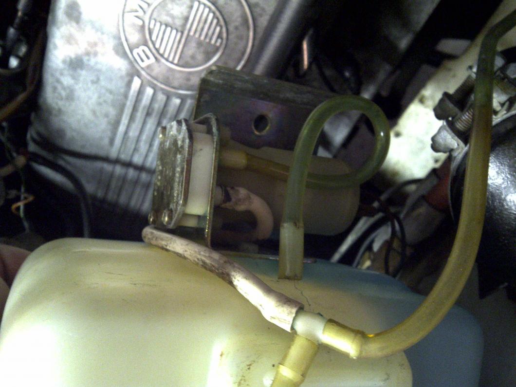

Can someone take a peek and let me know which connector on the pump goes to the reservoir and which one runs to the washer nozzles? The connectors on the pump are marked B and D.
Was doing some engine detailing and discovered a short length of kinked plastic hose that went from B to D. The hose from the washer nozzles was connected to the connector on the reservoir. This setup doesn't make sense to me...

Thanks, Steve. Seems like pre-'74 cars have the "T" connector splitting the flow from the reservoir. Or is that for headlight washers?
No headlight washers, it feeds back into the top of thr resevoir for reasons unknown to me (pressure relief?), the other tube goes to the nozzles. Hmmm...

I would skip the return to the cap, you are pumping water to the jets and the cap, it serves no purpose, it is not an overflow function. Carl Nelson has the clear hose, get it from him. The 2800CS had the metal pipes aimed at the windshield through the hood grilles, 3.0 has the jets on the hood. The dates in RealOEM are not accurate in my opinion.

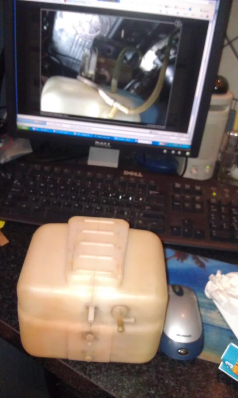

Steve, if the picture looks familiar- it's because you posted it :-), I could not see spending 100.00 for a washer pump that will probably only get used when I have the car inspected so I bought one for 15.00. seems simple enough, water in - water out, 12 V. going somewhere, but there are only 2 wires so I should be able to figure that out. Thought I would poke around on the forum, then saw your tank- I presume, though I don't see any tanks like mine- that second fitting is just an "attached elbo?"- It does not lead to the tank, and I do not have an overflow hole in the cap big enough for a hose, just air. Did someone over-engineer, or did this come from the space shuttle?

In regards to the return hose through the lid of the tank, if you look carefully at the parts diagram you will notice a "jet" attached to the end of the hose inside the tank. This acts as a pressure relief (restricted by the small jet orifice inside the tank) in case the main cleaning jets are plugged by dirt, ice, etc.
What Peter shows is the later design where the elbow on the bottom of the tank incorporates the small pressure relief orifice directly into the tank. Cars with headlight washing/wiping systems have two such "elbows" under the tank:

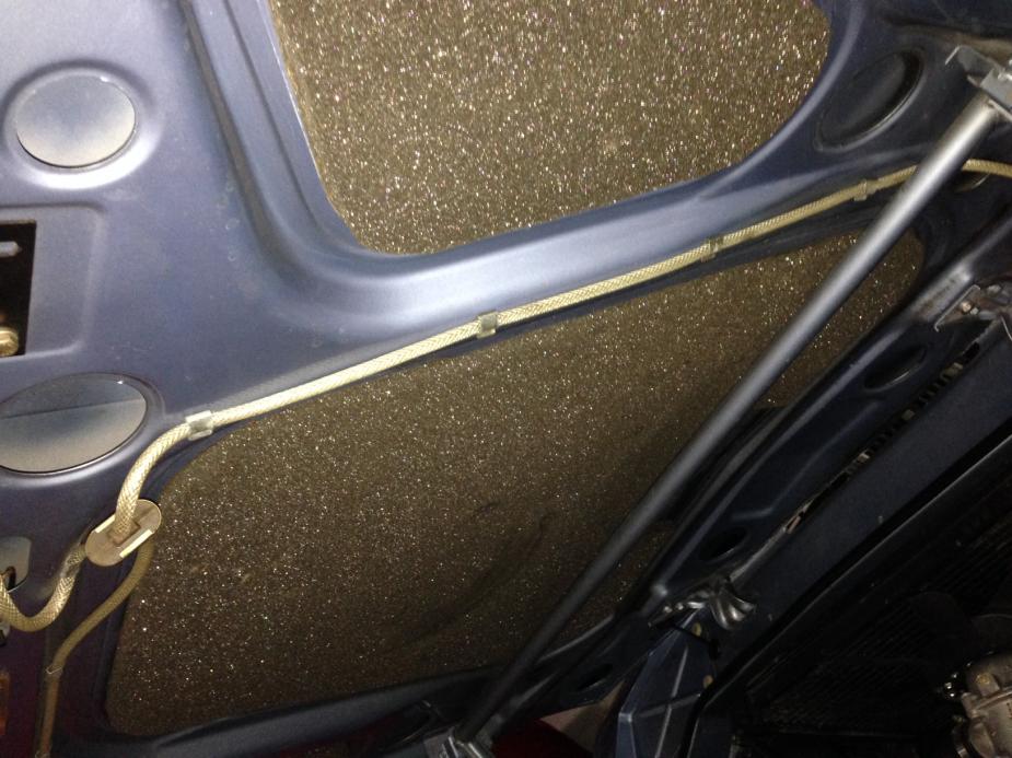

Here are a few showing the routing from the hood to the washer reservoir:
