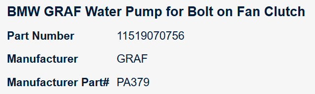

Yes, it has a metal impeller but it does not match that part number? The numbers are as follows PA379, Adaptable for OES: 11511253143, 11511263934, 11511706236, 11511705273, 11511707414, 11519070757 are the part numbers.

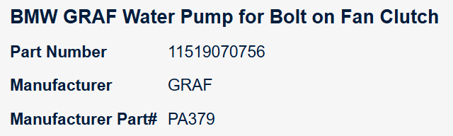

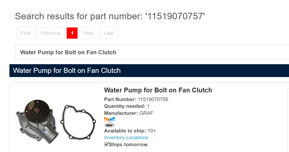

The last part number in RMEuropean shows GRAF with manufacture pn PA379
EDIT: You can Google GRAF PA379 and also find the same pump.
If you click on fitments in the link below it shows the 2800CS
If your mechanic wants to only use "BMW" then you probably don't have an option.
