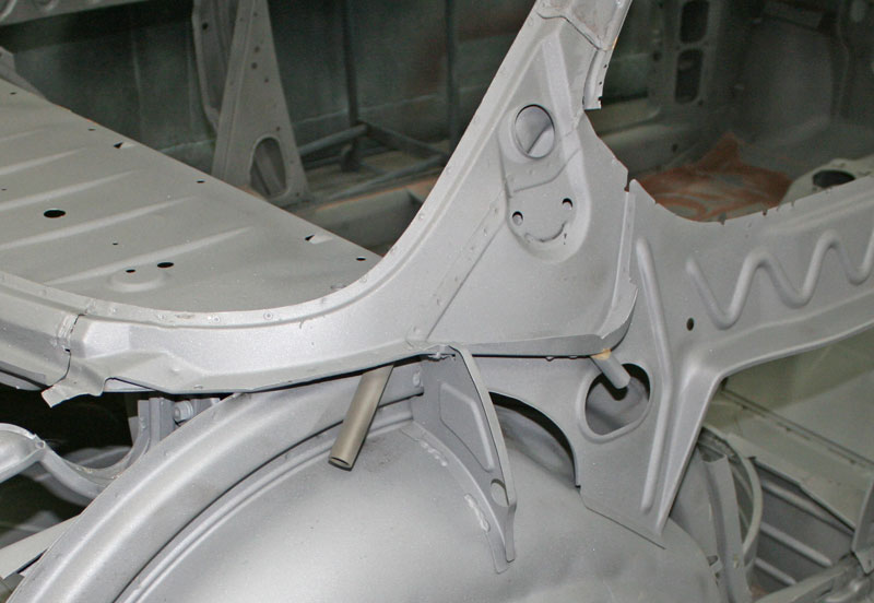

Only things not mentioned yet....Antenna? Sunroof drain hoses? Pic stolen from Sven

So I redid the water test and finally was able to see some water coming in. The water is seeping in just forward of the trunk opening drivers side, close to where the c-pillar air vent is, next to the trunk lid hinge. I can't say for certain how it is getting in because the water is following a bit of a ledge before I see it. Having said that I think it is either getting in through the window gasket or possibly the air vent itself. Does the air vent have it's own drain line (seems to be on in the pic)?
I've eliminated the trunk gasket and since I didn't spray any water on the sunroof I'll assume it can't be the sunroof drain.
I'm going to apply some sealant to the window gasket and maybe tape of the extractor vent to see if the leak is eliminated.
BTW thanks for posting the pic of the body, it helps!
