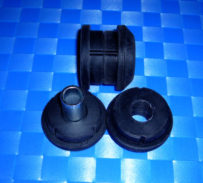

We get asked how to install compliance bushings…

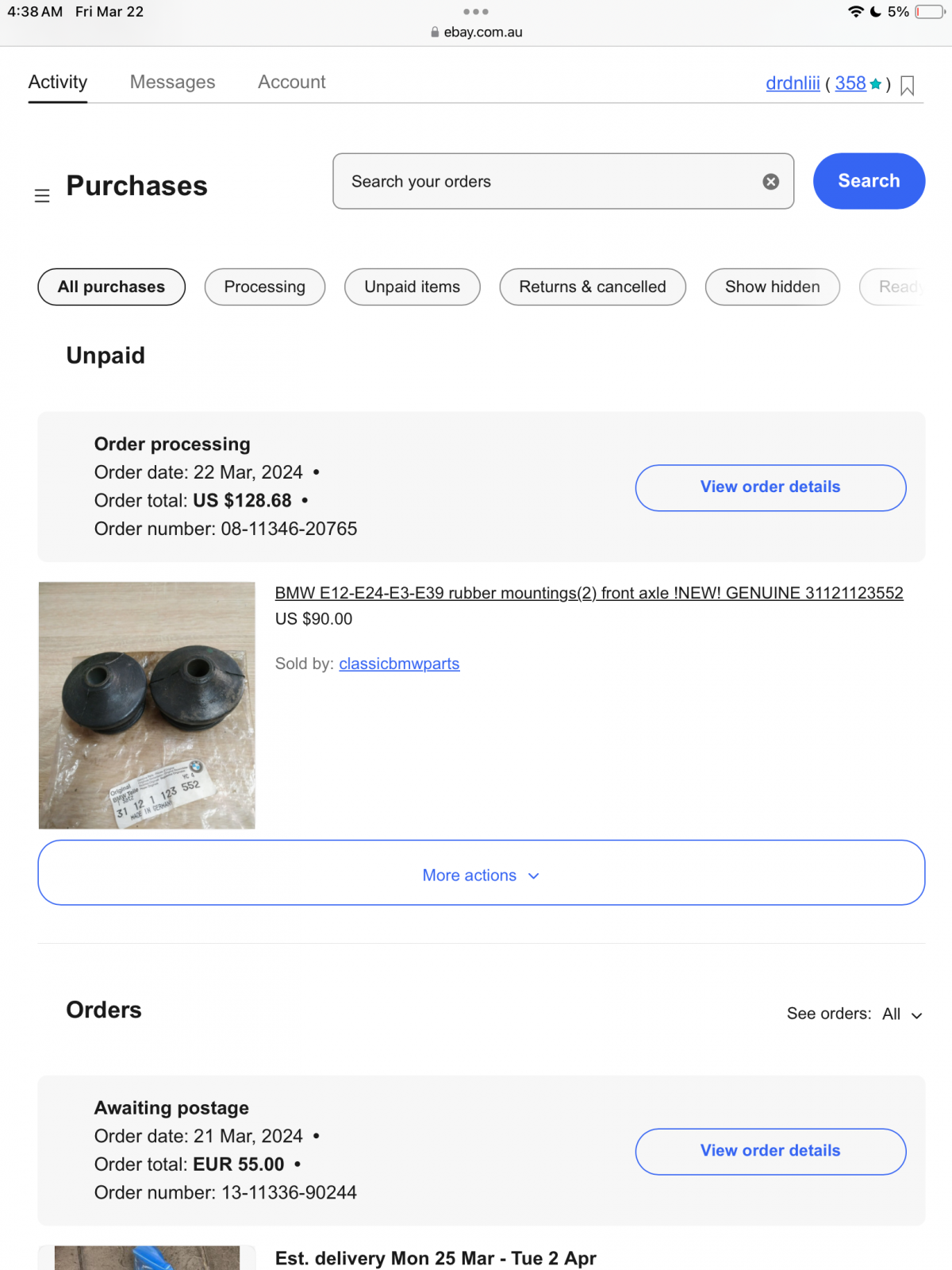

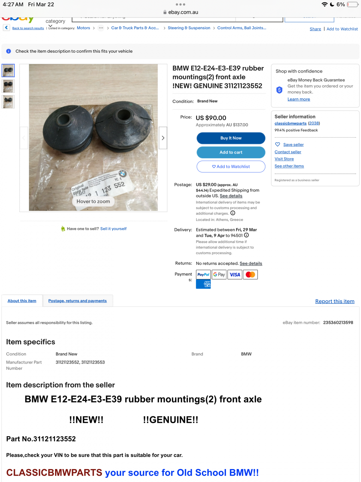

This prompts me to ask - where did you get those bushings? I can’t find the bushings for my E12 (seem like they ought to be the same as for E9s) in stock anywhere.
sfdon
8,291
4,643
sfbay area
From Athens, Greece on eBay a few minutes ago…
very expensive!
