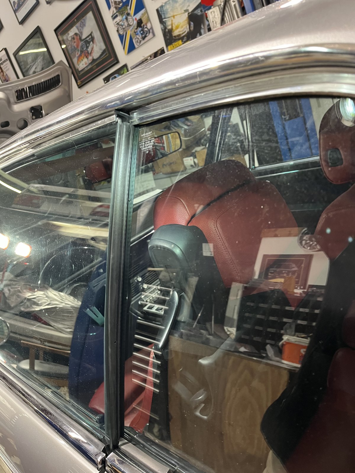

Look what showed up to be used in lieu of the unobtainable BMW back window, vertical rubber seal.
I went with something a little different then that in the first picture that I posted.

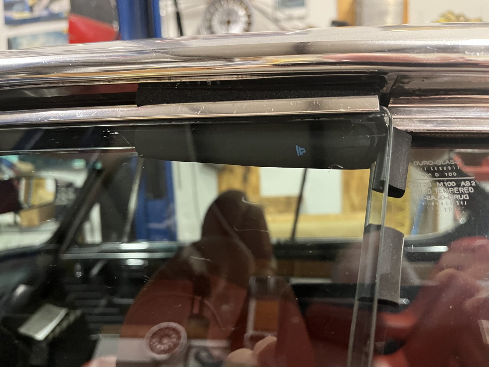

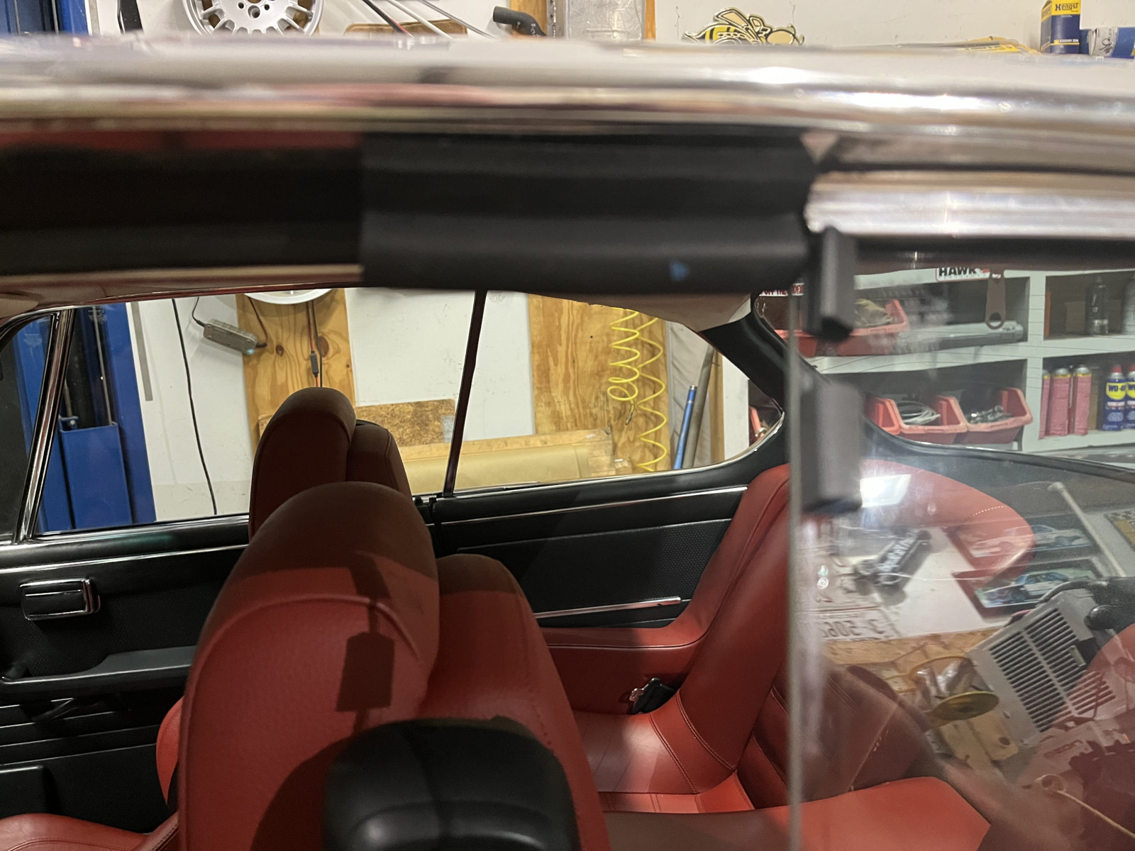

The next use of Steele rubber will be the sample piece that you see at 12:00 position.
My factory rubber split-off from the plastic plate that holds it in place.

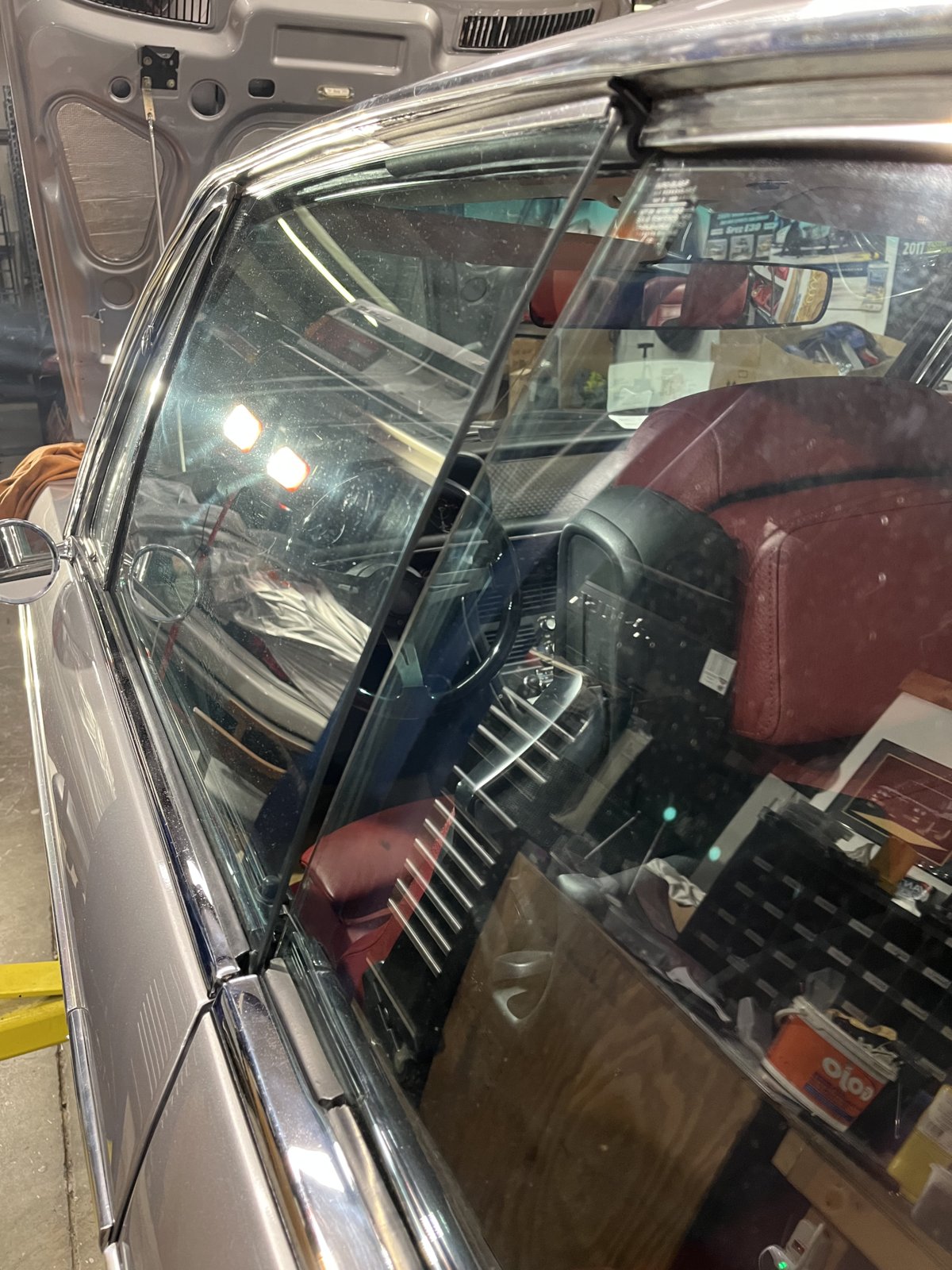

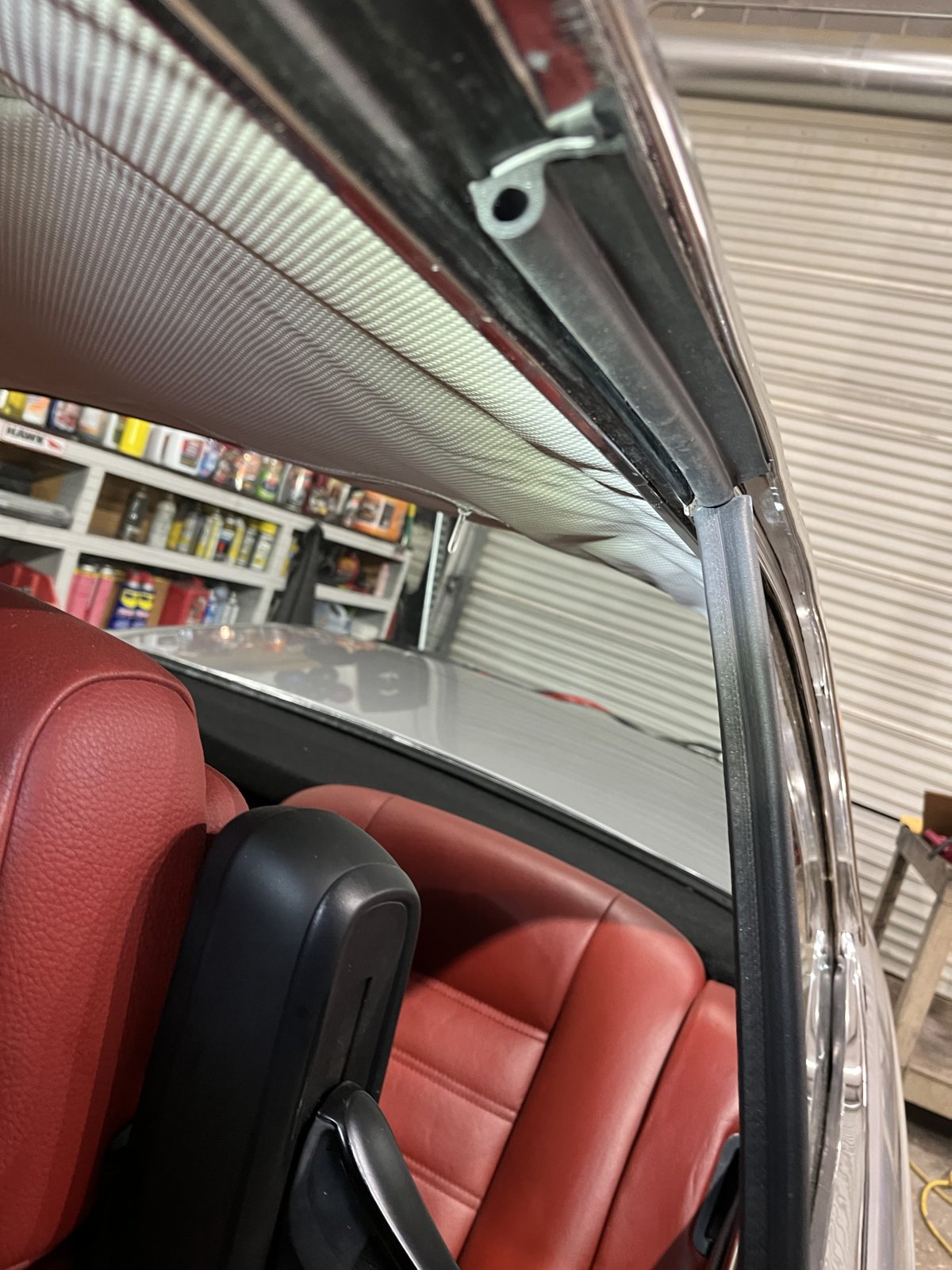

You are welcome. The Steele rubber worked wonderfully. I’m going to try the horizontal- to-the -a pillar piece tomorrow.
