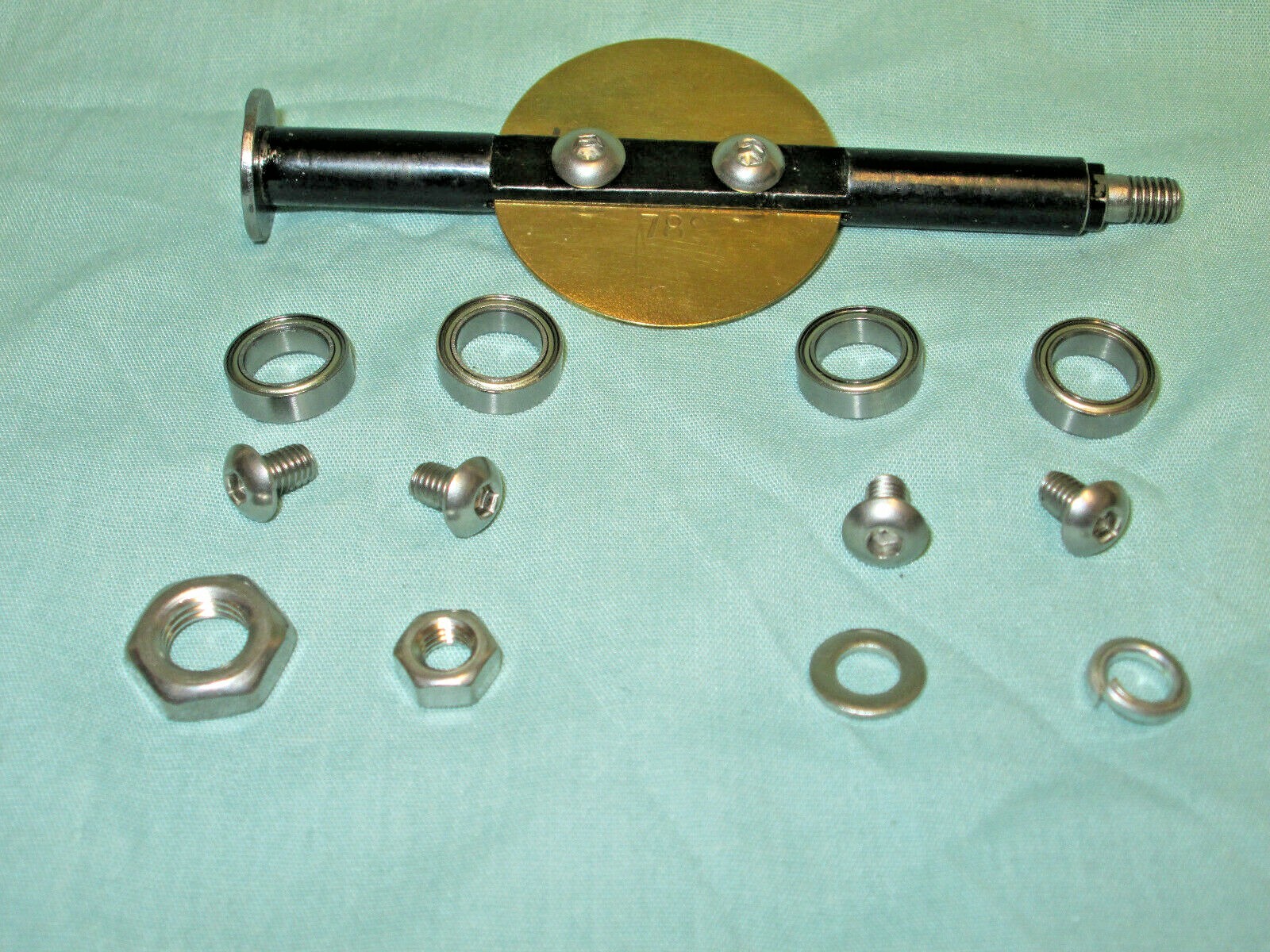

If your primary concern is dealing with worn throttle shaft bores, there are kits designed to address this issue. They may be worth a try. https://www.pegasusautoracing.com/productdetails.asp?RecID=5949
