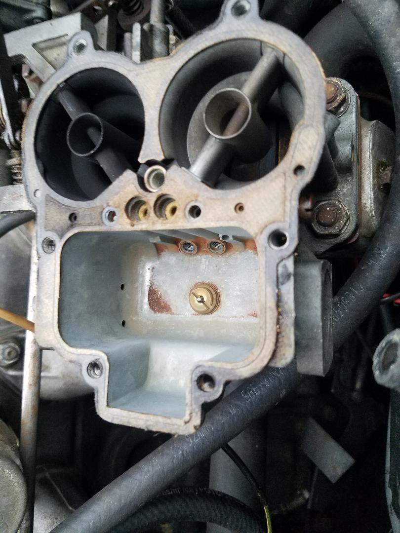

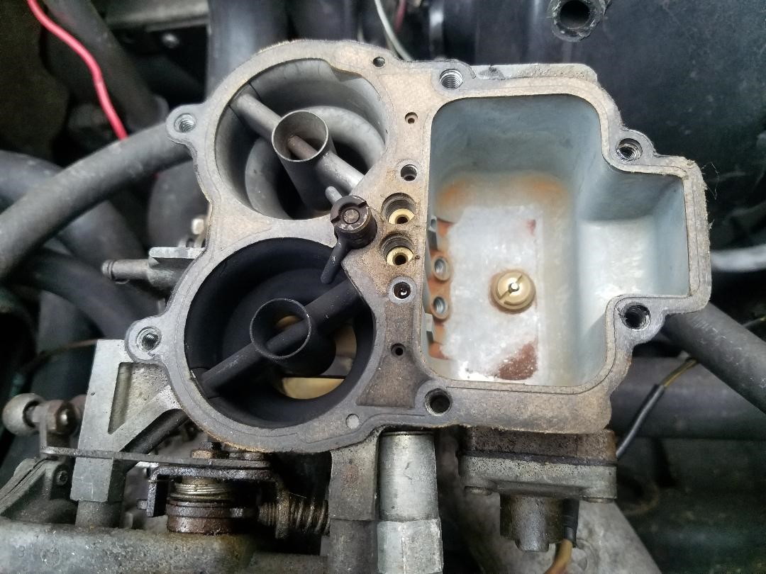

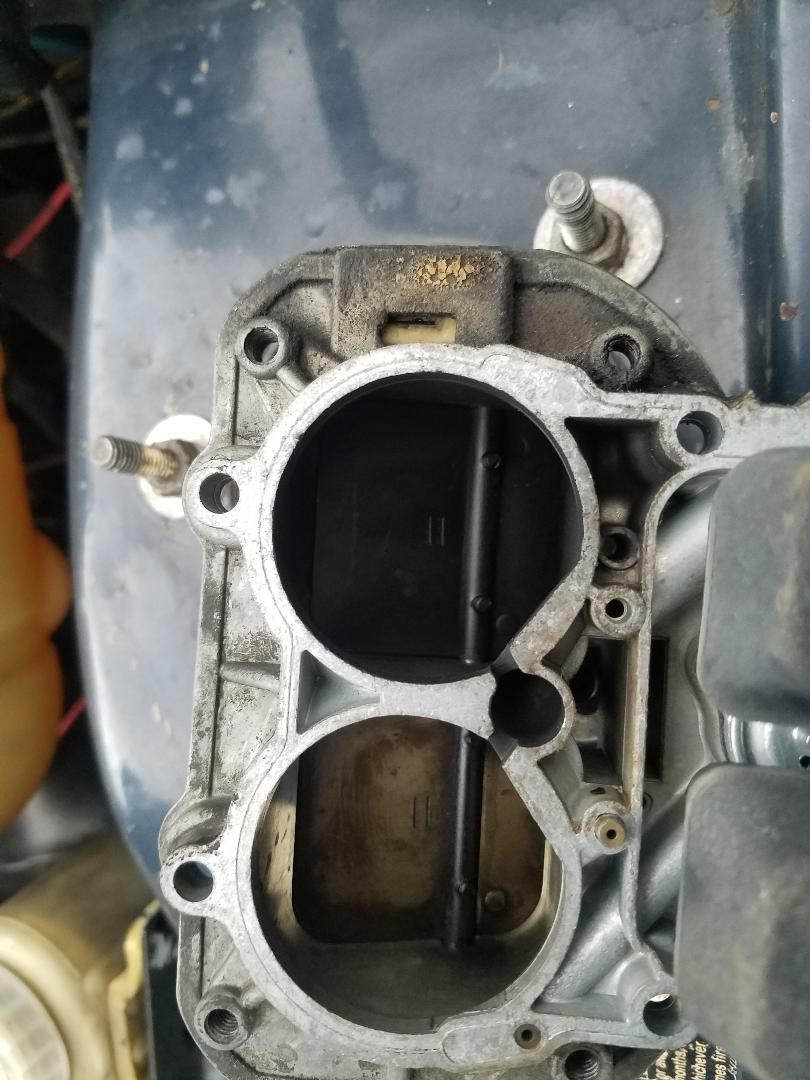

My 73 runs well except at idle. It seems to run rich. I took the top of one carb off and saw what looks to be a black I have worked on Weber's before in the past Oh by the way I have not started my car in 6 weeks, the bowl was completely dry with some dried particles in the bottom. What do you think is causing the problems with my carbs? What should I do? I have a rebuilt kit waiting for me but I want to make sure I get the problem fixed, spring is just around the corner time to drive and have fun. Also the bottom of the float bowls seems a little greasy like old gas. Thanks in advance

That black looks to be from backfiring through the throat.
Do you have an autochoke assembly? If I remember right, these are designed to retract only when warm, so if the coolant passages are gunked up they will not retract and you will run rich at idle (and other times as well).
Given the black soot, the gas residue you describe, the particle deposits in the bottoms of your bowls and the possibility that those deposits are fouling your float valve, I would rebuild and see if that does the trick.
The debris is not de-novo from the carb, you should peek in the tank and also blow out the lines. If all that is clean, why not try a round of Seafoam?

In addition to Ohmess's suggestion (sticky or poorly adjusted choke), the “black” film depicted on what appears to be the primary barrel may also be due to crankcase blowby. How or where is your valve cover breather ducted? (If blowby is ducted to one carb - and not the other, is the non-ducted carb cleaner than the pictured carburetor?)
Fuel has a tendency to evaporate when exposed/vented to the atmosphere. Evaporation after six weeks of exposure is not surprising, especially if sitting in a warm climate. Metal particulates are likewise not necessarily unusual as constantly moving/vibrating carburetor and mechanical pump parts can wear. Running an inline pre carb fuel filter?

I have a new fuel pump and a new in line fuel filter. I am using the stock air filter housing. I live in Maryland and the car sits outside under a car cover. Last year we replaced the cylinder head because the old one had a worn lobe.
This may not be connected to your symptoms, but there have been many useful suggestions for you to follow up and try to solve your problem. In my case, I could not get the mixture for my pair of Weber 32/36 correct. Ran rich. Tried everything you could think of. Then finally removed back carb and found the mixture screw wasn't doing anything at all, when turned. As you may very well know, you make adjustments when warm, and there is really no straight access to the mixture screw, so, when you attempt to make the quarter turn adjustment to match the quarter turn adjustment on the front carb, it is not as precise as you would like as the flesh on your hand has begun to burn as you come in contact with the now very hot engine or manifold or coolant hoses. This masked the fact that the back carb mixture screw was gummed up with the varnish/crud of old gas.
Removed carb, chased the mixture screw thread, flushed with carb cleaner, and found the carb could actually be adjjusted again! Big difference. Dialed in and synchronized for the first time in a long time. Old fuel gums up every carburettor, eventually.
