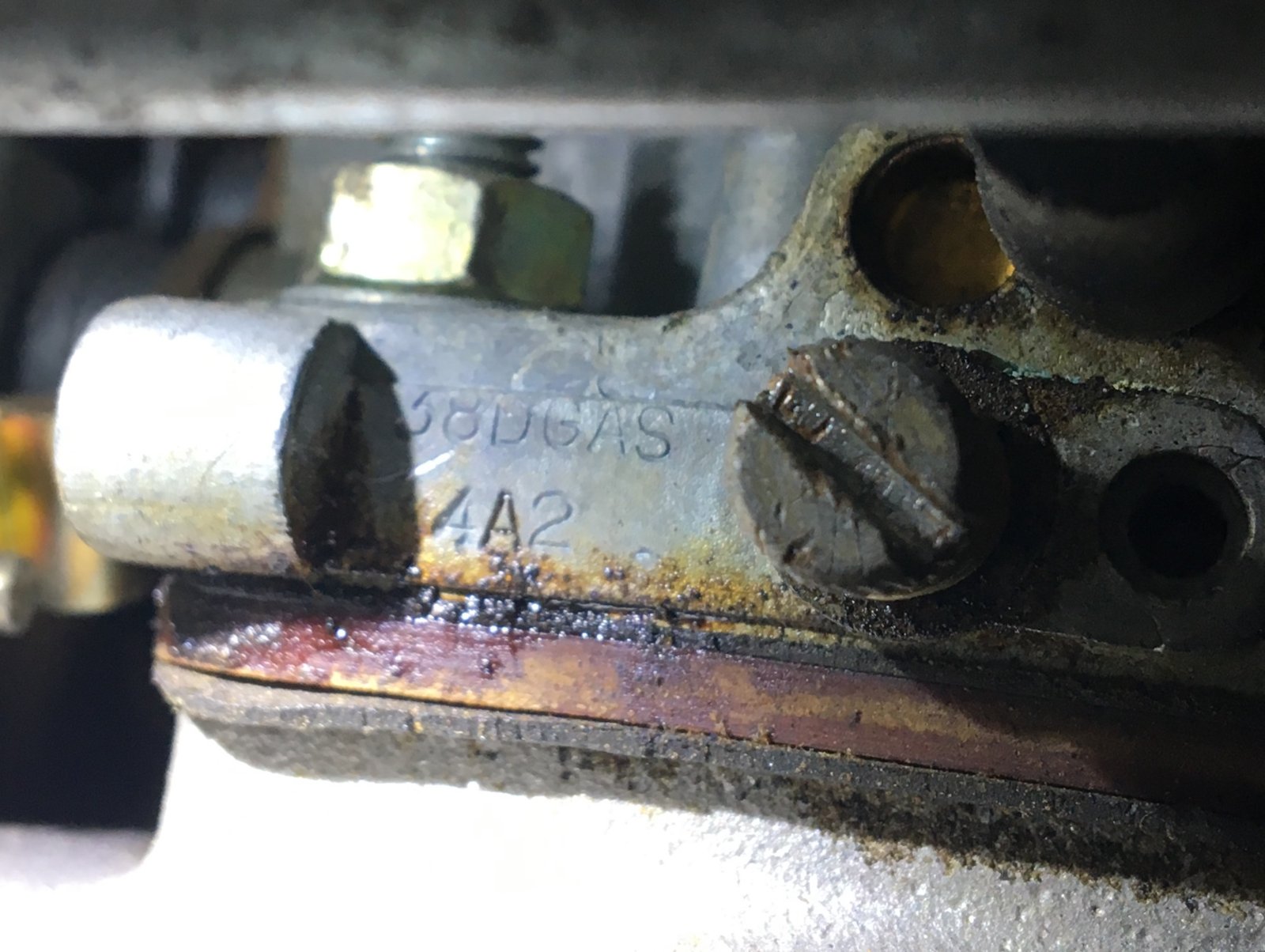

(3) I have a pair of 38DGAS (tipo 4A2 per photo) on a stock E9 3 liter. It has been easy to tune and once tuned seems to run very nicely. I’ve spent perhaps 5 hours fiddling with them, dominated by the time required to access the jets (remove air cleaner, adapter plates, cold start linkage and carb top plates, change jets and reverse the steps). Had these been DCOE’s I would’ve needed but 1 hour to do 3 steps of tuning. I can’t compare them to Zeniths (due to a 35 year gap), but recommend the 38DGAS without reservation. I would go electric choke over coolant choke as the coolant lines get in the way of adjusting the various external screws. Also, the std cold start adj procedure caused my car to idle well over 2000rpm, resulting in a terrible startup rattle (before oil got everywhere). I bive this is really bad for wear and cylinder scuffing so I adjusted cold start idle down to 1600rpm.
