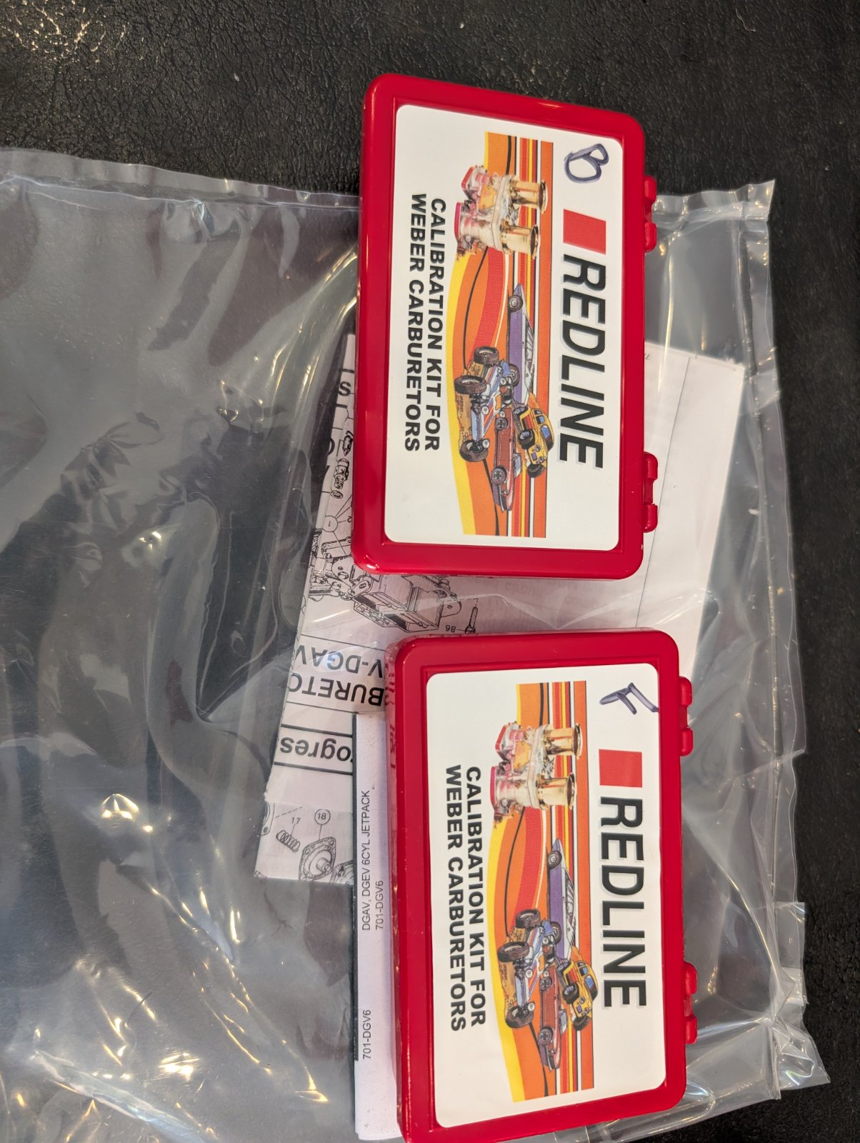

Just to finish the topic off... Well at least here anyway.
New jets arrived and I ran to the shop as soon as I saw them arrive.
Again, to somewhat recap. 3.0 motor... Stage 1 tune from Korman with a shrick cam.
Install per Pierces recommendation from the kit the first set (there are three included).
Primary idle 75, secondary idle 60. Main jet 150, air corrector 180.
Idling at 1000 smooth as silk. Could move to 80 idle but I'll play with this a bit.
