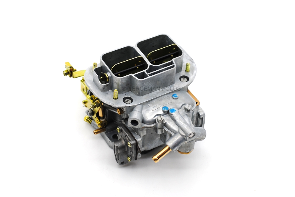

Just to keep the debate going, I have to say that my Weber 32/36's work pretty well too. The "turning point" in my Weber experience was getting a pair of 32/36's with manual chokes from Pierce Manifold. See: http://www.piercemanifolds.com/product_p/22680.005.htm
My biggest problem with both Zeniths and coolant-operated Webers was that the car was difficult to start, and ran terrible when cold. Going to a manual choke fixed this.
When Zenith offers a manually-operated choke, I'll switch back :mrgreen:
