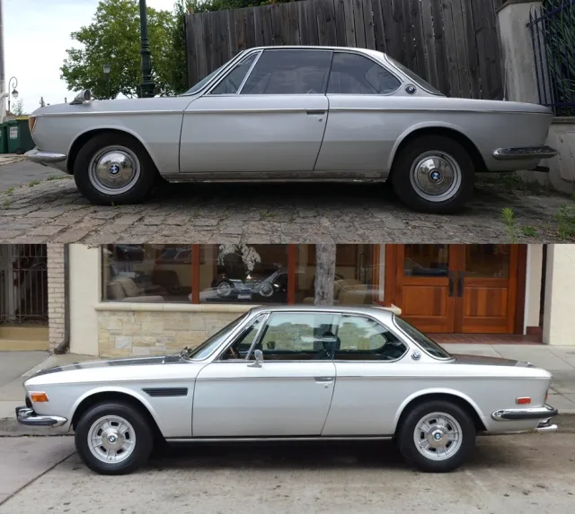

Does anyone have had a chance to compare rear fenders between E9 and E120 (2000c/cs)?
I know they are some but the question is how big they are and if the difference can be easily modified towards E9?
I was looking on many pictures and still have no clear understanding about the differences in shape, size etc.
Contour of wheel arch on e9 thicker than 2000c/cs wheel arch thats about it.

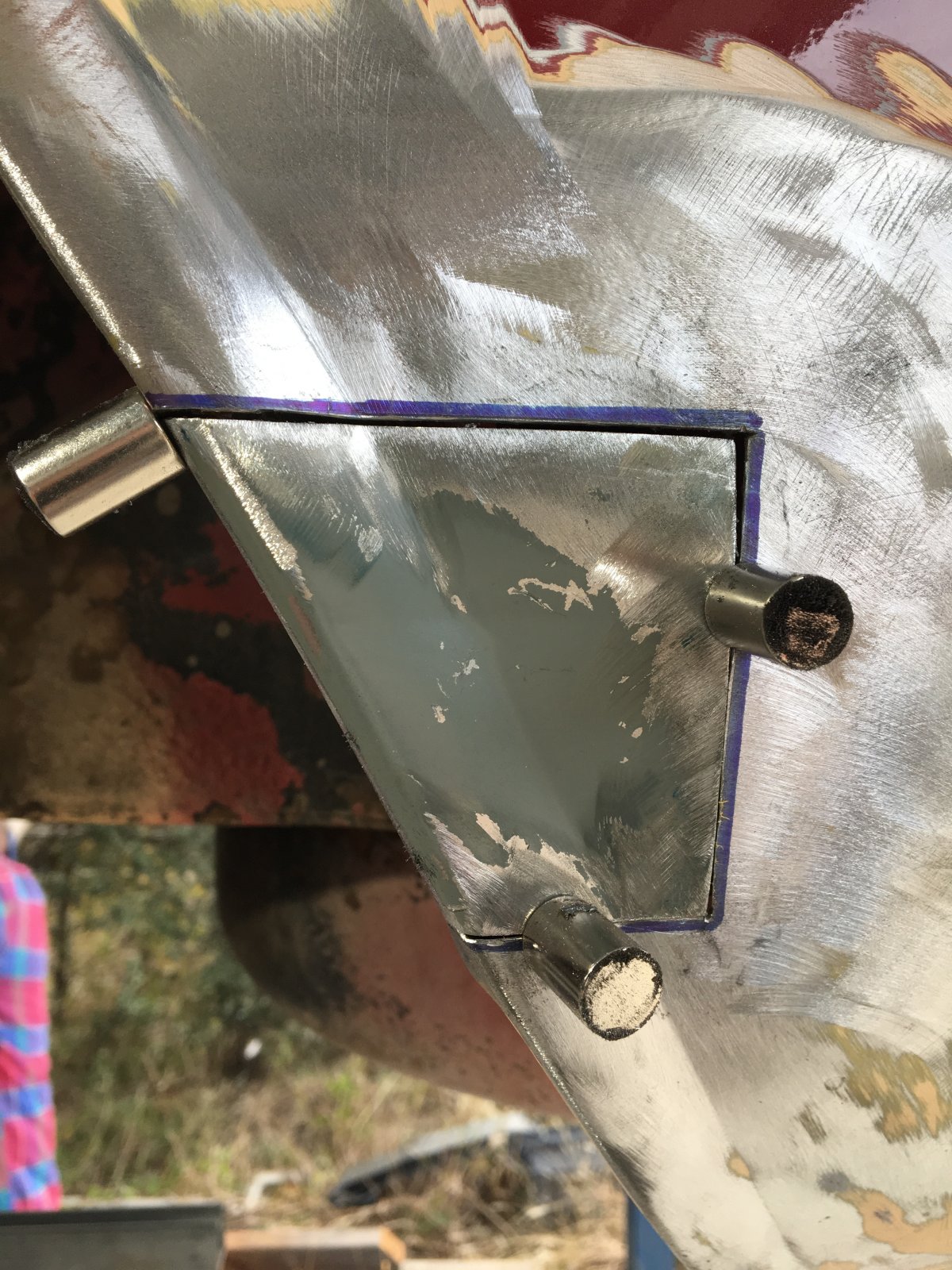

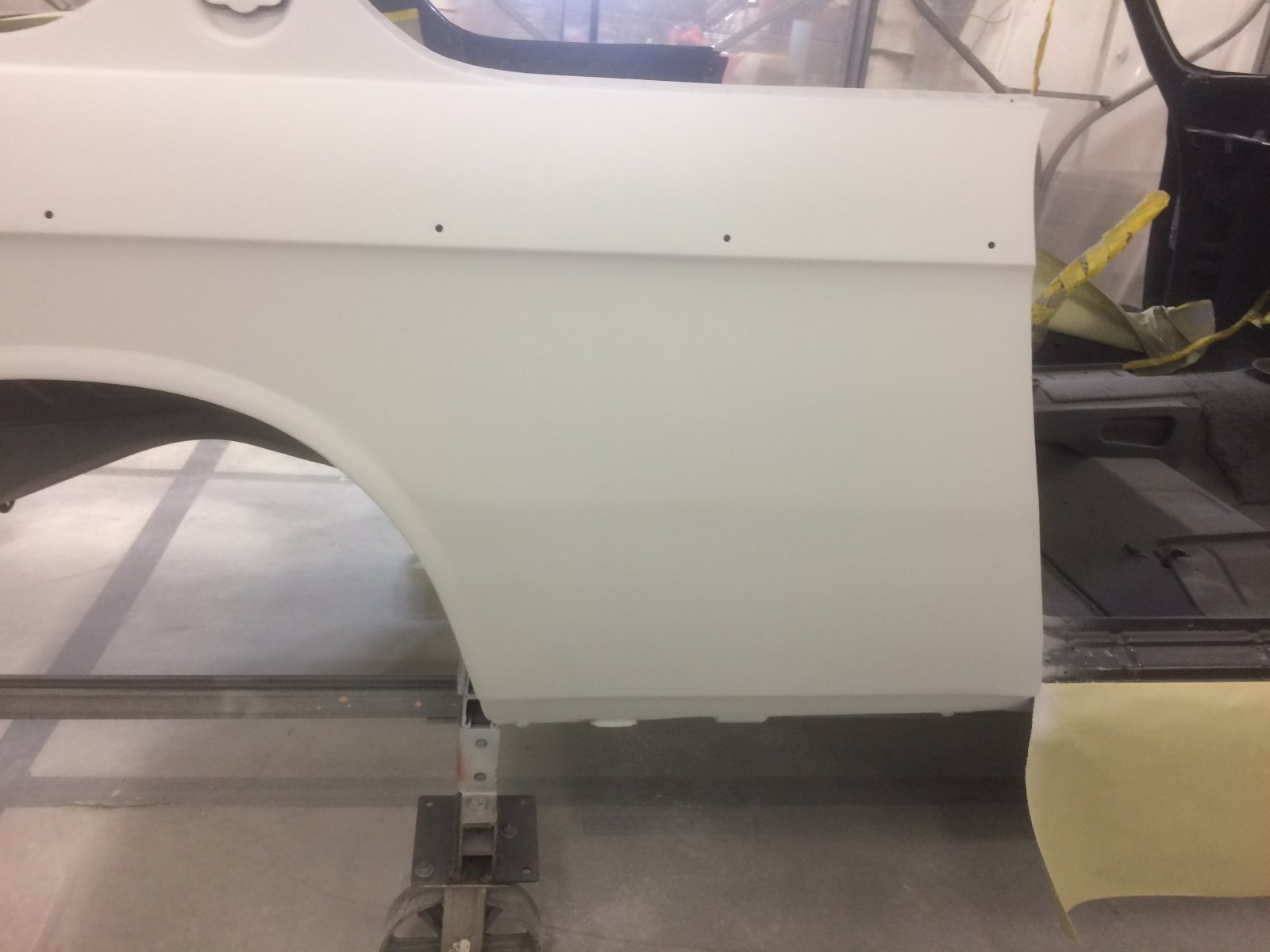

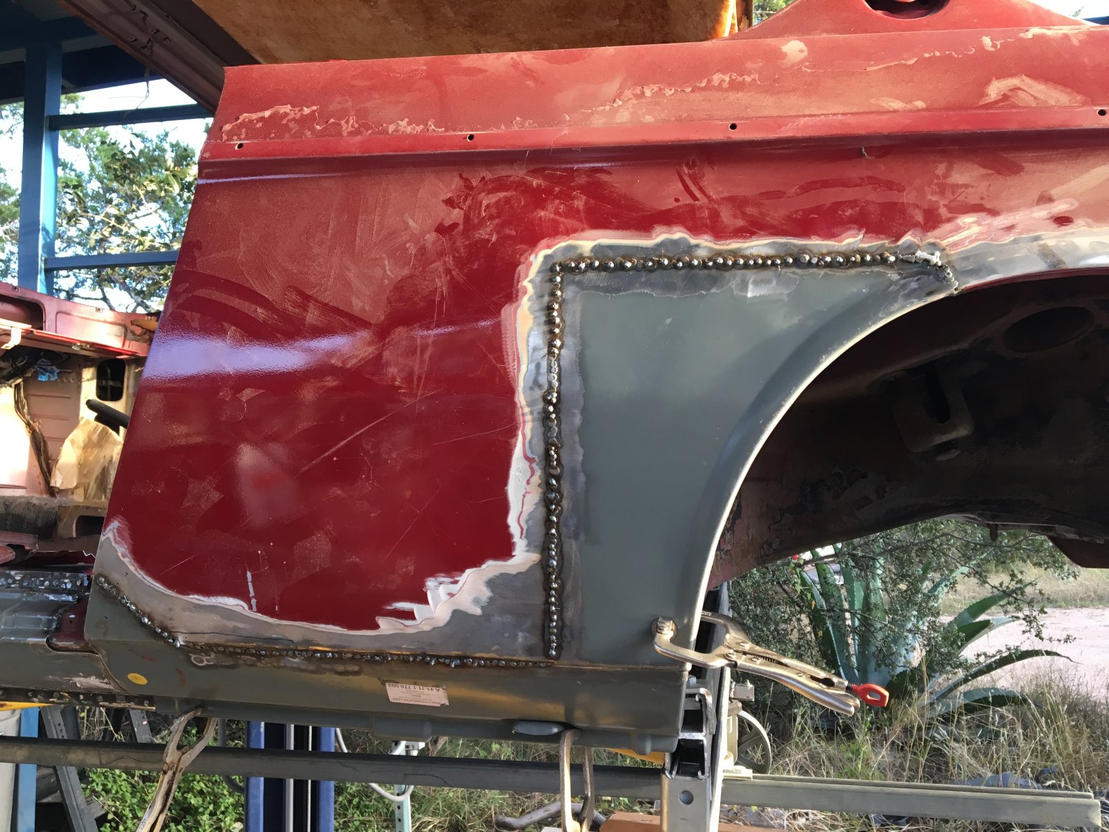

Here are pictures of my 2000CS as we repaired the rear wheel arches. Some trimming of the W&N e9 replacement panels was required (on the inside edge), but the lip is close to identical. We replaced similar sections on both sides of my car.
Ed Z
Thanks for pictures,
Yes. It is much easier to but 2000cs body parts than pure E9 and knowing the rear part is almost identical
Be sure to measure the depth of the lip. I think you will find the 2000CS is more narrow (I had to trim my replacement panels) If you are going to use a 2000CS fender on an e9, you may have to grind down the e9 panel to blend where they meet. (I hope that is clear)
