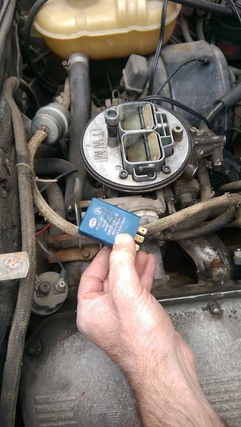

1) 3.0 cs euro just purchased. Zeniths are gone and I cannot find any info on these carbs other than TWM makes intake manifolds currently.
2) My starter will not shut off once I engage it with the ignition switch. I assume the starter relay is shot? Am I holding it in my hand (pulled from under steering column)?
3) What is that thing in the position where the emissions/dashpot thing would be on US cars (just left of my paw)? Any help appreciated
1) yes Weber carbs with the adapter to run the original air cleaner
2) sounds like ign switch that looks like a flasher relay
3) I agree, oil pressure switch, do you have a gauge in the car that has been added in?
Yes, those are Weber DGAVs. My car had a set before I installed the triple DCOEs.
Yes, add gauges to left of steering column.
Ignition switch just fell apart in my hands. Somewhere I read that an e12 switch will work but cheaper, thoughts?
Thanks for carb info.
