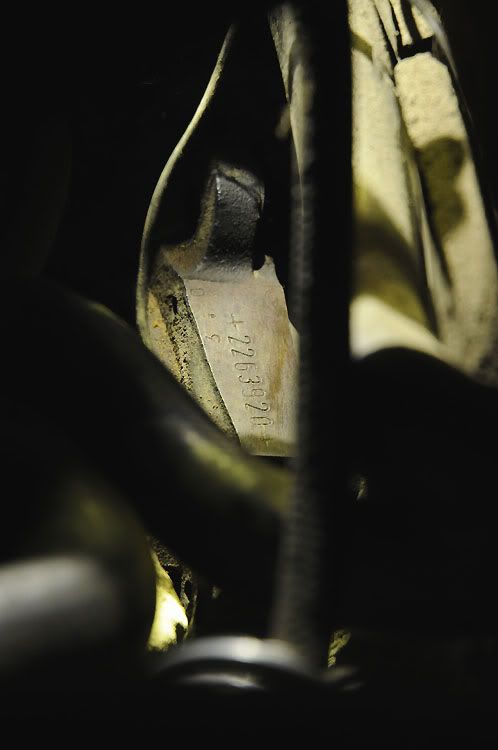

While trying to get my '71 2800CS to start after installing the Pertronix 1867A, I was looking at the timing window with the dot and while I was there I though why not look for the engine vin number too. Is the engine vin number the same as my vehicle vin on the top of the passenger fender? My vehicle vin is 2280504 and the engine vin I see above and next to the starter is 2263920. Looking at the CS registry info my engine correspond to a '71 or '72 CSI with that vin.

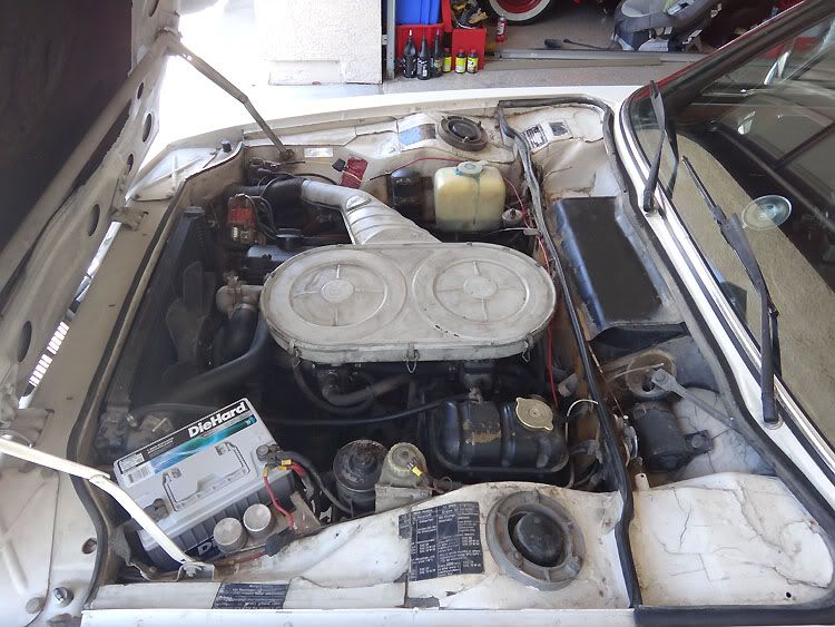

So what engine do I have in my 2800CS? I know that originally it was an automatic built in March of 1971 but has been converted over to a 4-sp manual over 10 years ago and that's all the info I know.
Here is a pic of the engine vin and the engine itself.
If you have a block from a CSI which were all 3-liter engines, I'd guess you have a 3-liter engine.
There are casting marks on the left side of the cylinder head also, but I don't think they would be conclusive.
If you're running Zenith carbs, one of the jets is different, but I'd not disassemble them to see which, there's too much opportunity for problems.

I'm gonna go look for the stamp on #1 cylinder. Currently my engine is running twin weber carbs and the distributor is a 002 unit. I didn't know that you could convert a CSI motor over to a carb engine. Is this possible?

Just got info from BMW and my engine 2263920 was from an Italian delivered 3.0CSI built on Dec 11, 1972.
