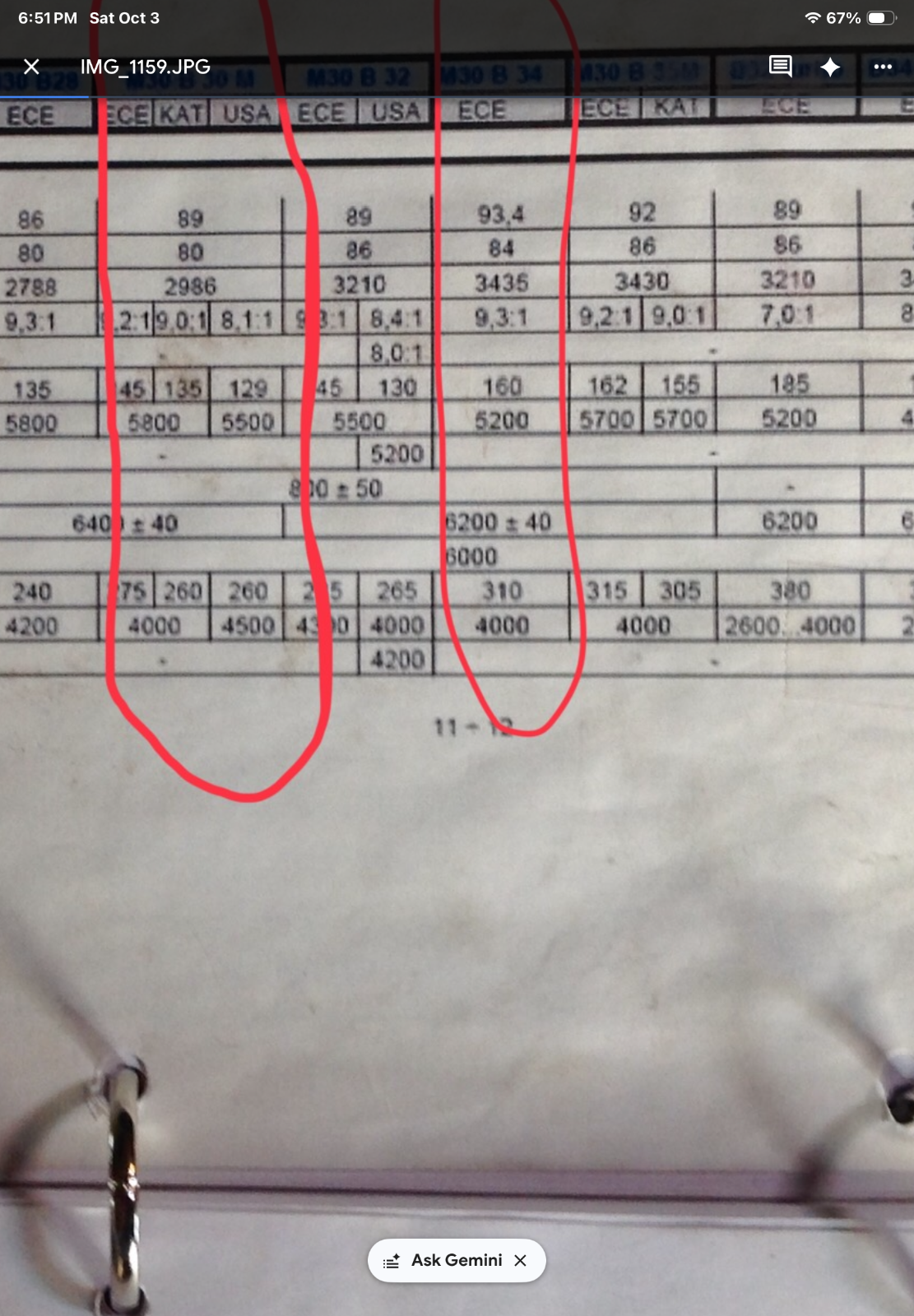

The numbers from BMW…
Bore 93.4
Stroke 84
Compression 9.3:1
