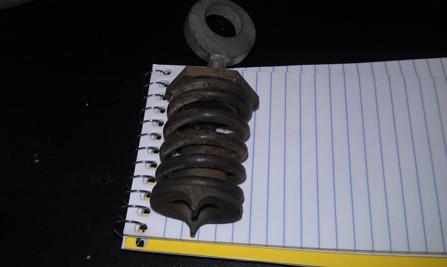

Hi Folks, I got this piece as part of a bunch of stuff for the clutch mechanism. I thought I had everything but this looks like it belongs to something else. Any ideas? I'm doing a 5-sp conversion so I don't have any old clutch parts to match this up against. The clutch master seems to have the same eyelet which screws into the cylinder but the spring thingy looks strange.

It looks like a clutch pedal return spring. Penske shows part number 35311111504, only applicable from 10/73 to 11/75 which would explain why some (most?) owners haven't seen it. The E30 uses a similar part.
It is the clutch pedal spring from an E21/E24. It is the one designed to make the pedal lighter to hold down, in traffic etc...
