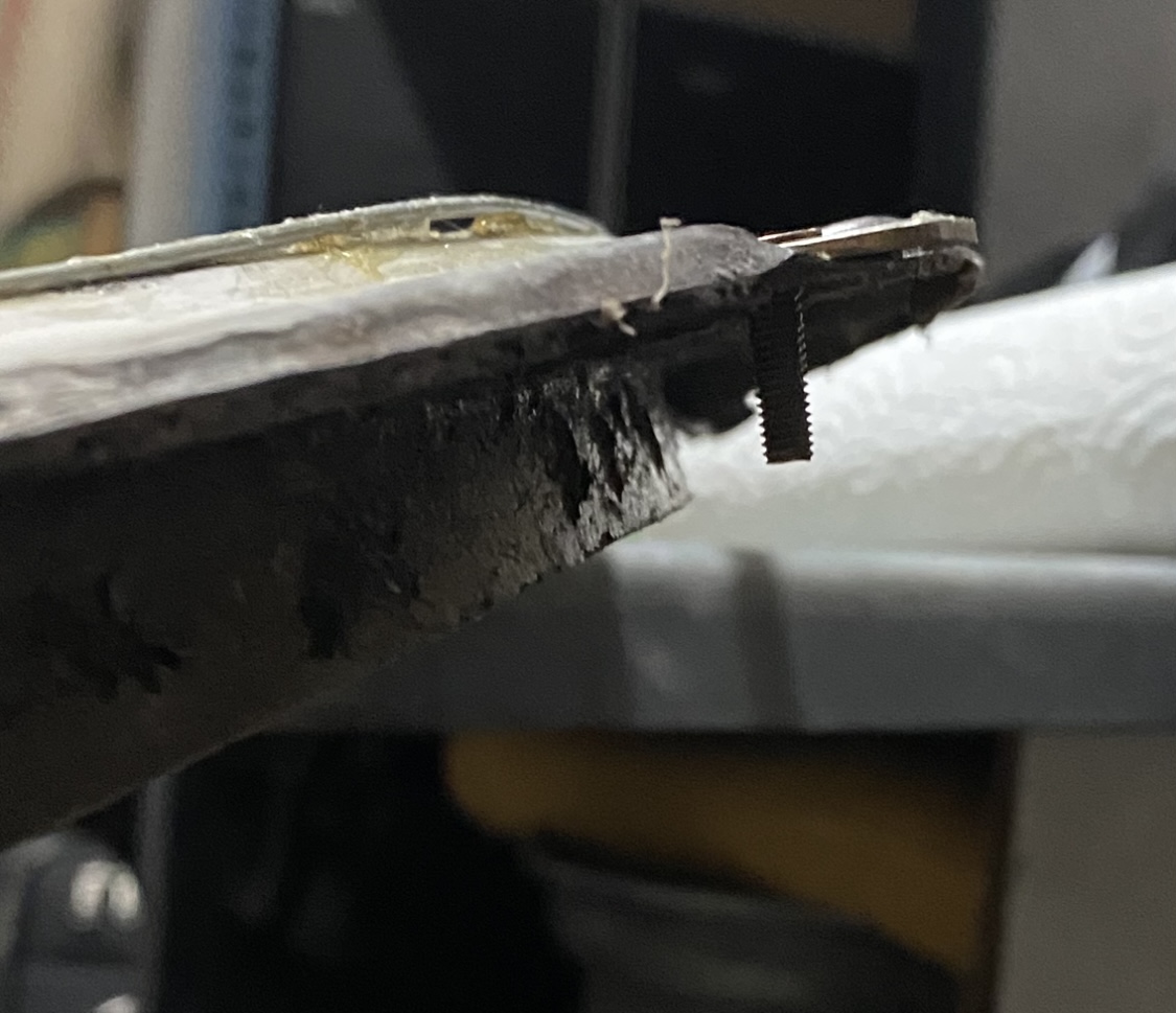

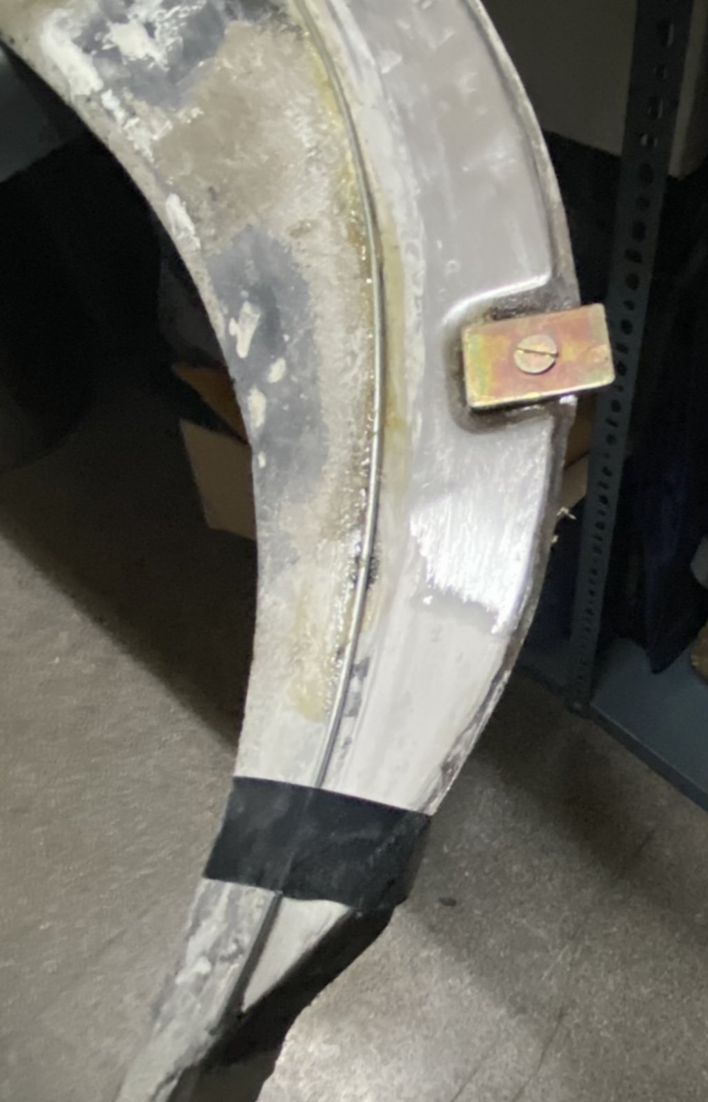

Since I had the whole dash cover removed, I decided to put treaded screws instead of clips. The center ones were easy to tie down through the speaker, and instrument openings. The corner ones were a bit of work but done with a long ratchet extension.
