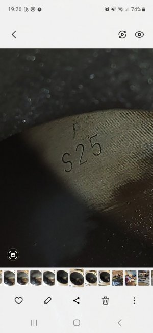

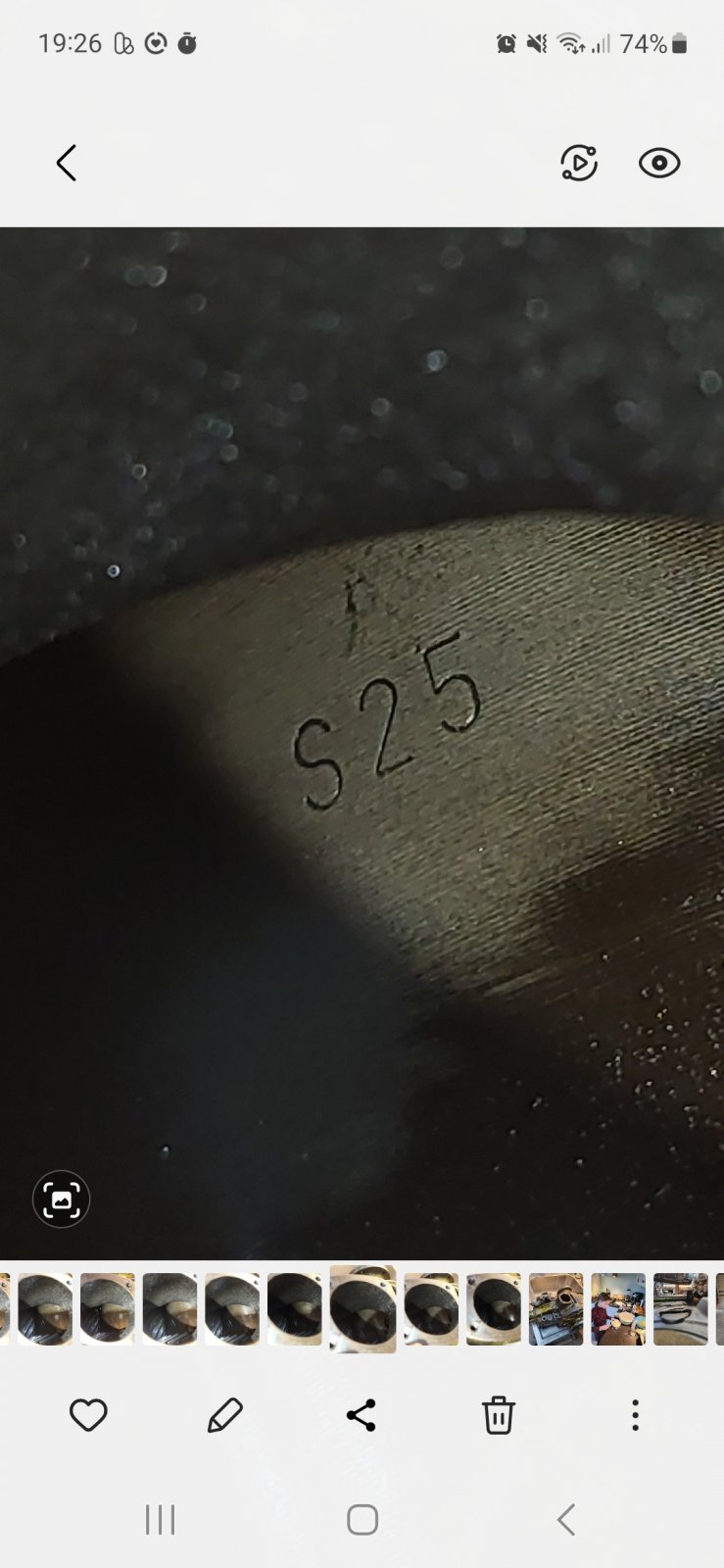

Just recieved; quick check to confirm I didn't buy a cat in a bag: it's an S25!

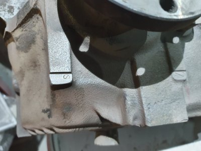

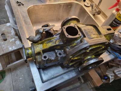

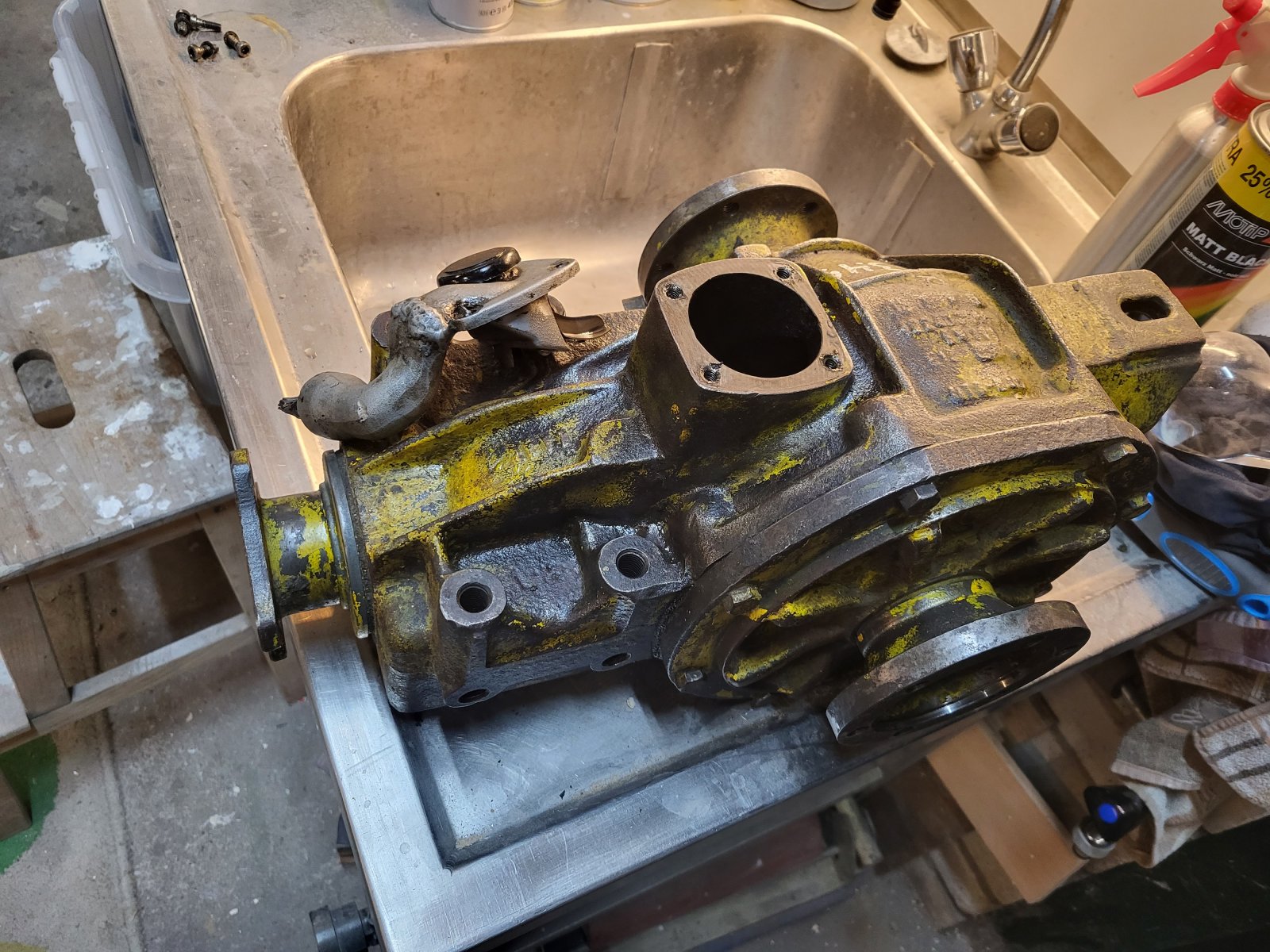

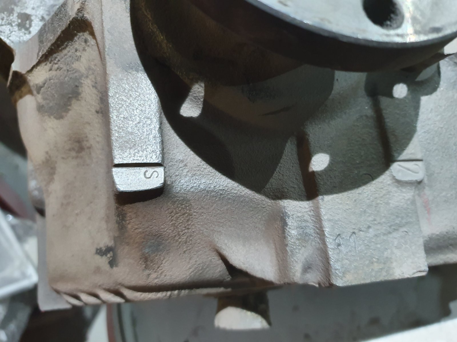

I just figure out that mine is also an LSD...
I just wonder, who bought a automatic with a LSD.
