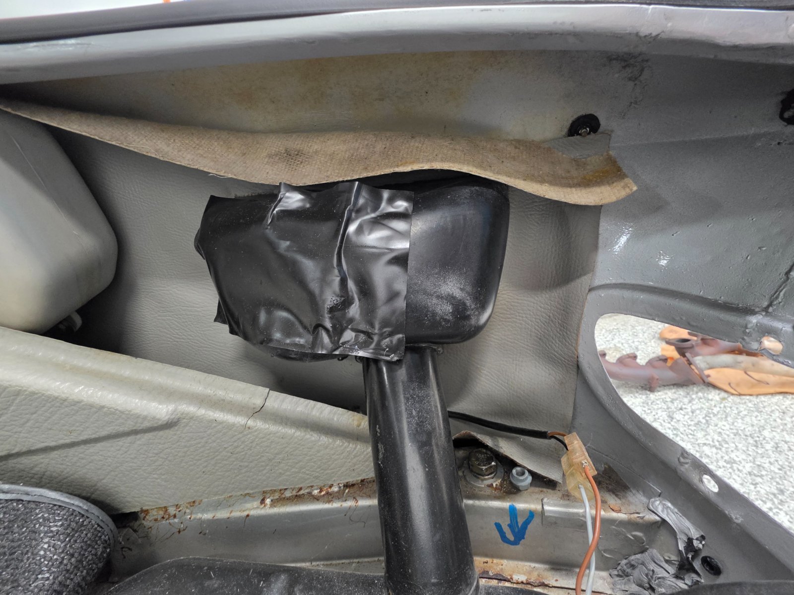

What is this black rubber boot
D Calkins
403
104
Royal Oak, Mi & Montgomery TX
What is this black rubber boot at the gas tank inlet? I could not find this in the real OEM.
That looks like a "repaired", or attempted repair of the gasket around the fuel filler neck. Part #
51715790080​
Type that number into realoem and it will pull up the part with picture
