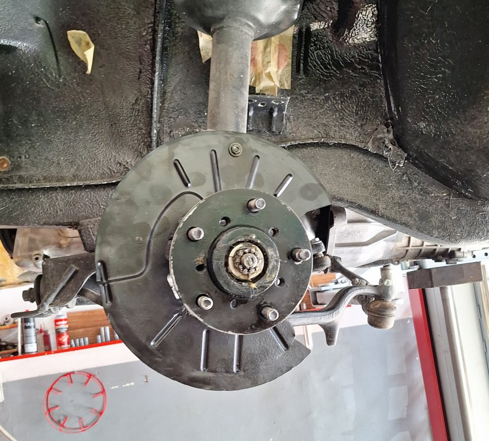

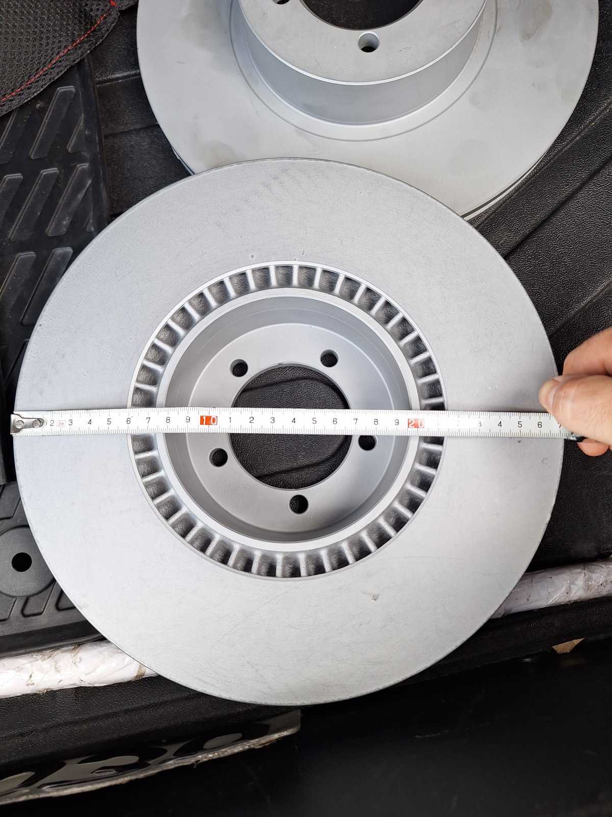

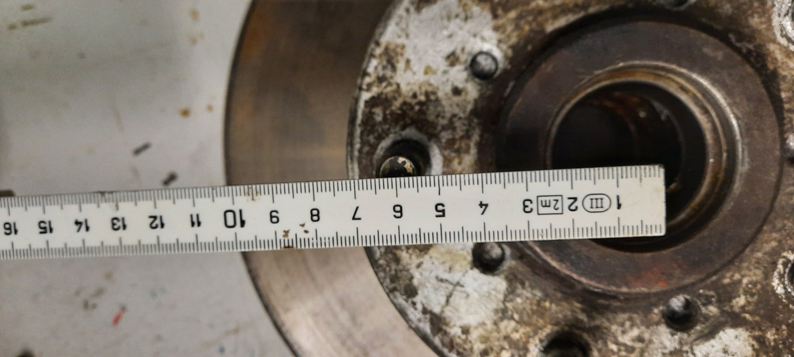

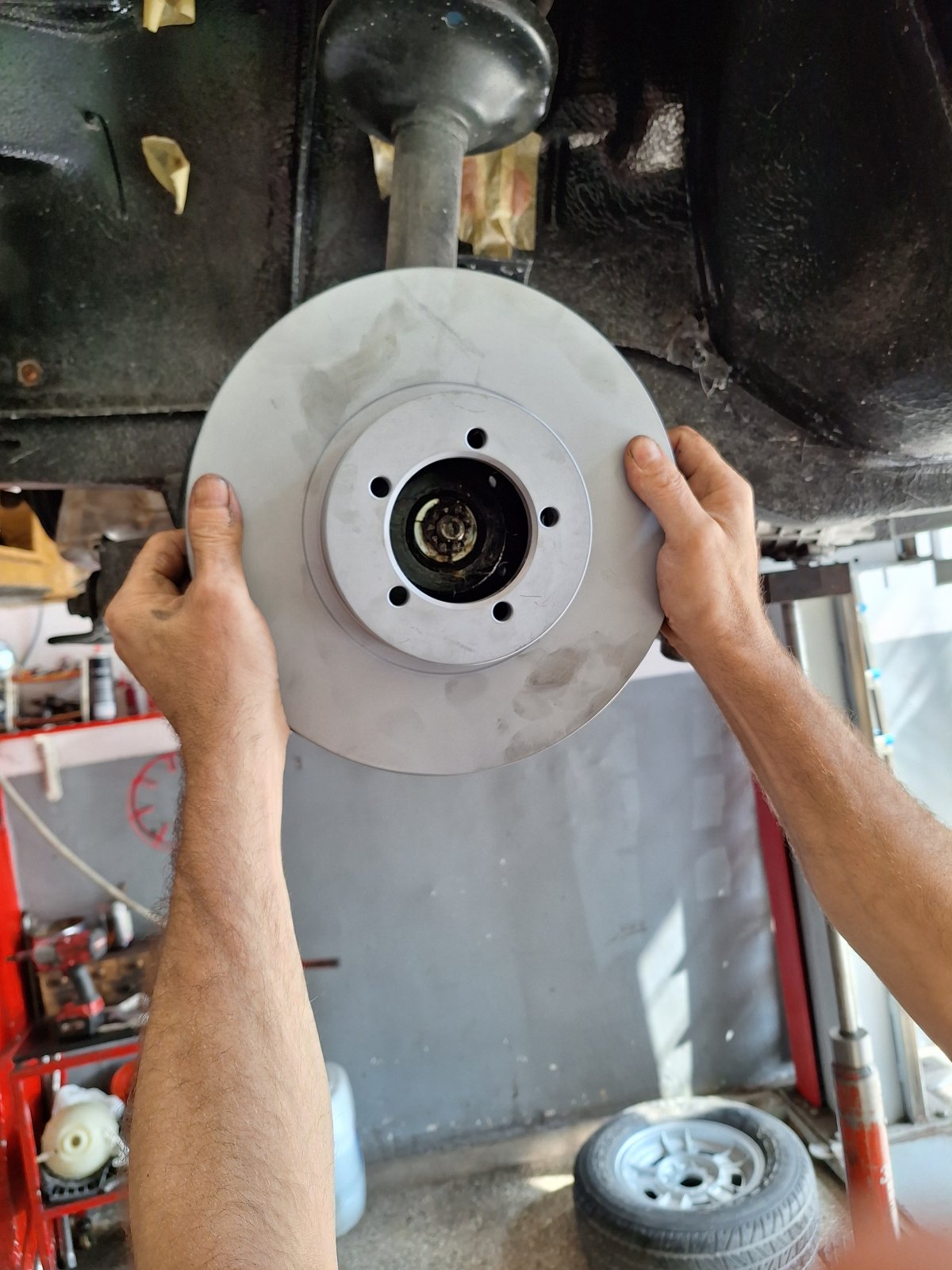

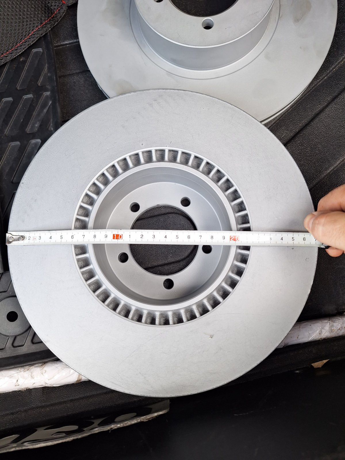

I waited 1 years for these front discs and paid them twice because of customs issues now they don't fit...
What looks wrong here ?
Wheel hub ? Brake discs ?
Original 14" wheels were on the car so they fit but it didn't have discs on it.

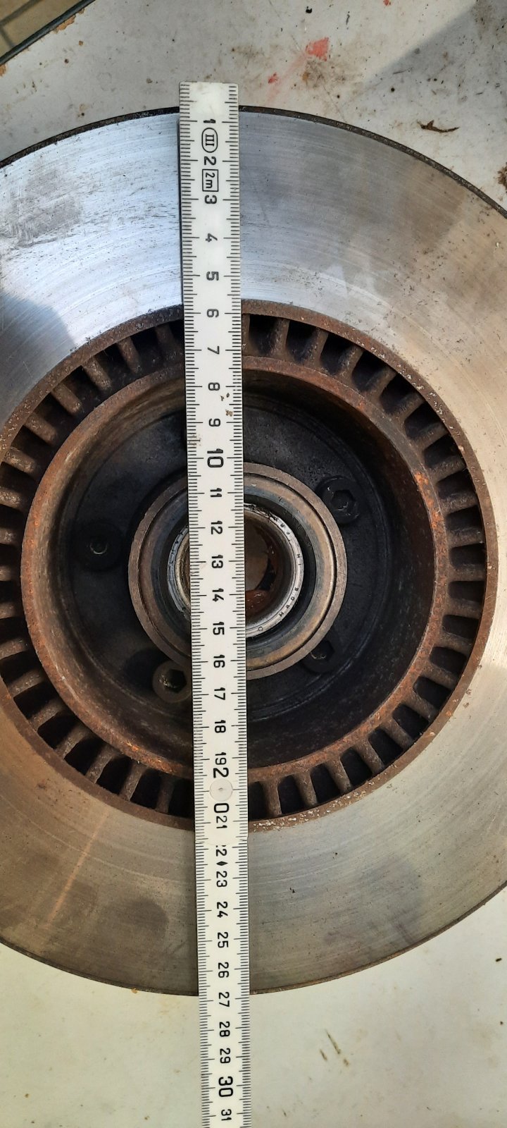

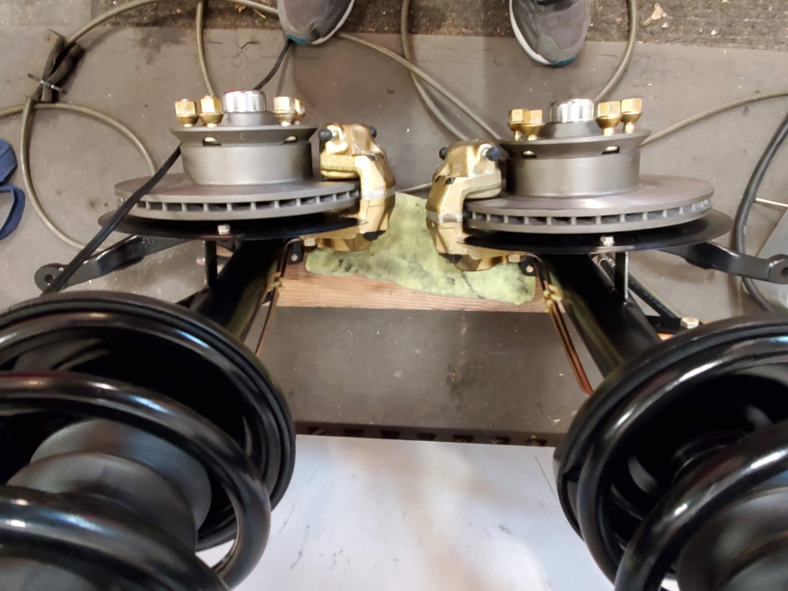

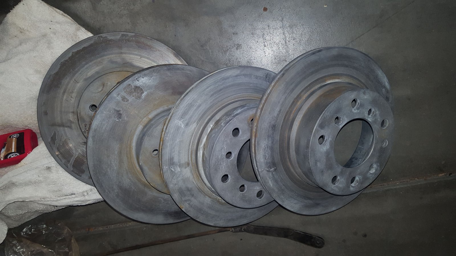

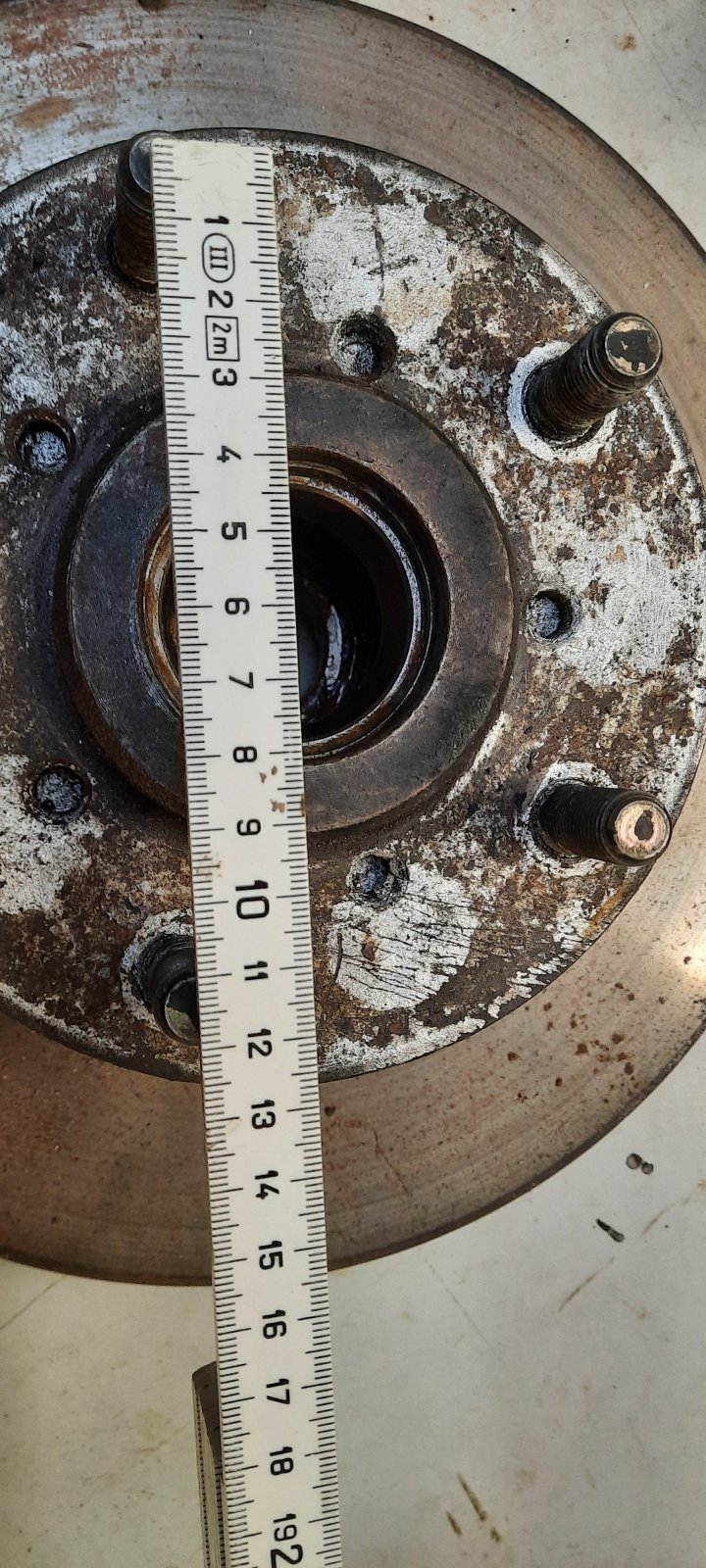

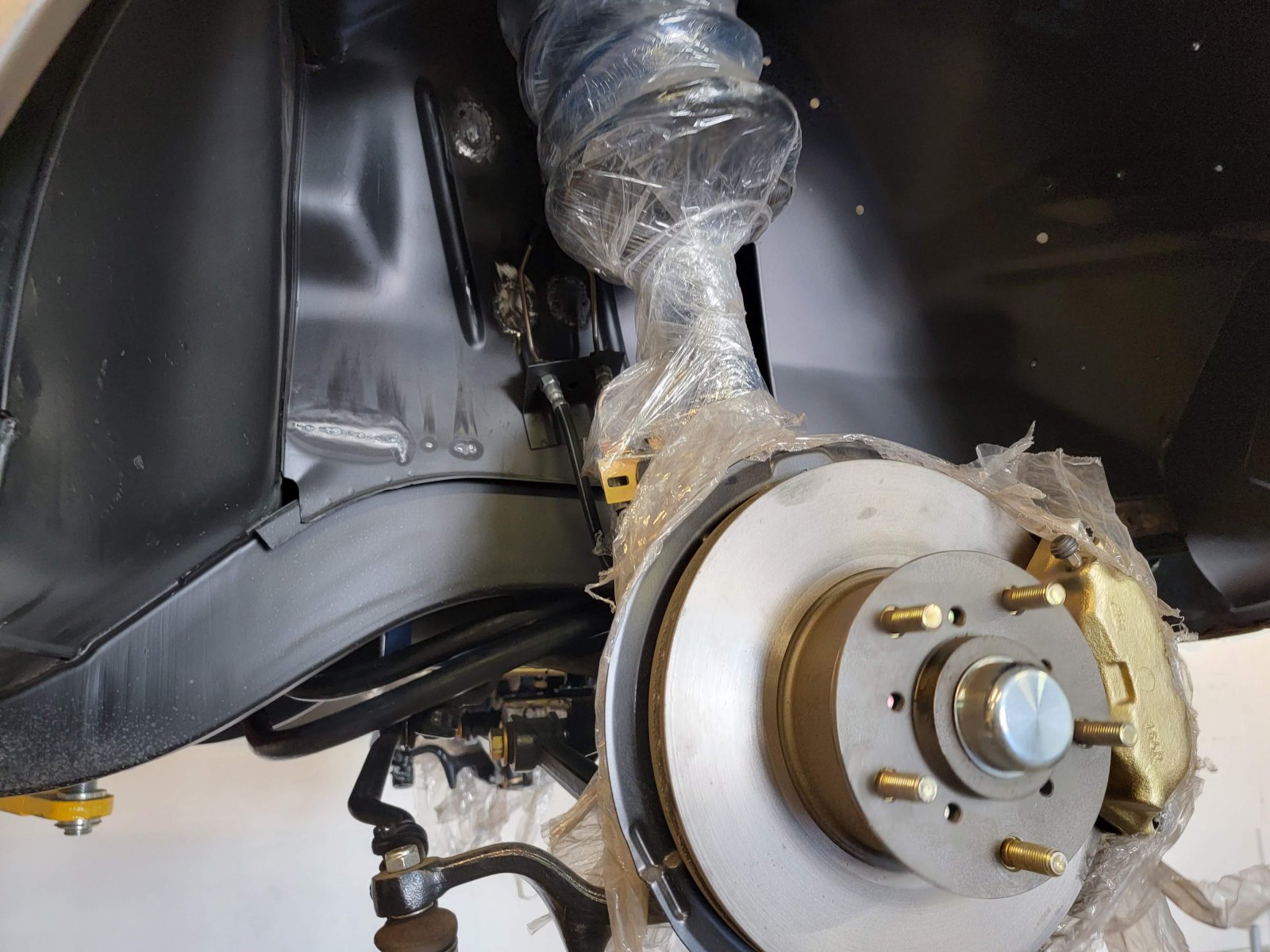

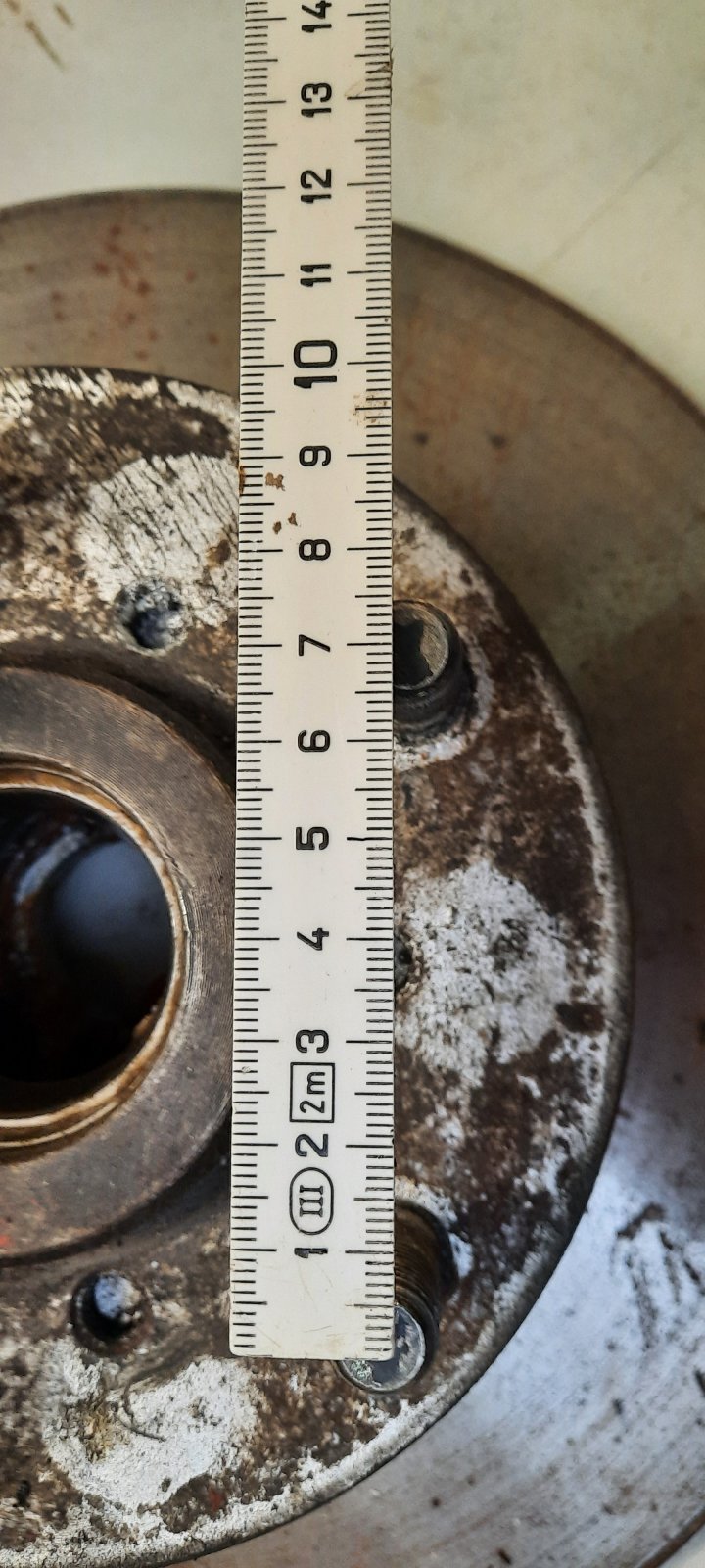

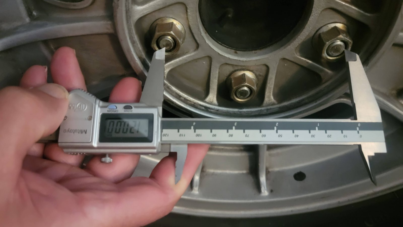

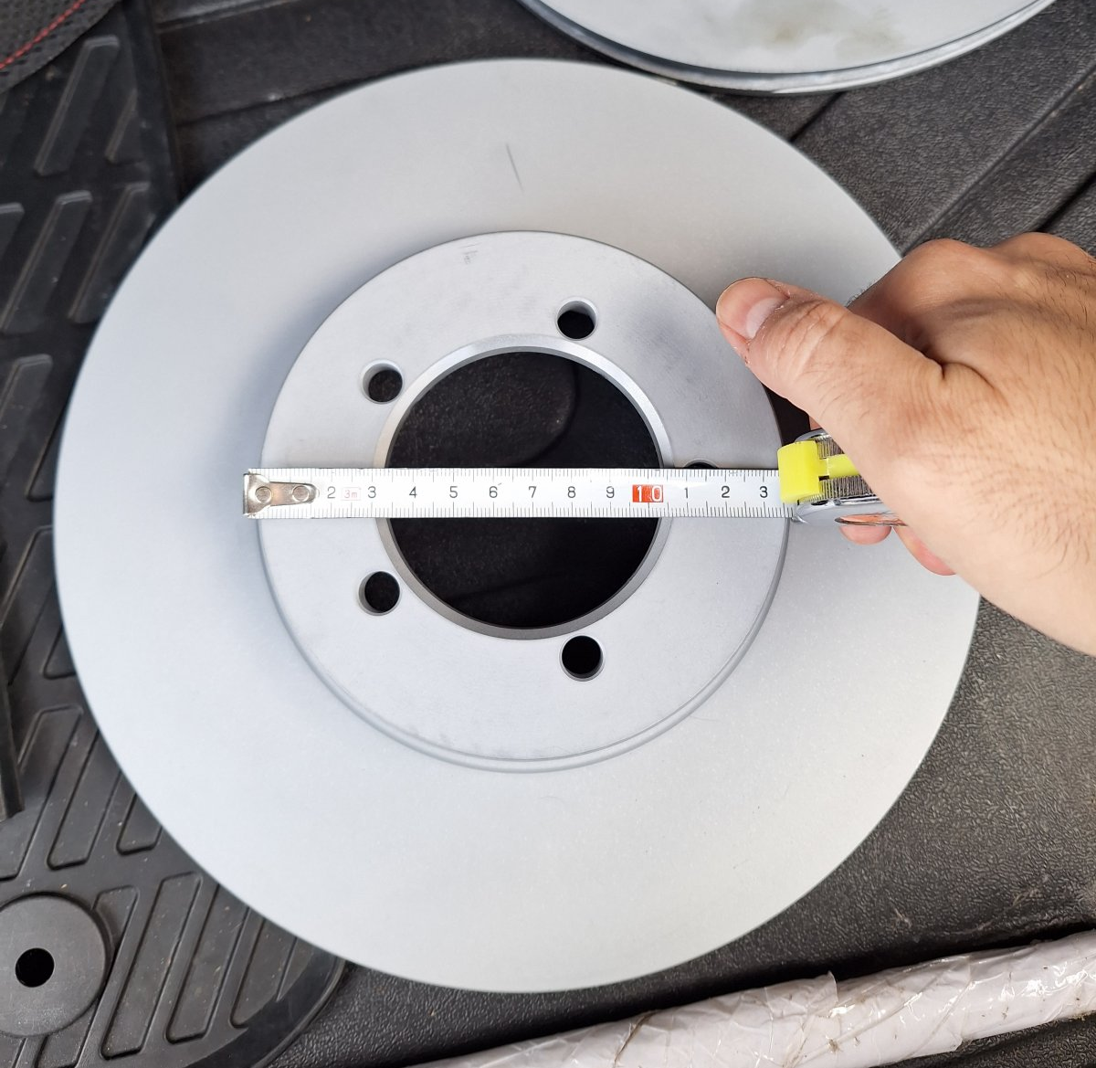

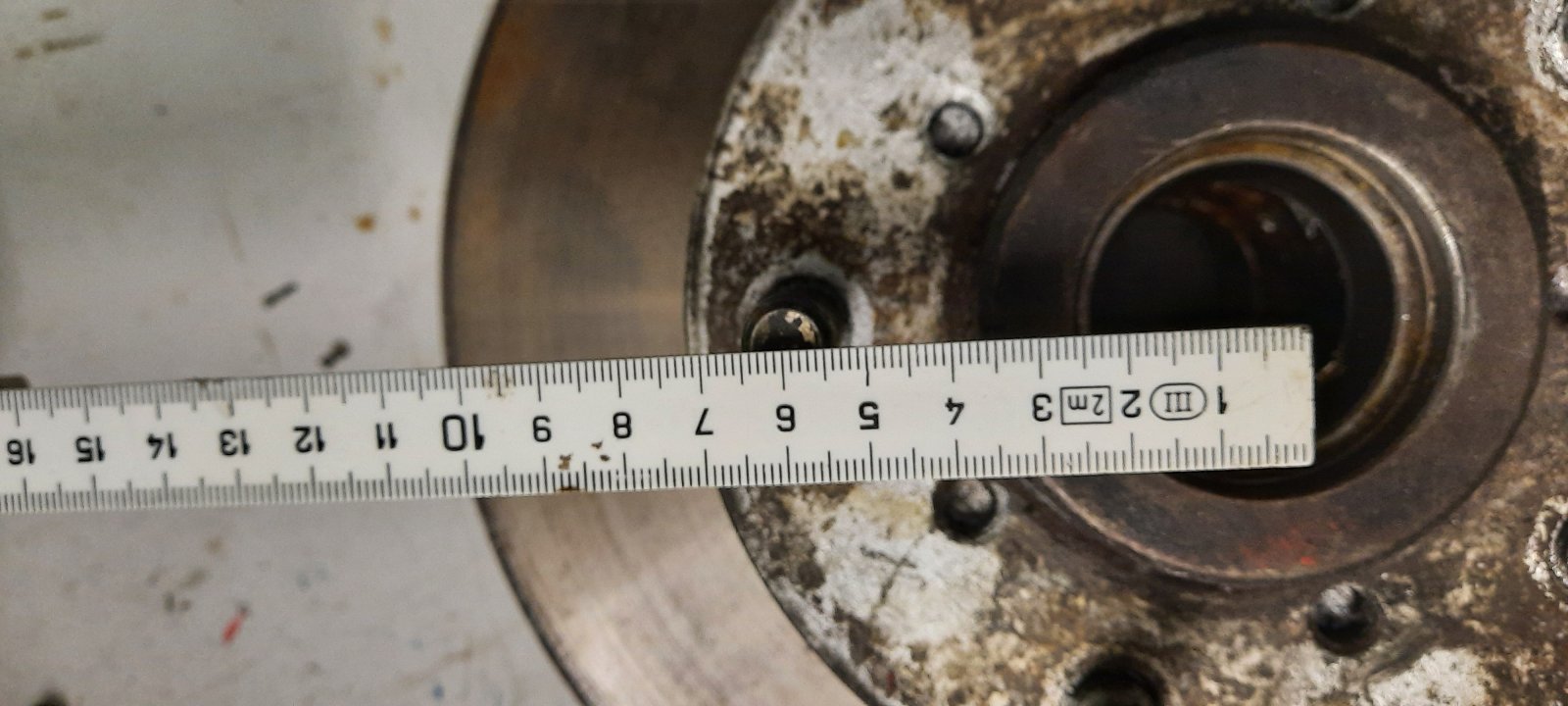

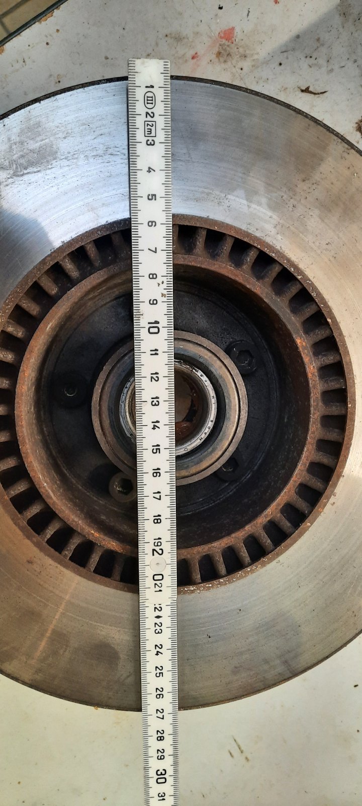

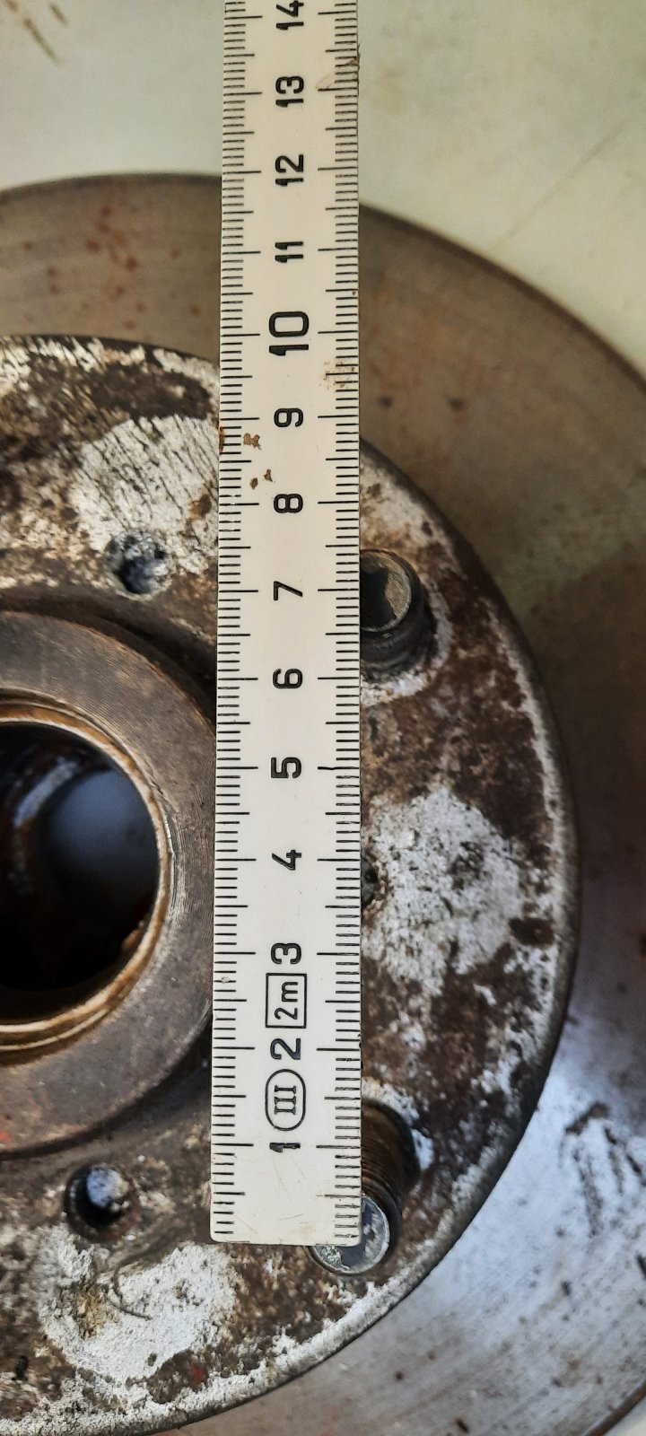

Oh man that sucks. I feel your pain but the holes in those discs appear to be too close to center. My rotors have the same holes as yours but also the other holes out at the larger diameter. These cars have a 5 x 120 mm bolt pattern. To measure, use the outside of one hole to the center of one across from it. Also, the assembly order up front is rotors behind hubs.
At first I thought maybe they were rears but no.
Definately my disc is wrong... unbeliavable luck.

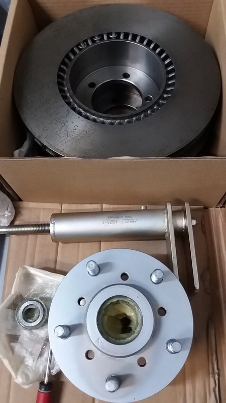

Holes are too close to center as jefflit said but diameters looks right as Tom's pictures. Could this be a production mistake or is this for some other bmw.
Where did you buy these from? Must not have been a BMW seller
Bought them from wallothnesch then package got stuck in customs because it is brake discs, hold there 1 year they did not let it go for me after that some guy who buys customs autions in bulk phoned me said "is this your package, would you like to buy it from me?" I checked... same box with correct part number... bought it second time...

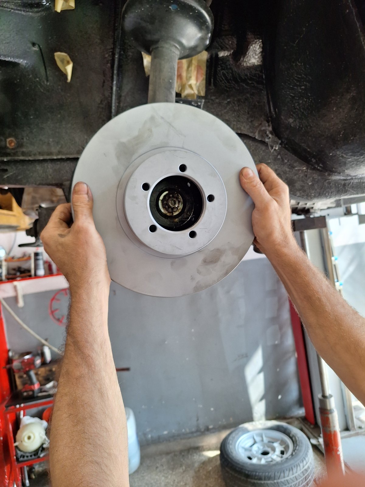

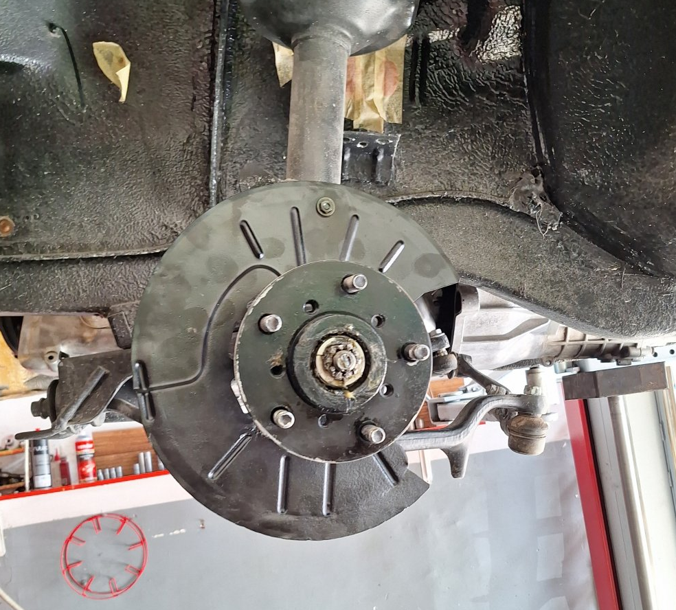

maybe you are doing something wrong ?

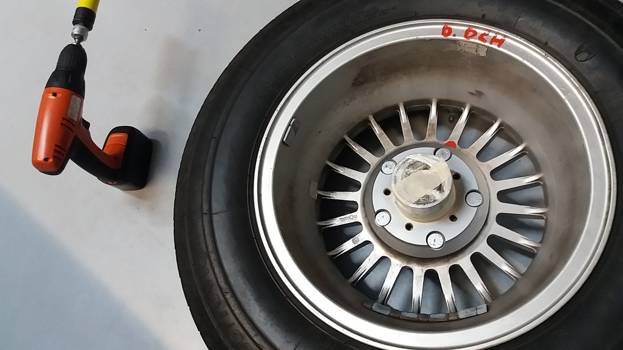

there are two sets of holes, there is a piece that goes with 5 studs to the rim

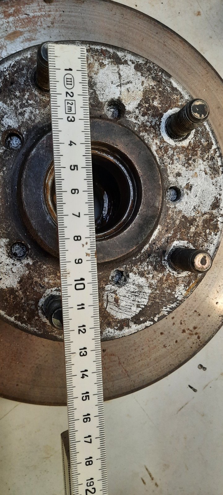

and then there is a disk that goes with 5 bolts to the previous piece (that BTW it is still in the car)
you must remove the hub (the one with the bearings)
my disks have the same hole pattern
I knew I had the right info there. Just presented wrong. As others said, the hub bolts to the rotor with the holes you have. I'm sorry I messed up my original post. I think you're good to go.
