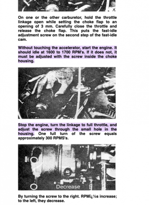

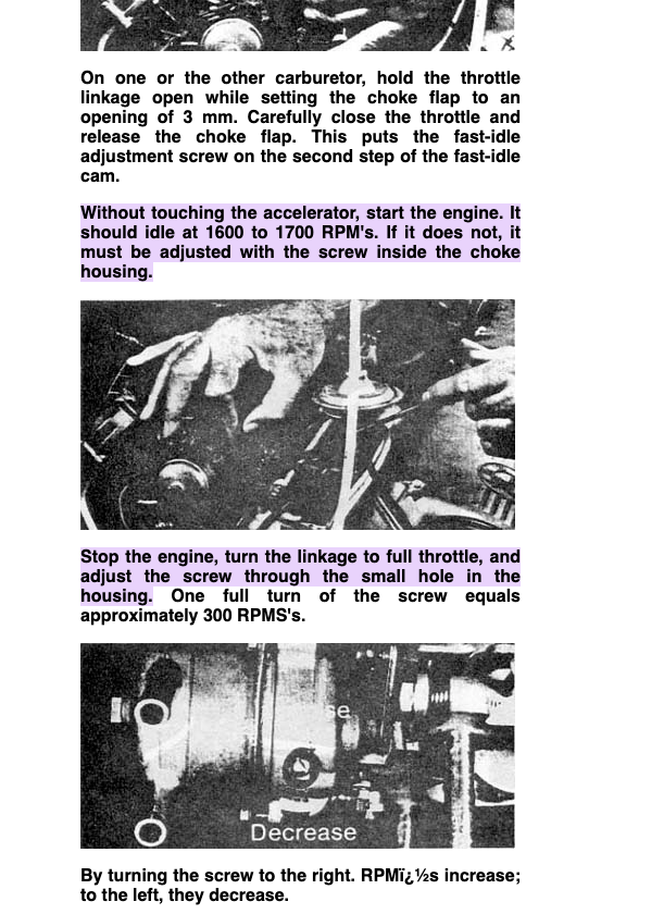

i saw this on this link so 1500rpm shoul be normal ?

That seems high if engine is warm. That image could be referencing cold start with choke
