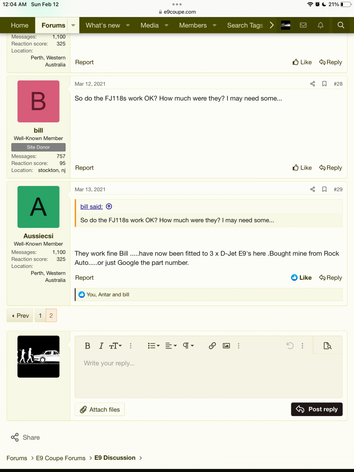

What should I do with my injectors
Hi Don
I just got a mail from Robert in FIC
and he recommended that I buy the rock auto fj118 injectors and send them onto FIC, they would then flow match them for me.
So before I actually jump,
I have 2 more questions ( just in case you are not busy enough)
1 is flow matching necessary on new out of the box fj118 injectors.
2 . I have now seen fj118 injectors for sale from rock auto and I have also seen fj118 injectors for sale at Walmart for about 20dollars less. Would the Walmart ones be the same quality ? ( apologies if that is a daft question )
I have no personal familiarity with “fj118" injectors, but that does not mean they are not equivalent to the blue Bosch injectors. Except for the color, the one picture I could find superficially looked like the original, suggesting a direct fit. Although a picture does not reveal quality or confirm flow rates, the other poster's advice seems to make these a worth while bet.
FWIW, Amazon also offers the “fj118" injectors, and this might also apparently means they are potentially returnable. https://www.amazon.com/Standard-Motor-Products-FJ118-Injector/dp/B000C81FZ4 Not surprisingly, as mentioned elsewhere in this thread, the site indicates that these injectors do not fit the BMW csi or other models known to use the same injectors. However, since they apparently fit a ‘72 Mercedes 300sel, it still might be worth a go. You mention Walmart selling auto parts and perhaps the same or a better deal is available through that outfit. Frankly, it is not that difficult to try and see. With respect to other posters and their excellent advice, for your purposes, unless you are involved in serious competition, the need for flow matching injectors is overrated or misplaced. I strongly suspect that when djet equipped engines left the factory, they all used the same Bosch injectors, straight out of the box, without pre-testing for flow. Vehicles tuned by AMG or Alpina or RUF, where engines are tuned for maximum performance, are a different kettle of fish.
All told, unless you are familiar with the djet fuel delivery system, you might save yourself some grief or at least reduce your learning curve by consulting with knowledgeable owners or tuners a little closer to you - who might offer another set of eyes for your specific build. “Jaymic” springs to mind, and perhaps they can connect you with someone nearby, on "your" island. Regarding operating fuel injection system, while it would be preferable to find someone familiar with your exact model, other marques used the Bosch djet system, including Mercedes, Porsche and Volvo.
