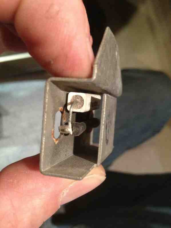

Probably been covered before, but what's this ? Mounted behind the glove box, no wires going to it on my car ???
maybe? now that you mention it I think I remember seeing one of these on the Delorian.
It's meant to have 2 x electrical spade connectors (one was snapped of) on the underside is what appears to be a ceramic resistor
No idea what it is but Stan can make a run of a hundred new ones so we can all have one.
It is obviously electrical, dissipates heat so it is either resistive or a solid state device, VDO label suggests it is related to the instruments maybe? If both spades are insulated the device is used in series, as opposed of going in parallel to ground.

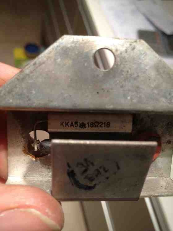

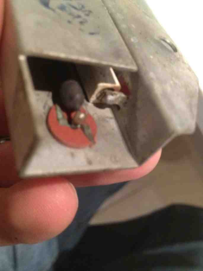

Here's a picture of the underside
Car was an auto if that's any help?
The white ceramic resistor is 18 ohm
Gold Star for Arde! mystery solved, since the car is now manual, I'll put it in the bin
