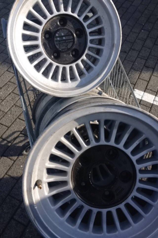

Hi guys, sorry as this has undoubtedly been asked a million times before…
Nonetheless, been offered a set of 14x7 wheels, supposedly it says one them: 5x120 e11 and BMW ats.
Would those fit? And if so, what tyre size would you recommend?
I´ll be running Bilstein Sport and Nelson lowered springs.
Pic:
Thanks!
Gisli
Looks like 14 inch Alpina but I forget the pattern/offset numbers. Others are really good with that. The simple way is 195 wide tires all around. Can go wider in the rear and may go wider in the front with fender rolling. Wider is 205 I believe.
OK thanks, yup, not Alpina no. I assume those fit then and will buy them and find out the hard way if they don´t :)
Thanks again.
Gisli
PDC at 5x120 is correct. Don't know about the offset.
