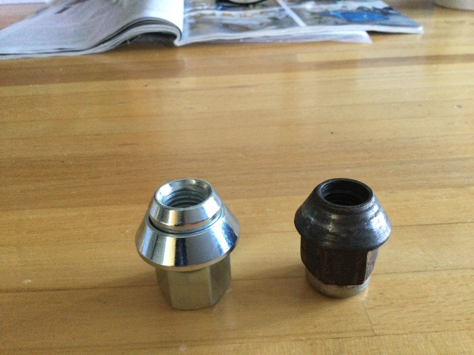

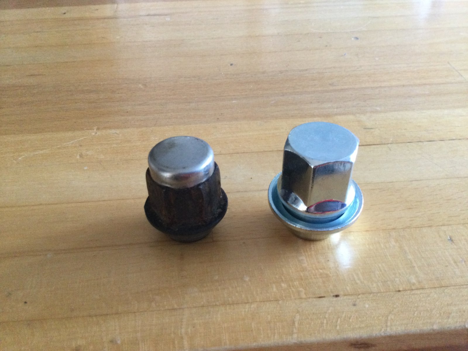

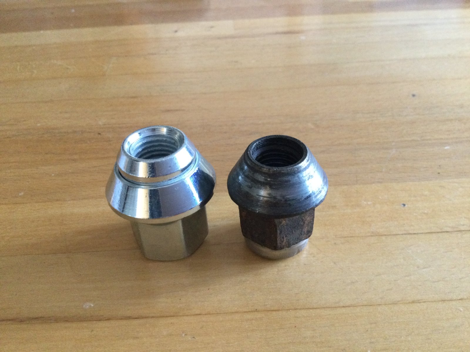

New and old wheels nuts, they look a lot better.
There are two big difference
The new nuts are longer, which I don’t see as an issue.
The new have a floating collar, I can see a disadvantage in that, but I am open to views.
I expect that the old ones were original factory fitted as I have a series 2 CSI which came standard with Alpinas, but you never know after near 50 years.
I trial fitted a few, they don’t seem to reach a final tight position as easily I expect that is due to the overall longer collar still bedding in. I will drive it, loosen them and retighten, with a torque wrench.

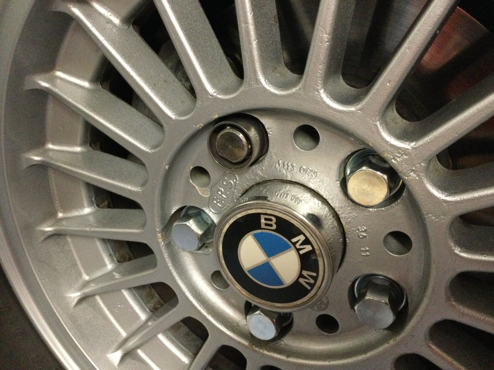

Fitted.
Yes, I know the wheel centre is normally painted black, let’s call it work in progress
Like this I can zoom in more than I can see in real life which really shows the pitting in the original casting, but let’s call that character or patina for the chips and scratches.
