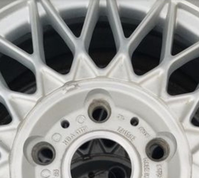

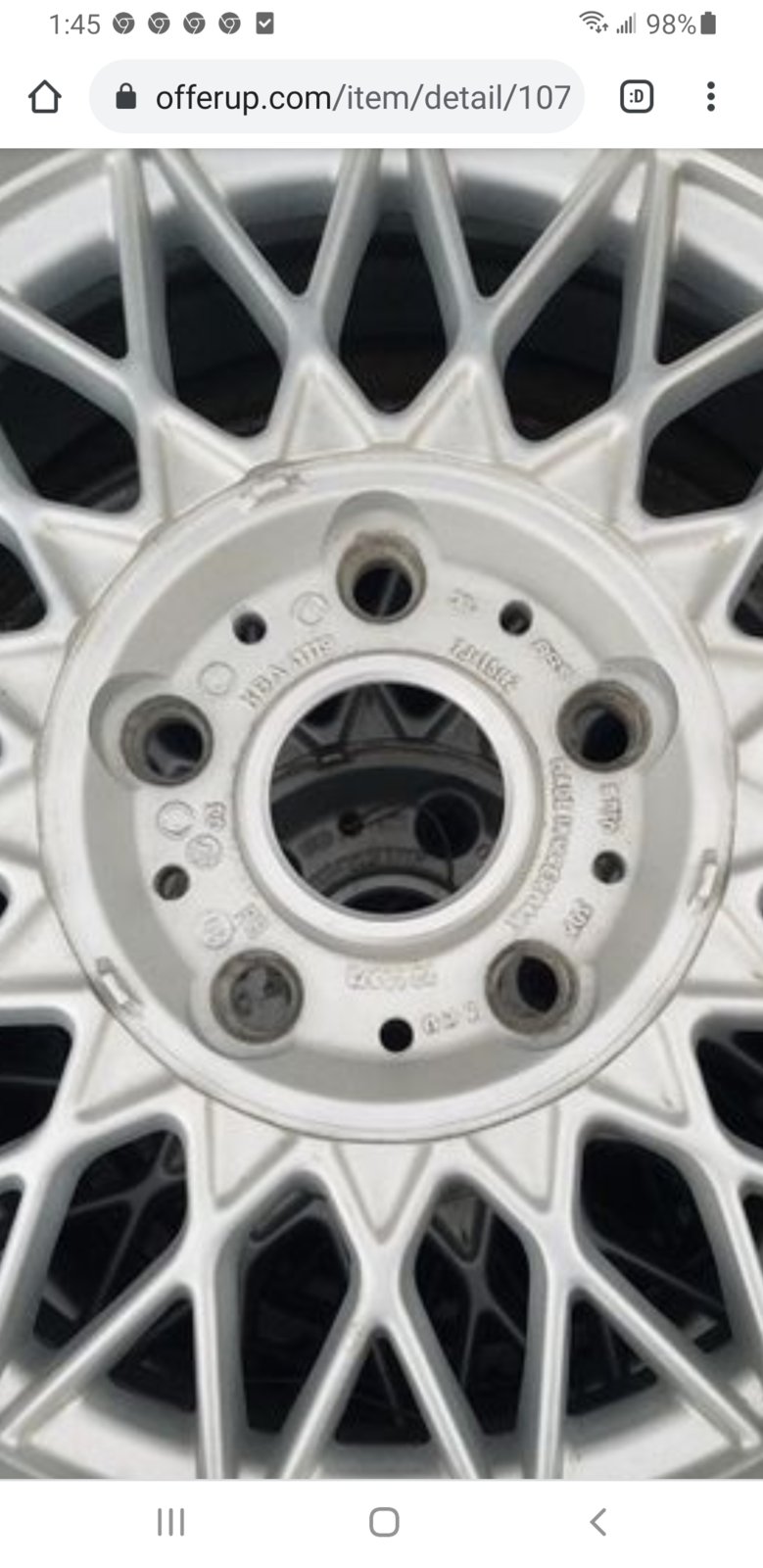

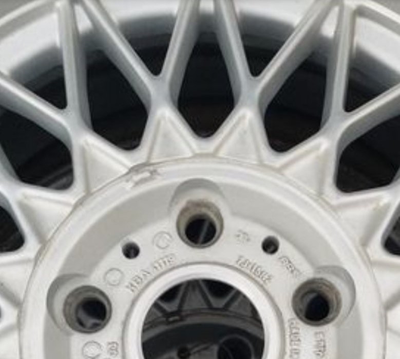

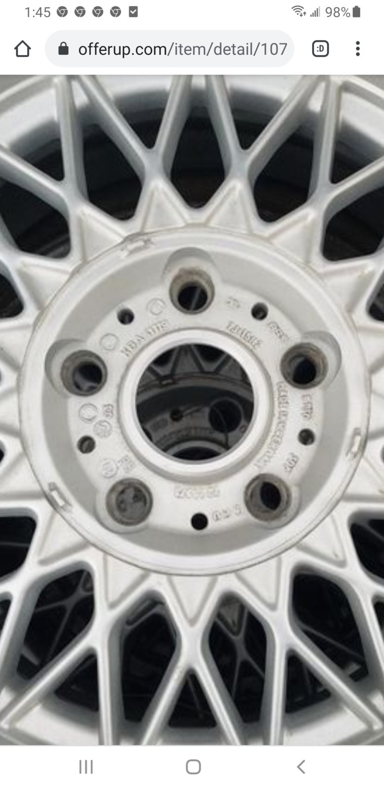

Will this wheel fit 74, E9, without spacer or any other modification. It is 15", has ET of 30 for offset.
Is there a maximum allowable offset for E9, without the use of spacers?

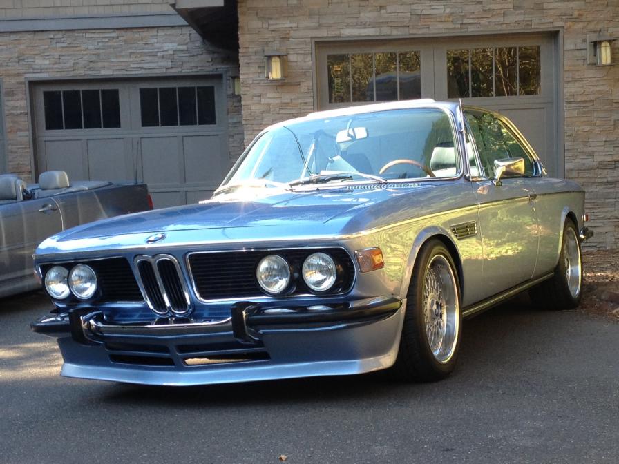

I have 15x7 BBS BRZs with 205/65/15 Michelins and stock European ride height up front in that my US spacers are removed. The tires don't rub the struts or hit the fenders if I am careful. Since you have 14 inch, my information may not be helpful. You can seem my wheels in the FAQ wheel thread.
Oops! It would be 205 65 15, not 205 70 14 that I would consider using with such wheels if I go this route.

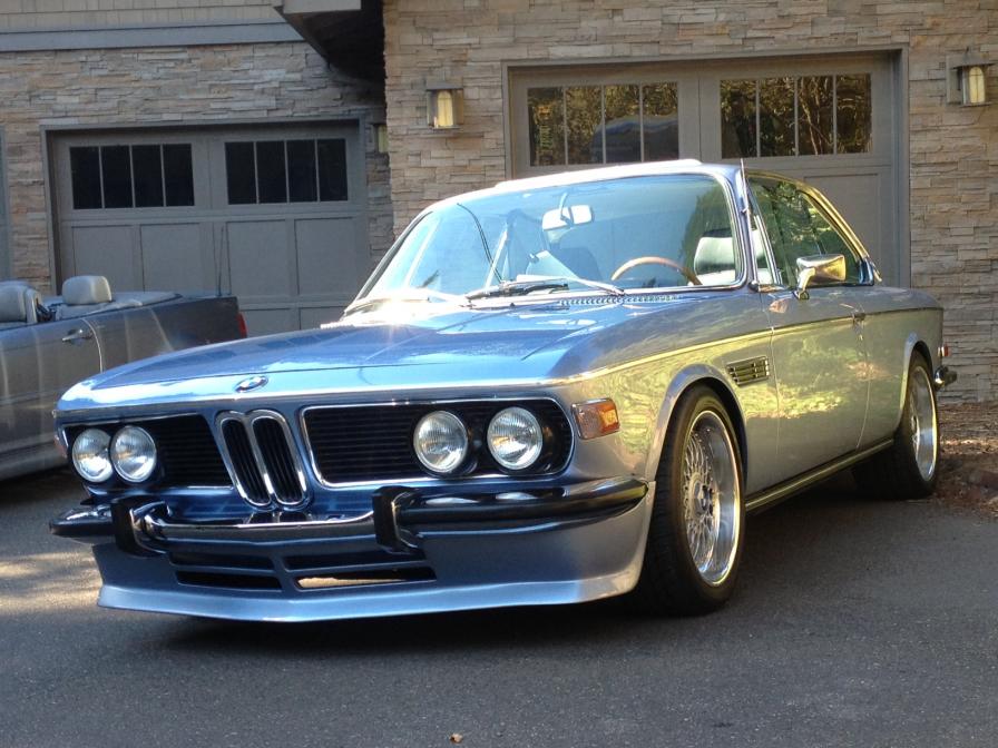

Here is a pic of my strut vs. tire spacing. I am not sure of my offset but I don’t have any spacers. I didn’t measure it, but the clearance to the strut is over 1/4 inch. I suppose a large bump could compress the tire enough to rub the side of the strut but it hasn’t happened to me.

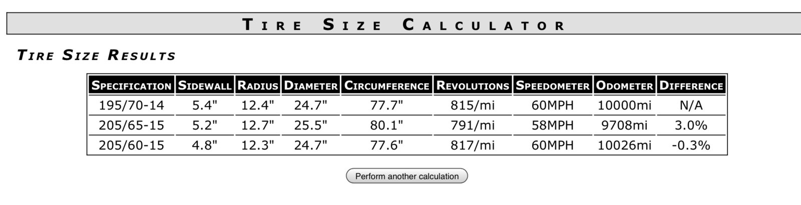

And here is one to find the correct tire size.
In your case 205/65/15 is too big comapred to the original size. You should use 205/60/15

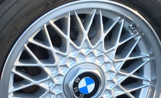

Your pictures help illustrate my point. Compare your wheels to the ones shown by @bluecs. They are apples and oranges, the same size but significantly different offset. I suspect that the ET30 wheels are from an E30M3, and yours are from some 5 series. There are many style 5's, but only a handful have spokes that extend all the way to the wheel lip. As seen on the M3, and the e28 M5, etc.
@Norm! only has about .25" of clearance from the tire to the strut, on a wheel with less offset. Both wheels are 15x7, but the wheels purchased by @bluecs will be quite close to the strut, if not against the strut. So essentially the same wheel, but that "dish" that you see is represented as a lower offset.
If you look at the wheel posted by @bluecs, the spoke ends at the lip with almost no dish:
The wheel on @Norm! 's car has at least .5" of dish.

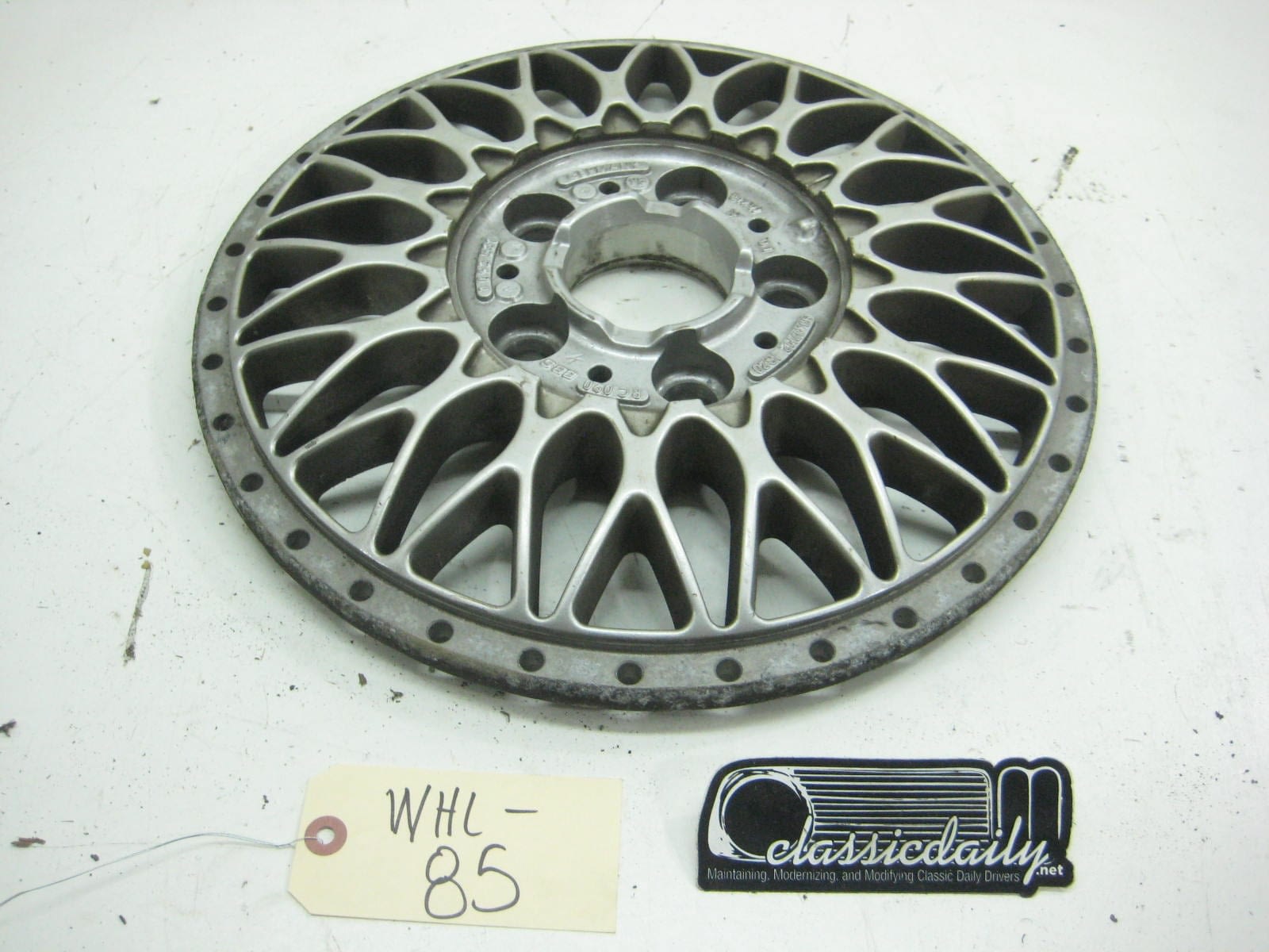

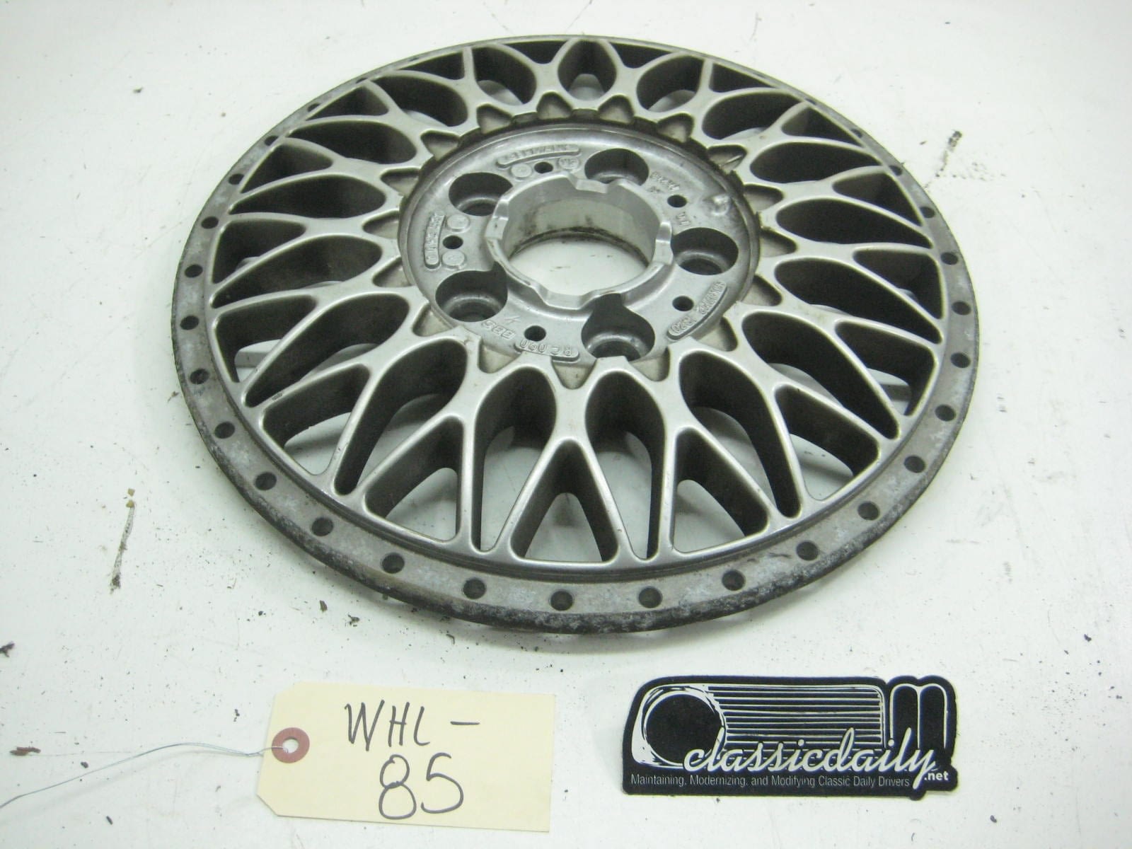

On the subject - the way that you get that desirable "dish" without a really low (or negative) offset is to have a curved wheel face. This is how you can have 3" lips on an ET20 BBS Style 5. It is a bit of an illusion, but the wheel faces are in no way flat as seen on most Style 5's and BBS RS. The spokes go inward towards the strut increasing the offset to ET20. Then the wheel lip can be larger. So the 17x8 ET20 wheel looks more like an ET0, and that "dish" that people prefer is created.
RC090 (17" 2 piece Style 5) face - not the curvature:
Look at all that "Dish". Thanks @vince:

As usual your are correct and clear with your explanations. My wheels are actually aftermarket 1993 vintage BBS RZs and not from a BMW. The attached pic shows my wheel info. My rim dish is +- 1 1/8 inch so it is substantially more than the pic bluecs sent.
Ahh yes. Yours are ET18. These wheels are 12mm further from the strut than the wheels @bluecs wants to buy, and (ET30 - ET18 = 12mm). That just happens to be about .5”. You mentioned earlier that you have about .25” (or 6mm) of clearance from the strut. What that tells us is that the ET30 wheels will not clear the struts if indeed the free space is .25”. That would mean that you only have 6mm if clearance, he needs 12mm. A 6-10mm spacer would be required.
With that said, you mentioned: “OVER 1/4”. Looks more like .5”. If the clearance is .5”, it possible the wheels will fit. But again, they aren’t the right wheels for the car and the tire will be right up on the strut.
To add a little more precision to my over 1/4” glance last night, I just measured my 205/65/15 tire clearance and it is 8mm to the strut and the rim is 16 mm.
