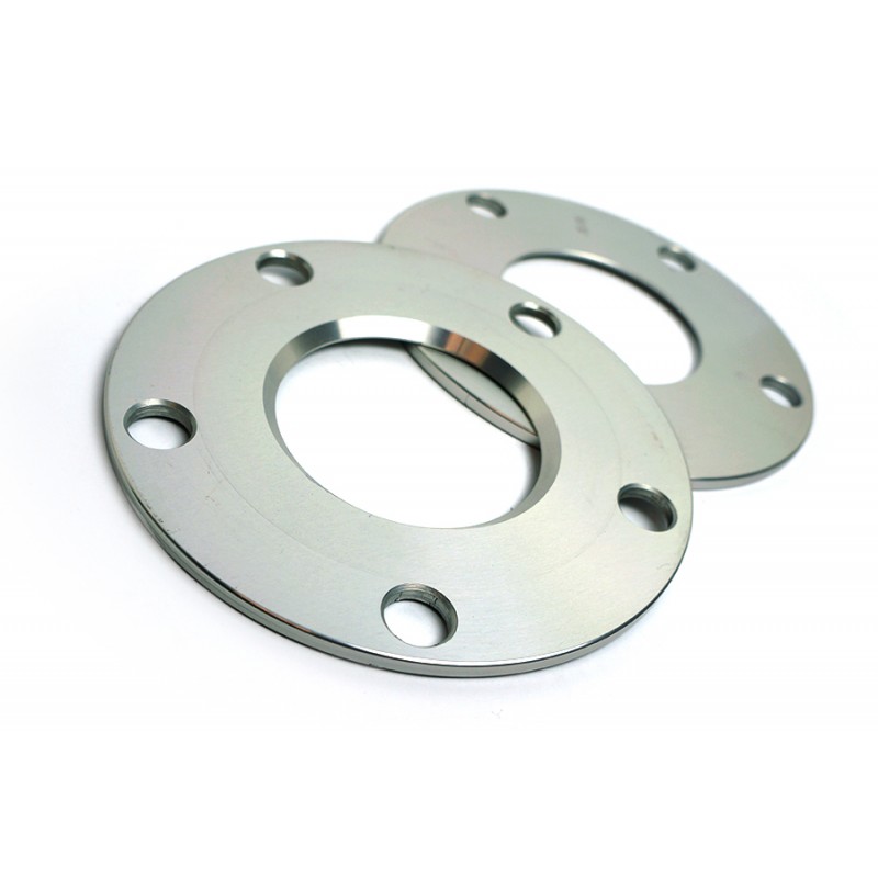

i don't fear vibrations as long you use the types with centering border.... NOT the flat ones.
And of course the right dimensions , NOT with adapter rings to center the wheel…..
I use 5mm flat cheapo spacers for the rear wheels, no problems in my case, but if you aim to have thicker spacers than that you will need hub-centric spacers, and longer studs.
i use now 12 mm hub-centric and longer studs.... mostly to keep the wheel spokes safe from the ( big ) calipers and clearance with the struts….
